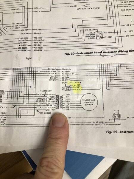

For a 1970 BBody Ignition harness connector on the column to the Instrument harness.
3 Questions folks:
1. Whats the max current on a given pin under worst case load? I assume its the red battery connection?
2. What is the current rating on the factory Molex connector?
3. Is there a source for this Molex male/female paired connector?

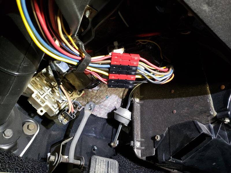

Whatever the current rating is on those Molex connectors, it wasn’t enough for that use, they all suffered heat damage. Better off replacing it with something that can handle some current. Anderson Power Poles here, 45-amp rating for the larger wire connectors.

Thanks for posting about the Anderson connectors, I have used them in the larger versions for things like winches but I didn't know they made them in smaller interlocking sizes, this is awesome. I just noticed that the make them in various colors as well.
