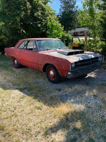

Hence the picture of the GSS I'd really love !Wayne,have I ever told ya about my lust for a 440Dart!!!!

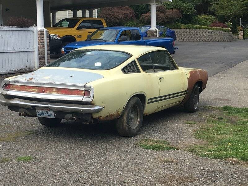

Great car, Somewhere in my very old magazines , there was an article about an A body 340 being the best balanced car. Think it was a 68 barracuda.Great looking car my friend!

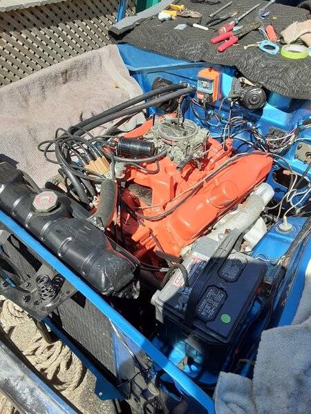

Believe you are correct. It should look like my 68 318. Oil fill cap on the passengers side front with the PCV behind it in the center and the drivers side has the breather cap in the center. Does it have the water pump exit out the drivers side and a small diameter cross over hose? 1969 was the last year for that as well I believe.Can someone confirm that I'm correct in my thinking that they have the rocker covers swapped side for side to be correct for '69. Breather should be on the drivers side.. no??? I'm also aware the breather cover is incorrect with a filler cap, believe that came in in '71..
