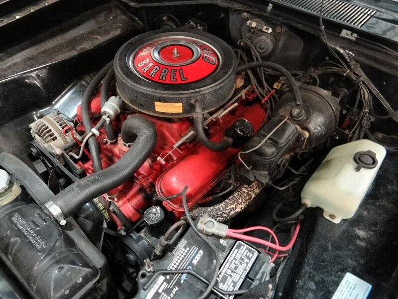

Can someone confirm that I'm correct in my thinking that they have the rocker covers swapped side for side to be correct for '69. Breather should be on the drivers side.. no??? I'm also aware the breather cover is incorrect with a filler cap, believe that came in in '71..
Definitely they are on the wrong side. Here is a picture of my original 68 340. I believe the 69 is the same except for the engine colour.
Yup that looks more like my '68 318. I actually believe they are the incorrect covers for '69, they look more like the ones on the daughters '73 engine we put in her '72 Duster. The oil filler caps in in the correct place for all years but the PCV and breather are reversed. I think they also have the later spark plug wire retainers. My '68 the wires go more over the valve covers with the clips on the valve covers where the '73 the wires more ran around the back of the heads. That is why I also asked about the water pump... the bypass hose look like the post '69 1" vs the pre '70 7/8" and the outlet to the drivers side.
At least that list is correct. Red for '68. Turq for '69

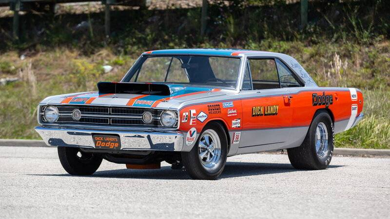

My dream A-Body is the 68 Super Stock Hemi Dart. I’ve never owned a Hemi car, but if by some means I could, I’d go for one of those real Super Stock Darts. A Dick Landy Dart would do nicely.

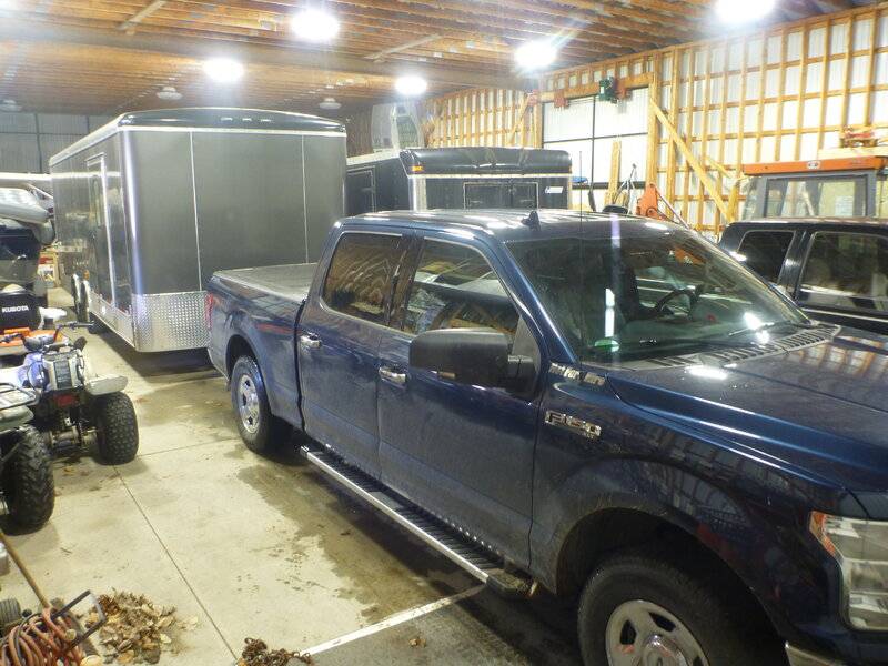

Well two miserable days in a row of highways not being suitable for a cross country and stuck here plowing wet mashed potato snow, but tomorrow is finally road trip time. I'm not waiting any longer! Ready to go at first light...
