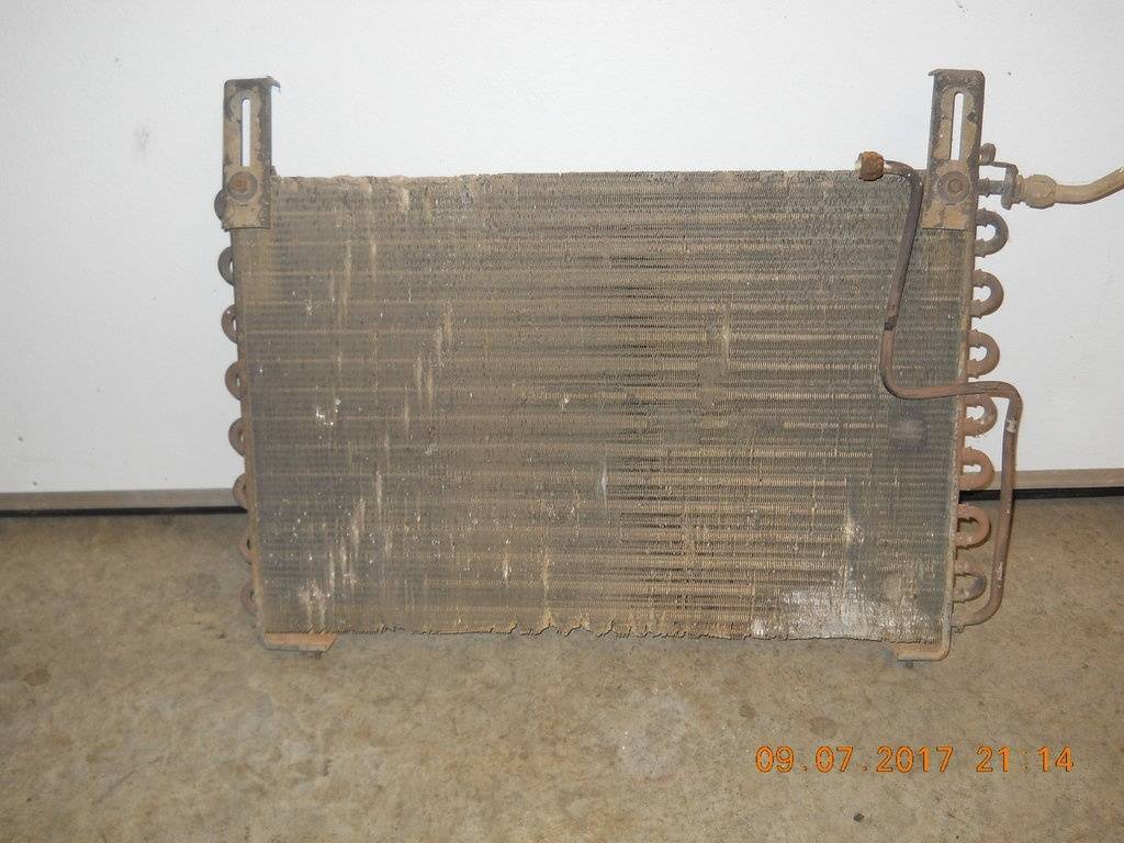

I need to be able to broaden my search for a condenser for my 71 R/T charger. There may be other models with the same A/C condenser that has the correct mount locations and the same lines entering and exiting the unit. Check out my picture and comment, Thanks

Nacho, Does yours still have the original box to where you can tell the manufacturer? Have you got a picture for me ? Im trying to keep this car original in appearance. The one that classic Auto Air makes has both line connections at the top or opposite sides. You can see my original and the placement of the lines. Part of this inquiry is to see what other cars may have the same unit. Thanks again

Wow I haven't seen that before. I will call to make sure of the fitment but the lines look right. They don't include a 71 in the cars listed that this one will work with but it looks dead on. Thanks
That one seems to be the parallel tubing kind, not like the original serpent kind

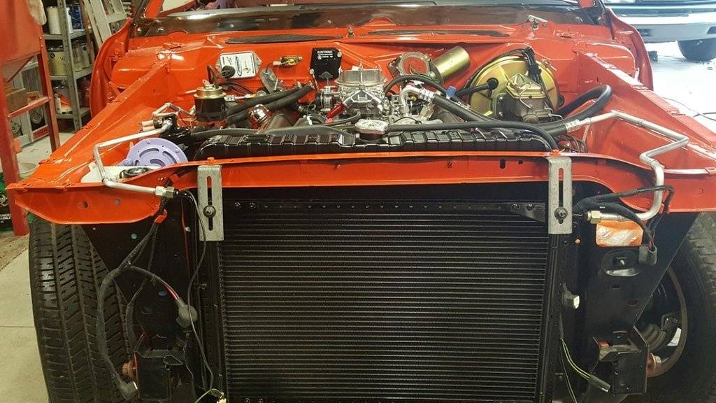

Well Nacho, it bolted right up, no mods needed compared to the one that was a "universal" fit sent to me. Least this one didn't need to be modified either by the condenser or on my car and I figured it would be hard to see the whole thing when it's in the car.
Not saying won't fit as a perfect replacement, just saying is not the original look like the OP is searching ;). Has being told the parallel tubing kind ( I think that's how it calls? ) performs better than the original serpent kind one though
