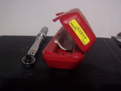

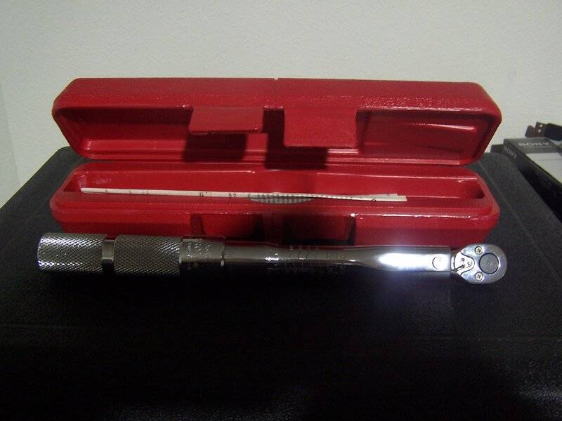

I have a brand new Proto J6064A I will ship to you for $100.00. ($75.00 + $25.00 shipping) It is a 3/8" drive with a 40-200 in/lb. The list price on them is over $250.00 but I ended up with 2 of them. This one has never been used. PM me If interested,
