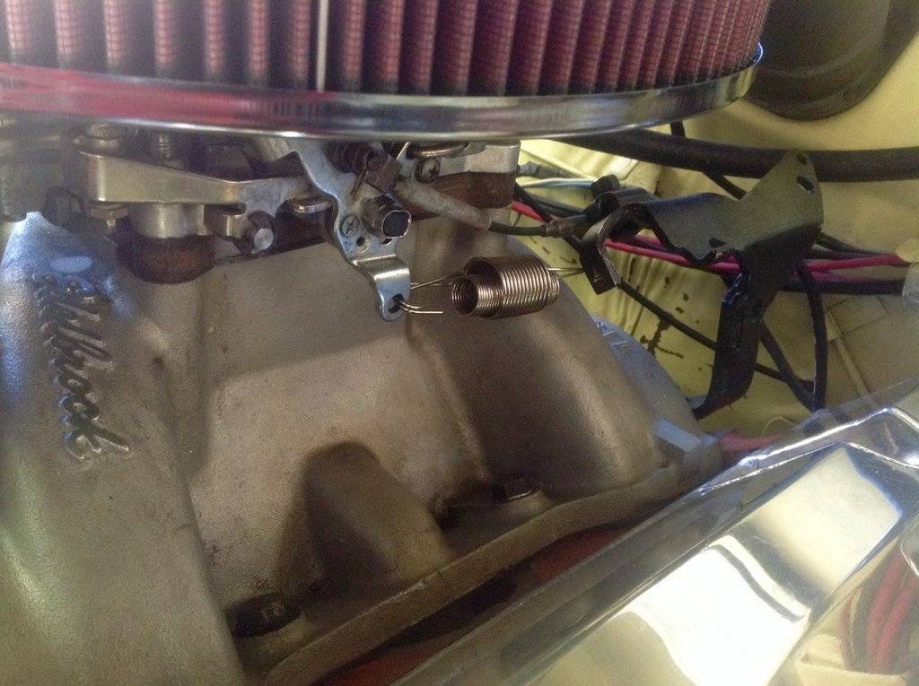

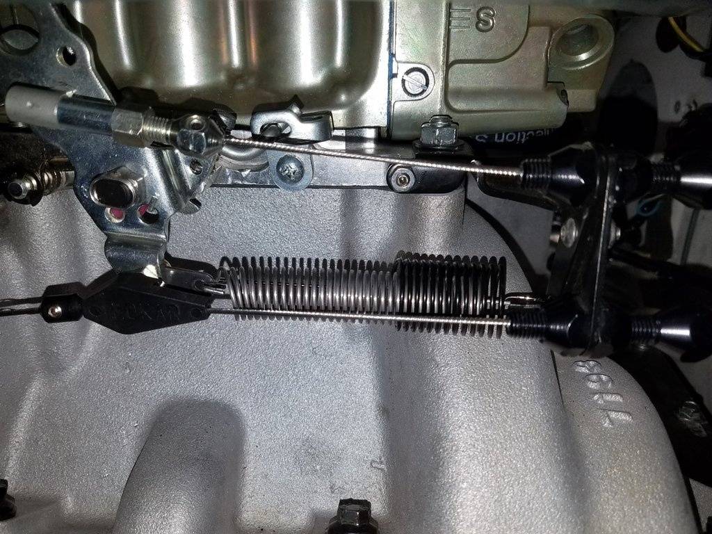

Good deal. How about a pic of that spring configuration when convenient.
The Silver Spring is one I had in my toolbox...
Thanks, I initially went with a second spring to pass tech inspection for drag racing in Reno. It snaps back nicely so was not the source of the hang up.

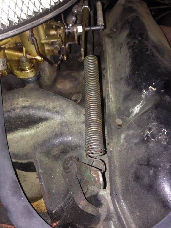

lol, OEM return spring from '68. I love these posts! It worked great on the 383 & now on the 440. I don't think these springs are the same as on firearm magazines!
