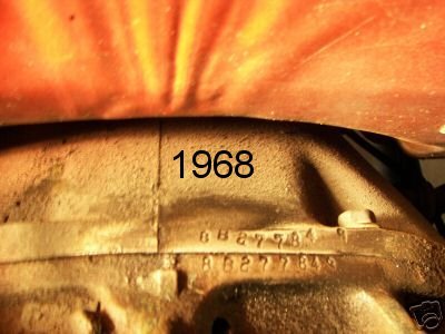

Look at the pad first for the HP stamping.
No HP = not original.
HP= then look for the VIN.
It takes some looking but the VIN shouldn't be that hard to find.
I looked everywhere even on the tranny ( automatic ) no vin numbers.. I know all the past owners and they said no engine swaps where ever done. This car has only22k miles. No HP on block by dist. Is there any possibility that info on build sheet would tie the engine to the body. Or numbers on tranny be the same numbers on the engine. Was the HP prefix being used on 1967 blocks. I just want to prove or dis prove that this engine is original . Is there something on an engine that would show it might be a dealer replacement engine. Thanks
With no HP on the pad and no VIN on the rear of the block on an April built car says no way it's original. Must have been swapped early on...
