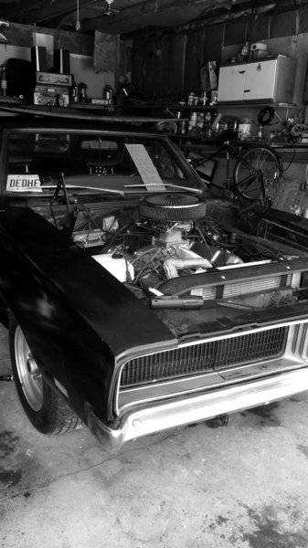

Sorry guys I've been busy turning wrenches at work and also on the charger. Let me give an update on what the build is as far as I know.
Now a holley 4150 830cfm double pumper
one inch phenolic spacer
victor 440 manifold
stock heads
mopar purple shaft cam (not sure which one but hydraulic for sure)
unknown bottom end
msd pro biillet dizzy with msd 6a box
unknown long tube headers.
Definitely never selling this car.
Pics coming soon
So now the question is with 11 to 1 compression ( I was told) and iron heads how much timing should i run.. base and total? Want it to be very safe, performance is second after durability.

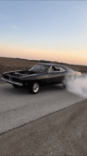

didnt sell the car guys its running better than ever holley 830 double pumper new polished water pump housing arp bolts in tq converter and alternator and water pump housing new belt new coolant new oil burning rubber
Hey young blood - very happy to see you still on the forum. That’s one nasty looking Charger you have there. Honor your dad and make it the best you can. Glad you’re part of FBBO
