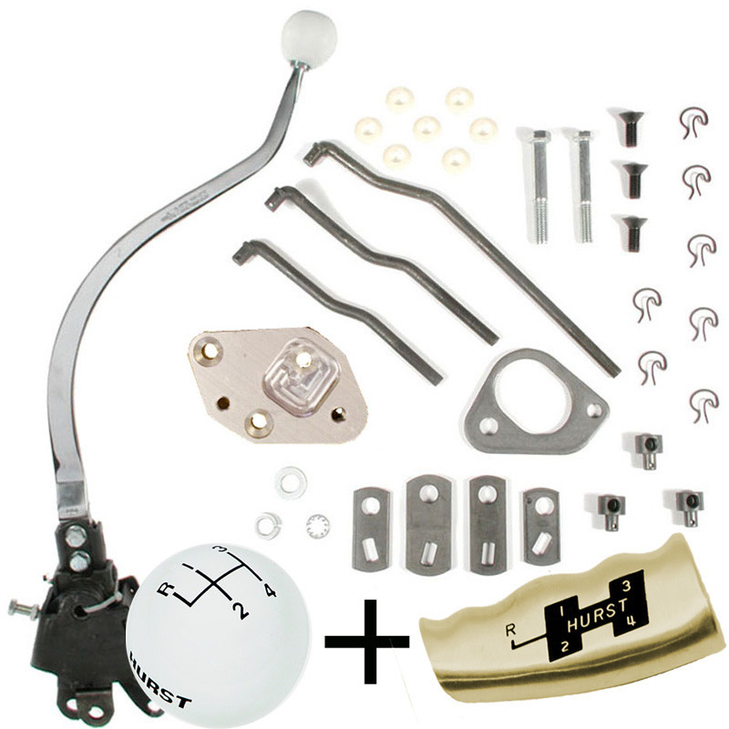

guess its a hurst .. its sloppy in gear its like a row boat ..just bought it and guy said he was told it needs bushing.. I think needs a new shifter ..seen the hurst for $219.
You can have your rebuilt or just buy a refurbished 1 from Brewers in Ohio. I'm having mine rebuilt soon
Here's a DIY kit...
