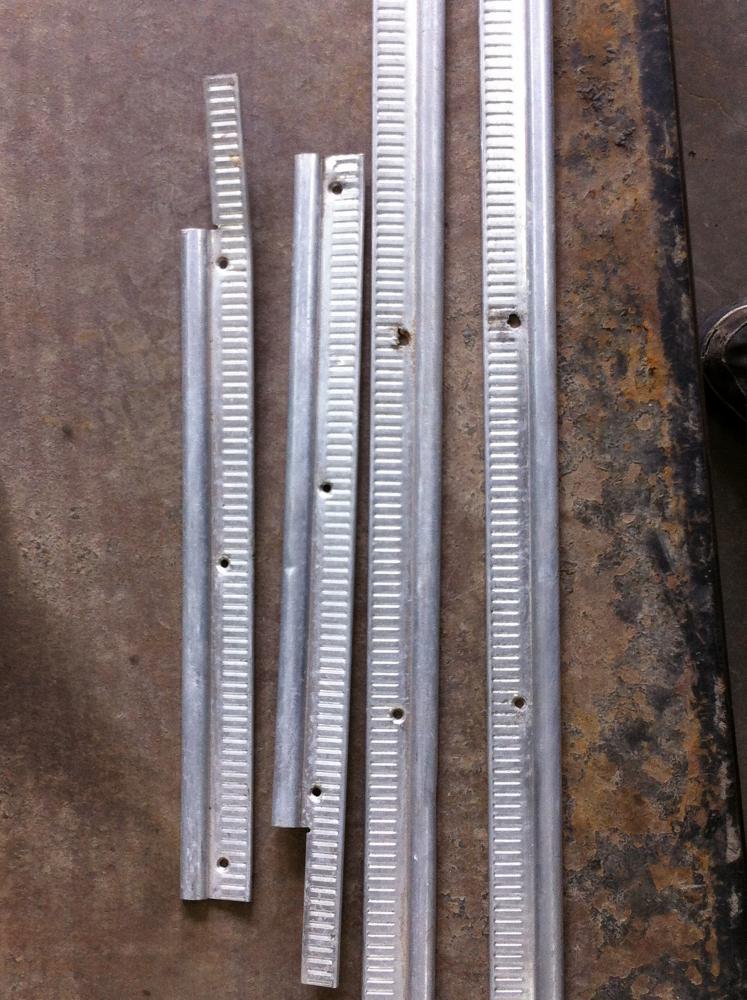

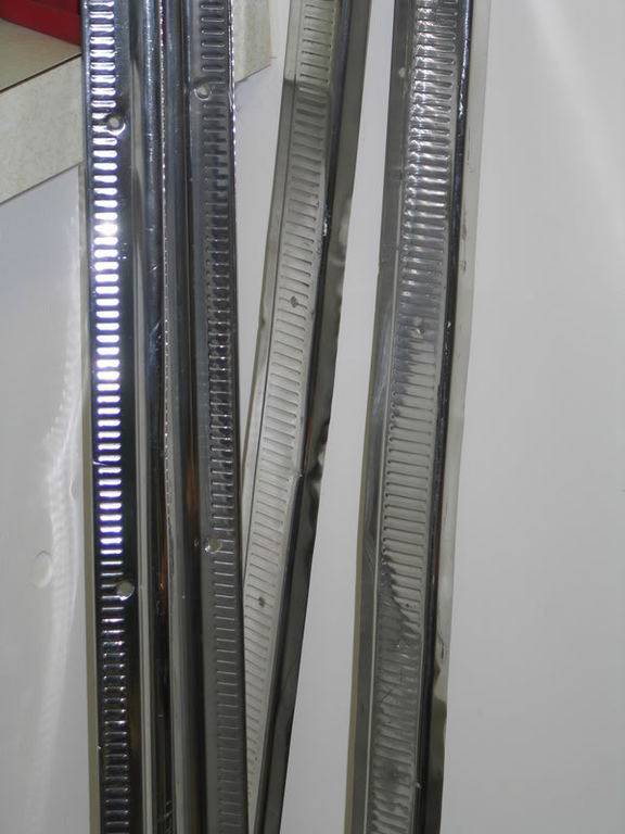

Been trying to polish these up and not having much luck.
Any suggestions would be helpful....thanks.

New is always the best, but if you have a buffing wheel get some 124 compound and try that, this is what it did for mine, if that would be close enough to do it.. Honestly there more shiny standing by the car then the picture, but this will give you a fair idea what it would do..

Yeah they are expensive for what you get....I was polishing them on a buffer wheel and found the compound kept getting stuck in the grooves making them look worse.
I'm guessing they are stamped aluminum?
I used Flitz aluminum polish on mine and they came out really good. I'll post a pic later but that particular polish really cuts through the crud.

Try using a Dremel with a small buffing wheel attachment to clean out the really tight spots ... it works great.

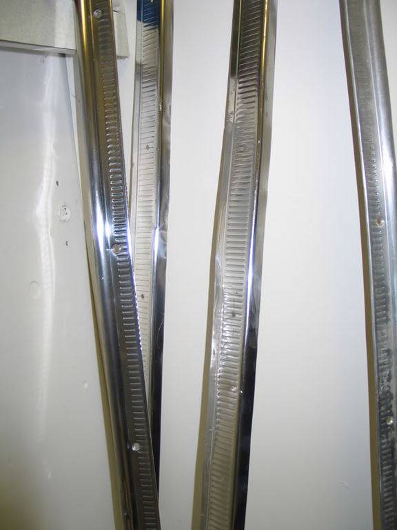

Here is my before:

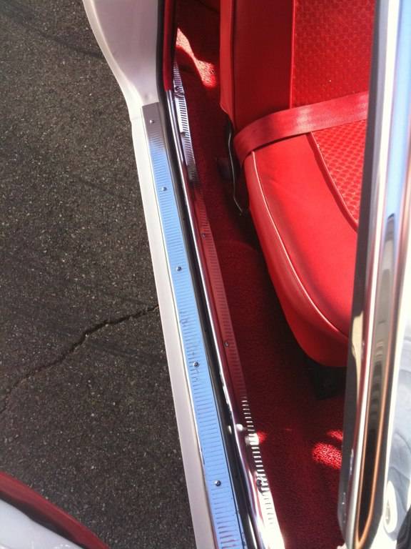

and after... not perfect but decent overall:
It took quite a few applications of Flitz on each piece after getting the dents and bends out. You have to keep polishing with new coats and clean rags until the release of the ugly black stuff goes mostly away. If you only do a couple passes all that gunk is still in there, and if you use a blackened rag it just gets pushed back int.

Screw that, I just painted mine black. They were so beat, I couldn't justify the time to polish mine to almost new condition and the thought of 300 bucks for new ones made my wallet shut tight!!
Mine aren't that far gone and black or any other colour other than shiny just wouldn't look right.....so it's gonna be me and a polishing wheel.

They turned out quite nicely. Even if you end up getting new ones down the road, these look very presentable for now.
I orderd Flitz,im hopeing mine turn out shinny as well.They are in great shape just dull
