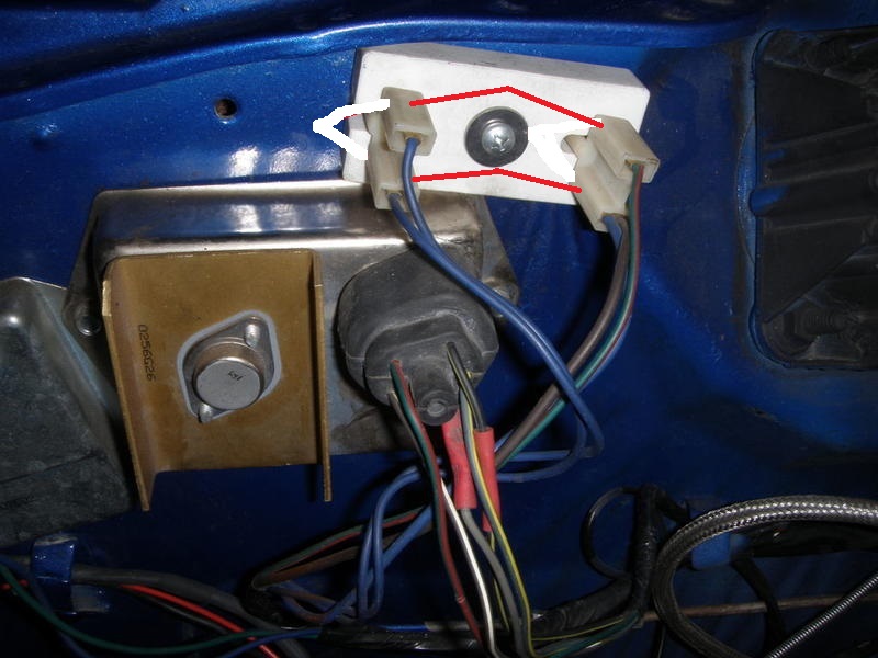

Hello
To the ballast resistor be bridged for the RTR as distributor?
Ignition box is dropped Yes.
See photo.
Has anybody installed this Distributor, and has a plan for me?
regards+thanks
Franz
Yes bus it through. What new box are you using now?
Just installed a Fire Core myself. It's of the "capacitive discharge" type so lose the ballast. You will notice that there's only three wires to connect. Sweet! If you mate it to an MSD SS coil which is fully electronic you'll never feel a stumble at higher than normal r.p.m.'s.
