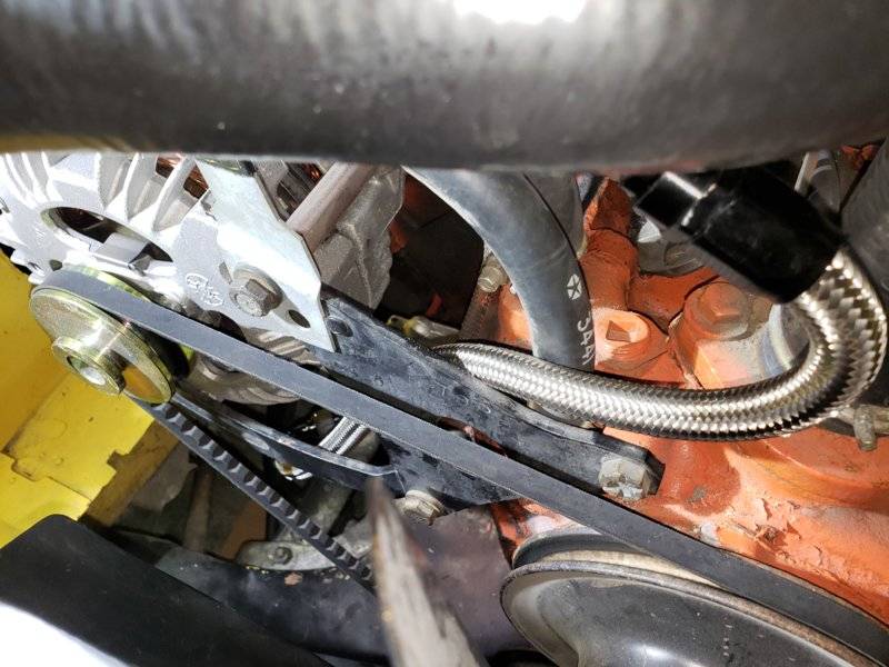

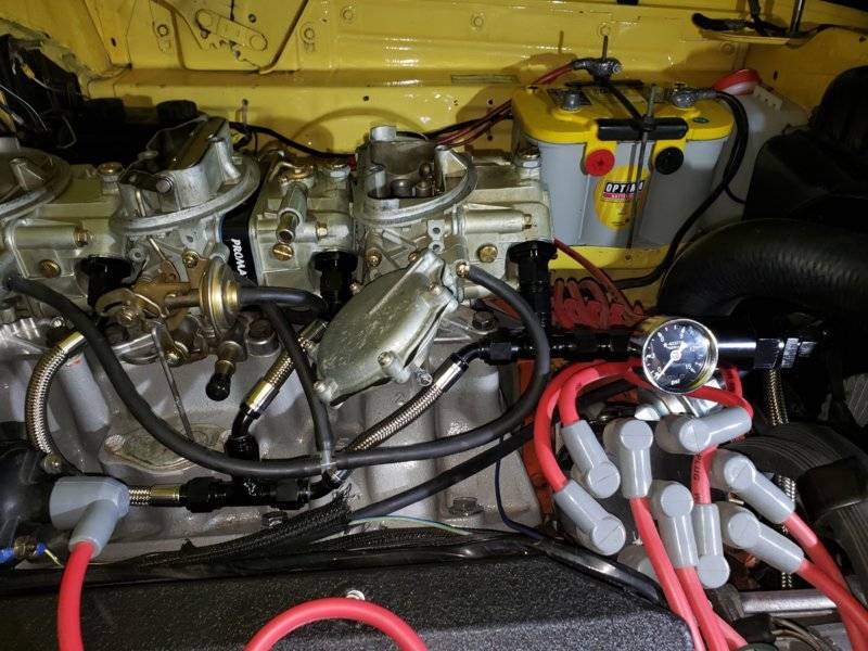

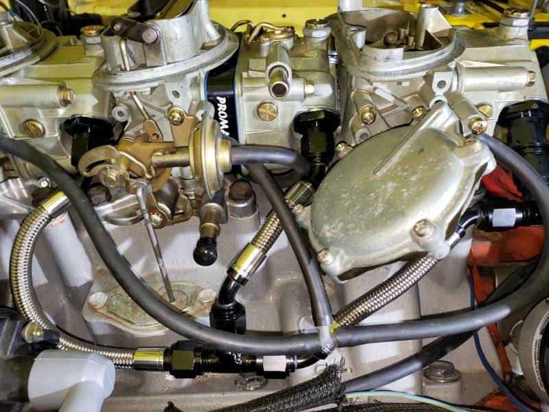

Installed Promax modded Holleys, 6 pack fuel lines and Carter M6903 mech fuel pump
About to fire it up and check for leaks, but my bet is ZERO leaks!
The Promax AN -6 fittings and flexible stainless braided fuel lines are GREAT!
Took some reconfiguration of fuel fittings and line angles to clear everything.

The rear carb ONLY apparently has a stuck float, fuel fountaining out of the bowl vent.
Grrrrrrrrr....
I removed the sight plug, let the excess fuel come out, adjusted the fuel bowl nut.
Did that 2 or 3 times, no good.
They ran the carbs before they shipped them. I'm thinking loose needle in seat? Something in shipping? They were very well packed.
Looks like I may have to remove the rear carb, pull the fuel bowl and have a peek.
Any ideas before I do that?

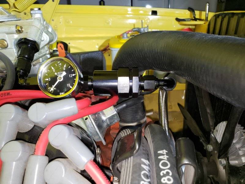

What kind of pressure is that fuel pump rated for? Might need a regulator. I don't trust those little fuel pressure gauges. Had one that read 3 psi low. Was changing needles and seats out on an 8 barrel tunnel ram set up. This one then that one...then I checked the gauge against a good gauge. Off by 3 psi.
Stock pressure, high volume. The Carter M6903 is the "established go to" mechanical fuel pump upgrade and the same one :lowdown: Bob Karakashian aka "Mr 6 pack" runs. Besides, only ONE carb is having float issues.

I’m not a fan of “dead head” fuel systems, especially on a street driven car.
I’d plumb the system with a bypass regulator and a return line.
I agree that those little fuel pressure gauges are problematic.
I already have a return line-the factory return line. Fuel pressure from the Carter M6903 is a non-issue. The problem was a stuck needle and seat apparently.
How do you configure a "system with a bypass regulator" and will that work with my existing return line?
