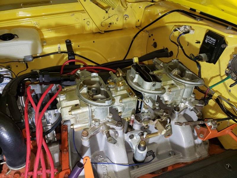

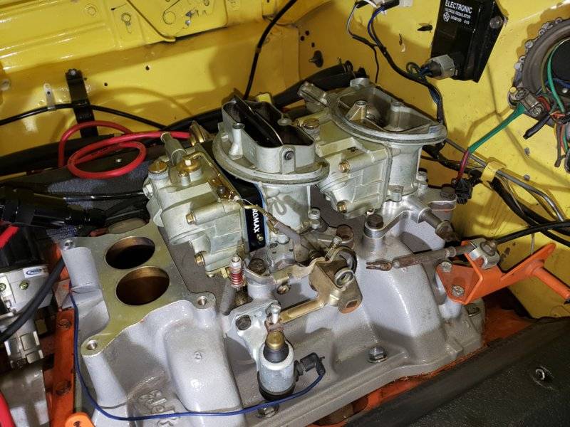

Installed Promax modded Holleys, 6 pack fuel lines and Carter M6903 mech fuel pump
biomedtechguy
Accelerati Rapidus Maximus
8:00 PM
Mar 28, 2014
33,795
53,669
South Louisiana
70 Roadrunner, V-code, 3/8ths" fuel line.
Current setup is hard fuel line from tank to 3/8ths rubber to fuel filter to 3/8ths rubber to hard line into fuel pump. Hard line out of pump to rubber line into vapor separator. Rubber return line from vapor separator back to tank. Rubber line to hard line to carb lines.
The Promax lower fuel line is designed to attach directly into the fuel pump. It incorporates a 40 micron fuel filter. That assembly attaches to the Promax carb lines.
?? If I bypass my vapor separator (remove it) what do I do with the return line? Plug it?
Also should I be able to eliminate the inline fuel filter before the fuel pump since the Promax lower fuel line has a 40 micron inline reusable fuel filter?
Also changing out fuel pump to the
:lowdown:Carter M6903
Any tricks to that other than 2 bolts?

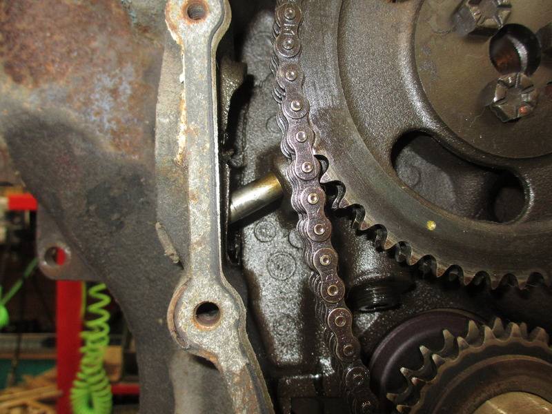

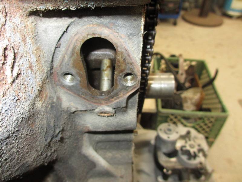

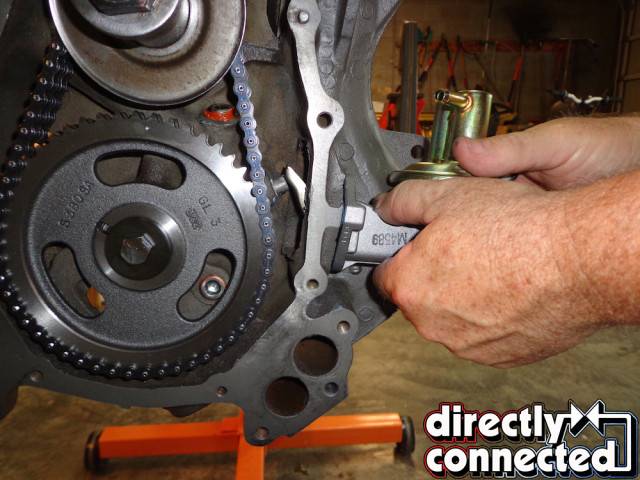

When you remove the pump, most likely the actuator rod is going to drop down. There is plug in the block that takes a 5/16" allen key. Remove the plug, place the rod above the pump lever and install pump. Replace allen plug and tighten.
:thumbsup::lowdown::lowdown::lowdown:Ironbuilt:thankyou:
Thanks for ALL of the replies!
Special thanks to Ironbuilt because of the picture. The "fuel pump rod" was a mysterious item I had only heard of, but never saw. The pic was a big help.

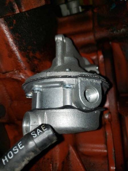

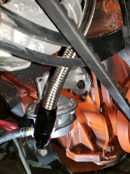

Fuel pump changed. I was blessed, pushrod stayed back, so I was able to angle the pump lever under the end of the rod, tighten the 2 bolts (easier w/Carter because there is more room for the socket to fit on the rear bolt head) and bam! Done. Now on to the fuel lines, carbs installed, linkage.....

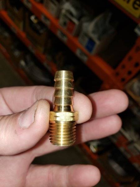

Old fuel pump had a male nipple the rubber line slipped over. Carter pump has female 1/4?" threaded inlet, so Home Depot to the rescue!
