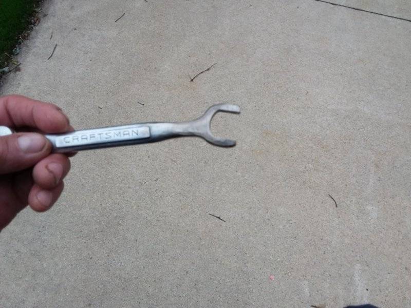

Make one of these with your grinder, works like a charm.
Make one of these with your grinder, works like a charm.View attachment 658063
That looks like a crescent wrench to work on the fuel fitting that goes into the float bowl, right?
Right now I have been using an adjustable crescent wrench.
What size should I start with to get what you have in the picture?

You don’t need and special tools, tighten the rear with the carb loose or off and use the bottom tee to seperate any time you gotta pull the carb
Yeah, that's pretty much what I did.

That tool is mainly for disassembly on a stock setup to hold the inlet nut while you break free the fuel line with a flair nut wrench.
If you find a better way to hold it let me know.
That's a sweet setup you have, good luck with it.
That makes sense. Dealing with those fittings on the stock fuel lines was always a challenge.
