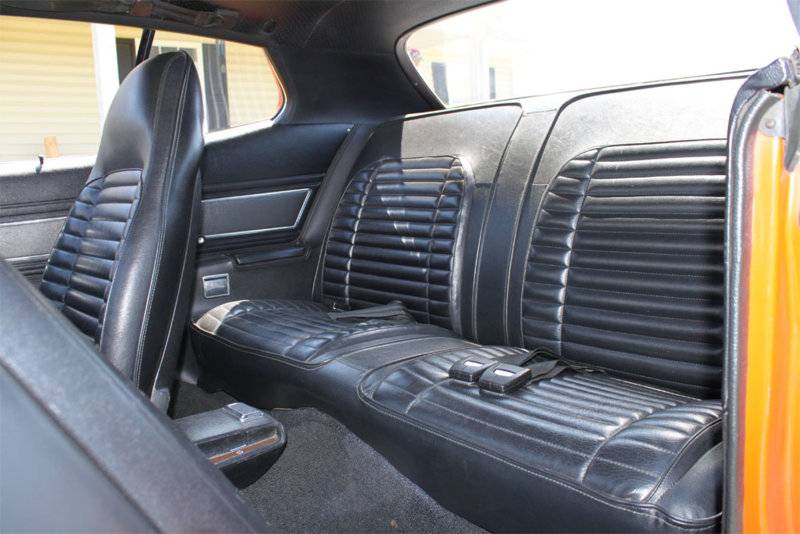

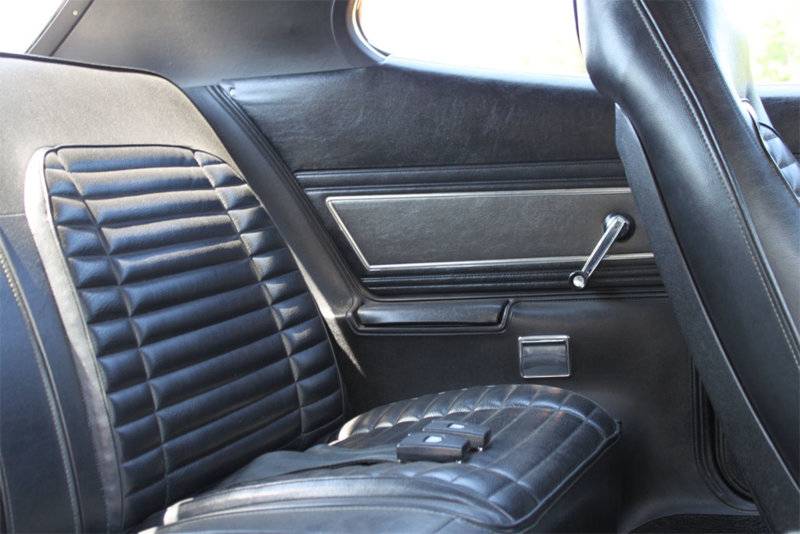

They cover the headliner but go under the trim and upper trim panel. Best pics I have. :welcome:

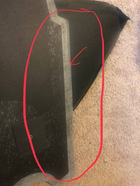

Okay but my concern is the upper flap that goes on top and meets the headliner. is this suppose to be glued to the headliner or cut off?

I can't tell you how to make it work!!! never have had them in hands, but I know from the distance they don't work! will leave a HUGE gap around the glass, where the weatherstrip should be attached
They just could work if you still have in hands the old panel and cut the curved area what folds against the glass attaching it to that panel you got!

Nacho, the cloth panels use a metal banana-shaped piece that bridges the gap. You are supposed to reuse your originals. I do not know what controlled which cars got the full vinyl panels vs. the cloth panels.
It's possible you could use the metal pieces from a 71-72 plymouth. I have a set of each but haven't compared the shape. I know the 73-74 Charger pieces are thicker with a slightly different grain pattern but the curve seemed very close.
It's hard to tell from the pics in the link but I think there may be a metal trim on the passenger side where the cloth panel isn't fitting up to it properly. If so, it's also possible that the cloth sail panels are the same part for both 71/72 plymouth and 73/74 Charger (using the same shape but different grain), causing the issue. You could trim them to fit but that might leave you short on the glass end. I wish I saved my old ones for a pattern now.
I'm looking at Classic's website. Basically they have one board for 71-74 plymouth and another 71-74 Charger. Obviously we know that isn't right but it's possible that the plymouth boards would be a better fit in a 73/74 Charger. I'm at a loss to think of what the Charger boards would actually fit - they can't possibly fit 71/72 or 72 SE, and if they don't fit 73/74 then they are just useless.
