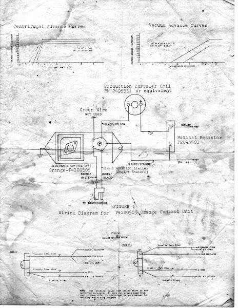

I wanted to put this up for reference.
This is a copy of the original instructions I received with the kit I purchased in the 1980's
Direct Connection DCF-017
Revision F Dated November, 1981
Instructions for Chrysler Performance Parts Packages
Electroninc ignition conversions
P3690426
P3690427
P3690428
P3690789

Anyways , for the most part they want your FACTORY Part # 1.4 - 1.6 OHM Ignition Coil along with the FACTORY .5 OHM Ballast Resistor
Plug Gaps @ .035
Then in notes toward the bottom they talk for even more hotter spark throw the garbage can size Accel Super Coil .7 OHM Primary Resistance and their matching .85 OHM Ballast Resistor
