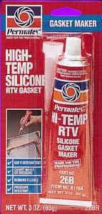

This is what i use for a sealer
I also put some in the seams between the block and the heads.

Don't forget too, also coat the intake bolts with a high temp silicone to keep oil from migrating up the bolts and seeping onto the intake.
