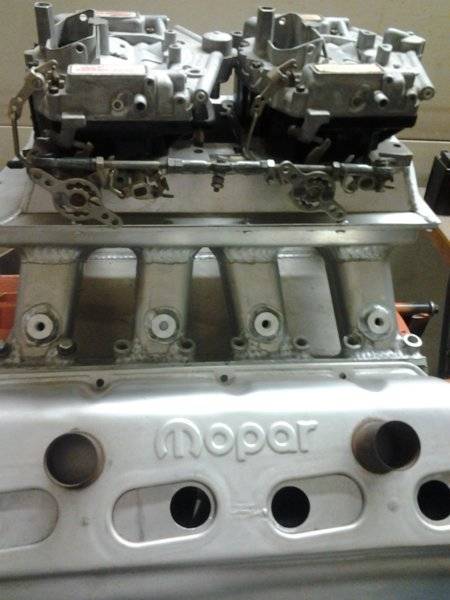

It matters a lot if you're trying to make more than average power. The intake manifold is often a cork in the system since most people just buy an intake and bolt it on. I started to use Wilson ported intake manifolds a few years back and they really make a big difference. Costs a bunch of money but for someone who is serious about racing the price isn't out of line. Besides, the resell value is pretty good on Wilson intakes since people know how good they are.
