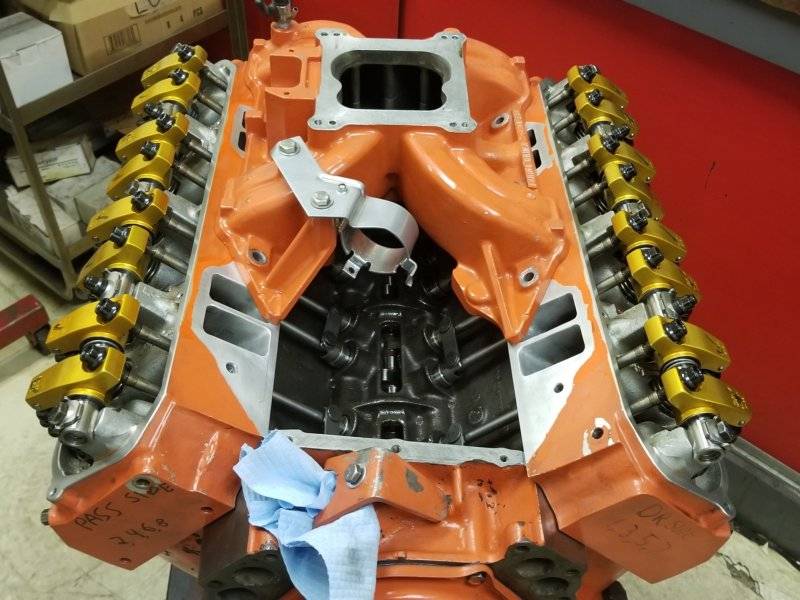

You should get information first before you decide what you are going to do.
Set the manifold on the engine dry, with no gaskets or valley pan, but offset, like the picture below. Get the intake well centered and then measure with a feeler gauge to see how parallel the head and intake manifold surfaces are. If they are off by less than a few thousandths, I'd suggest to use the valley pan only with sealant, as suggested by @493 Mike
I recently installed mine with the Fel Pro pan and a pair of the paper gaskets. I have aluminum heads and they have been surfaced.
I used Hylomar to glue the paper gaskets to the heads by smearing a thin layer on the head sealing surface. Then smeared another thin layer on the paper gasket to seal it to the pan gasket.
Dry fit it first to see if the intake bolts go in without issue. I don't think I have ever used both sets of paper gaskets as it gets too thick.
