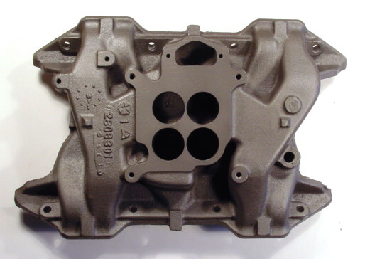

P/N #2806301 {1968 and 1969} '383' Casting.
An easy to find Cast Iron Intake.
I just picked one up for $40 from the Auto Salvage Yard. This Intake Manifold
was found on every 1968 and 1969 {383 4-Barrel Mopar}.
1 11/16" x 1 11/16" Throttle-Bore sizes, and fits both the AFB and AVS.
Worth an easy {+10 Horsepower} over the early style 383 Intake {p/n #2205968}
Found one. You have all given me insight and options. I will now pursue this.
More to come......
Underside of #2806301
The {1968 and 1969} 383 Intake is rated as the 'best' stock Cast Iron Intake by far.

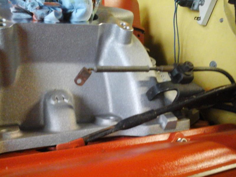

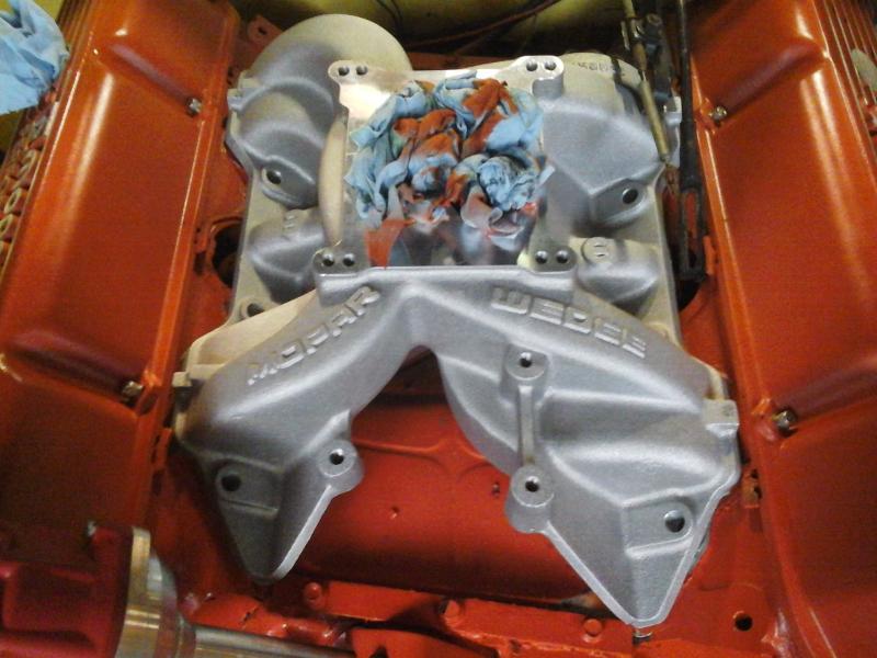

20140812_193352.jpg20140812_193414.jpgUps just dropped off my Intake and valley pan today,, I went with mopar ,wedge intake 440 and the vally pan that blocks off the heat holes,, I didnt even think about my A/C, till I r e ad this post,, and what about the throttle cable and tranny kick down ?,, heres what it looks like just setting on her,
I have modified the throttle brackets before. Not usually a huge deal. But there are several aftermarket brackets out there if you do need to change. The throttle cable length could be an issue. My car was originally a 2-V car, so eventually I will have to cough up that $100 to change my cable. But of course, with the heat problem I am dealing with, the throttle cable is working just fine.
That intake is sexy! I like it! My brackets would never clear those runners.
I took befor pictures ,, my AC is a after market unit, and is smaller .looks like it mite work , dont real know yet .the vally pan does cover the cross over ports but darn counldnt they cover them ugly holes in the heads,,Wher do I look for a throttle bracket? Ebay? Heck what am I looking for?
