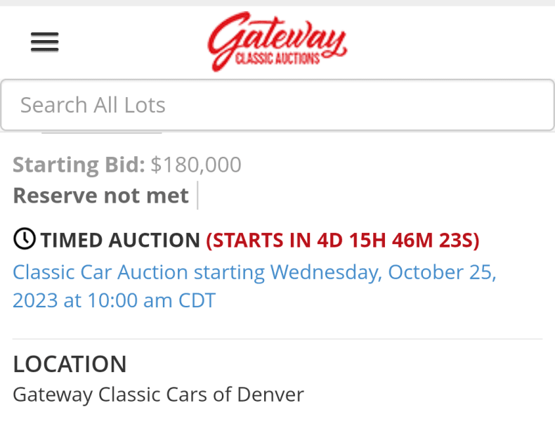

$180,000 starting bid
Reserve not met

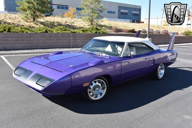

What a turd. If the rest of the vehicle looks as good as this what a jewel!
Only $180K??? What a bargain for the only G code Plum Crazy Hemi Superbird...

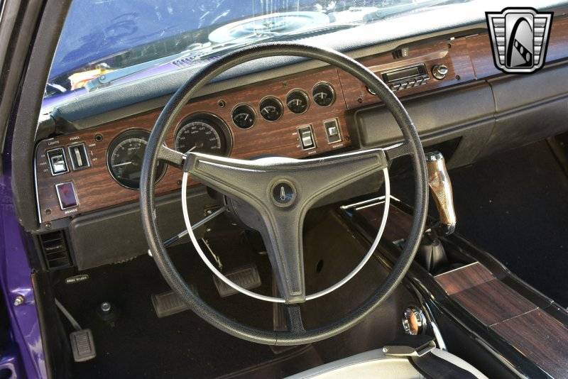

The dash paint shows what an exemplary quality resto it is...
I love winged cars (from day 1)
I love the 426 HEMI
I love 4 speeds.

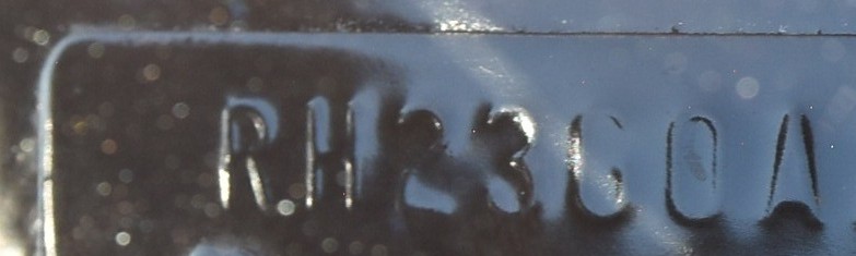

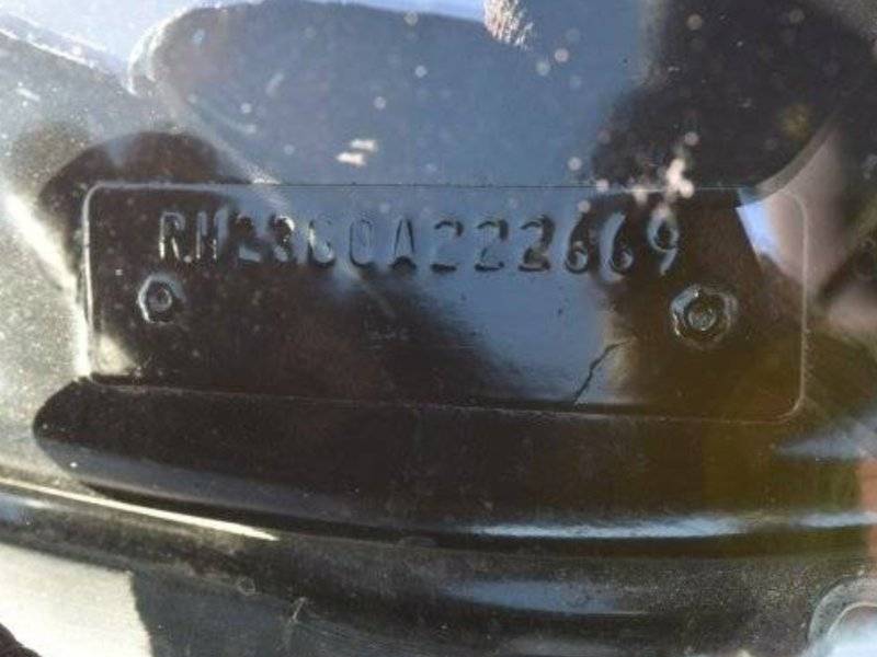

That second digit “price class” has to be an “H”. The fifth digit “G” is the 318. All RM Belvederes had the 383 “N” standard.

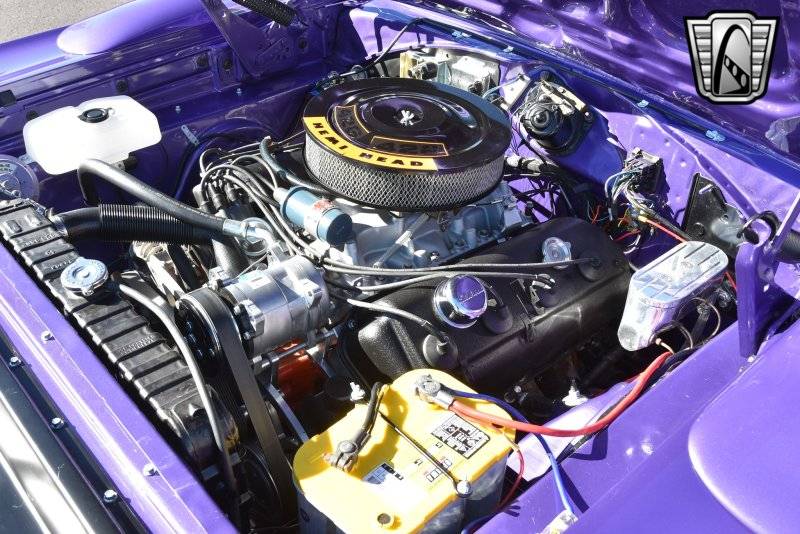

Not a bad core to start with maybe. Interesting how they made the rare 70-71 valvecovers work on the wrong sides. Half price would allow you to make it into something cool.
Thank you for pointing that out. I edited my post accordingly.
Superbirds could be “U”, “V”, or “R”, as a Belvedere medium price class. But the 222669 sequence # is out of the time frame for a Superbird build. They all had to be assembled before January 1, 1970 because of a federal front bumper regulation.

What's with the wiring at the positive battery terminal and what in the world is going on with that wiring on the firewall?
