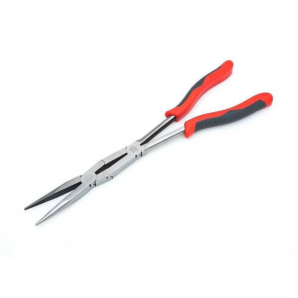

I love my long compound-joint needle nose pliers for that job.

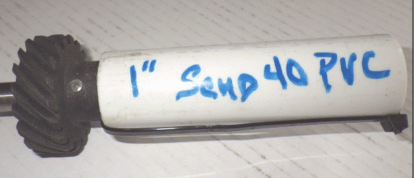

This has worked for me in the past. YMMV. The zip tie added some hold tension for this one ................

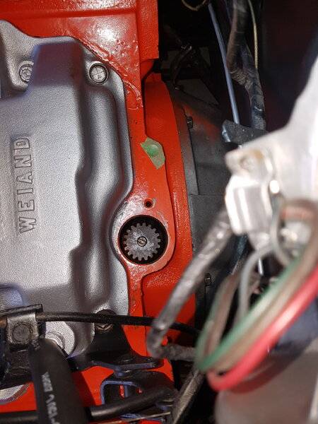

Is the motor in the car or on a stand?
That is a great tool! Thanks for sharing.
Every spring I remove this shaft and prime the oil pump with a drill. I don’t believe in cranking the starter with coil wore off to get oil pressure is helping save wear on the engine at all.
Hopefully yours comes out and isn't stuck in there.
