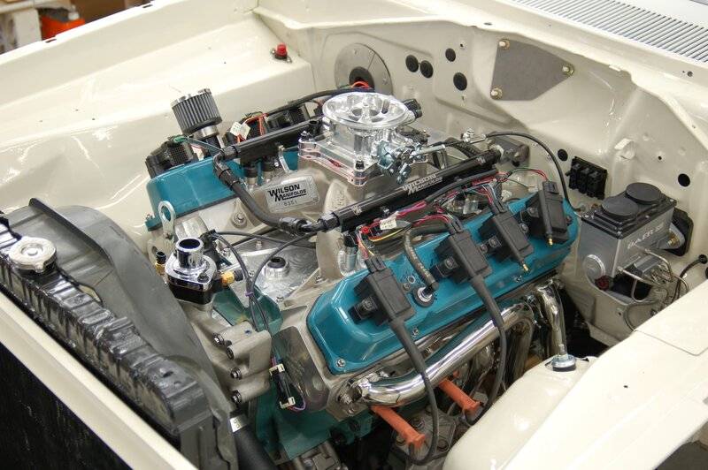

Hey andyf, What is it you have going on there? What car, engine, specs, and cost if you care to share it with us. Looks like a great build.Something like this.
