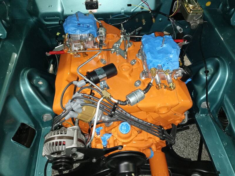

Thank you very much for the information!! That is exactly what I am looking for my 62 Savoy.

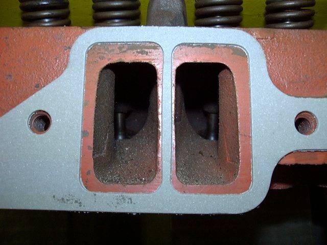

Here's a pic of the port difference, MW gasket on standard ports.
