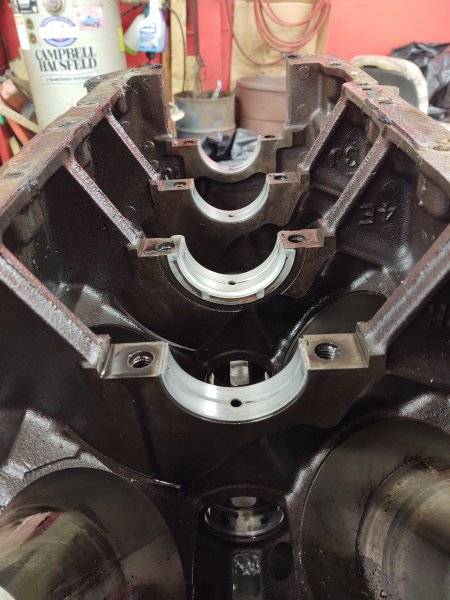

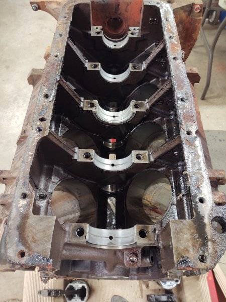

Mains are also.010 under... unfortunately no dates on the bearings.

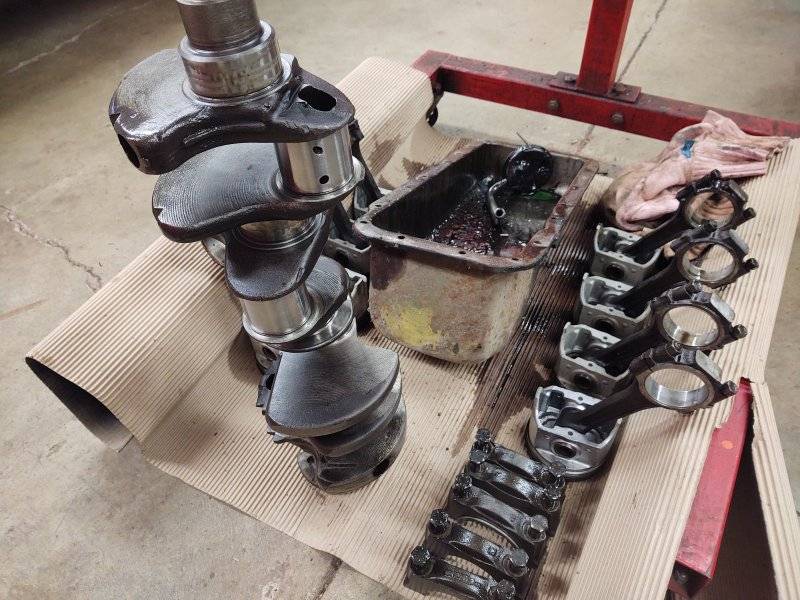

This concludes the tear down of this engine...it now goes into the core pile for future projects.
Questions?
Thanks for following along!

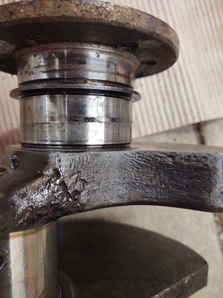

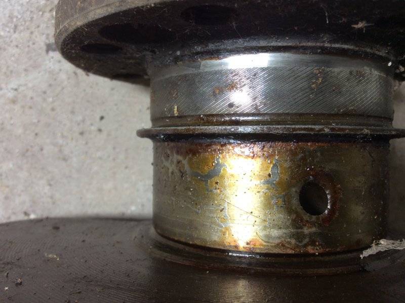

Are there //// on oil seal surface? Are the //// angled in the same direction as car cranks?
Double checked a car crank...this engine is normal rotation.

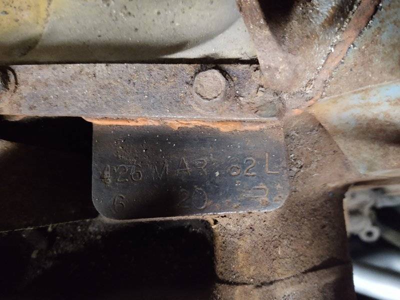

I have never seen a reverse rotation industrial engine except in boats. Here is a pic of the normal stamping on a reverse rotation 426 industrial boat engine

To date I've never had a 8 bolt long crank come out of a industrial engine.... however all the ones I've had have been 1965 and newer. I think 1961 was the end of the long cranks with the end of the cast iron torque flight.
Top picture industrial crank bottom picture 426 car crank. Both pictures flywheel flange to the top of photo. Both have///// same direction. I'll give myself a :thumbsup::lol:. The Dutchrebuild crank picture you need click on attachment. My car is the visible photo.
