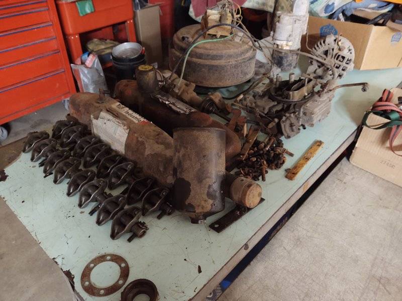

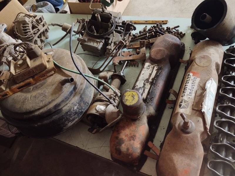

Probably because of the governor.
Thats correct. Holley was pretty popular and worked hand in hand with that style carburetor. Distributor would control the carb. Once the distributor hit the governed setting it would pull a diaphragm in the carb and you would have no more throttle.
Infact there was a pipe from the water pump housing to the heat crossover
There might be someone out there that might want the stuff you are putting into the 'scrap' pile. I know if I had pulled that engine apart 40 years ago, it would have gone to the scrap pile too but it surprises me what people are looking for but on the other hand, these days not so much.
Those heads sure would have been easier to build headers rather than the standard B/RB style ports.
You may consider bunching up that industrial stuff and donating or selling it. Governed engine stuff is hard to find. I’ve worked on Ford gas burners and it was unreal. I don’t know any sites to help move that kind of stuff though. Old fire trucks still use those in some areas. Just trying to help.
Man, I hate junking anything Mopar. I will be keeping the stuff on the table.
Everything on the floor is getting scrapped. If anyone knows anyone that wants anything from the scrap pile it's free...but I'm not shipping any of it. Come get it.
I'm not done with disassembly yet so both the piles will grow
No adjustable rockers,darn.

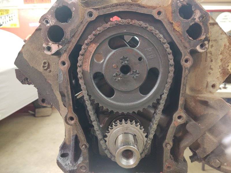

Typical of a RB Industrial Engine is the 3 bolt cam and double row timing chain

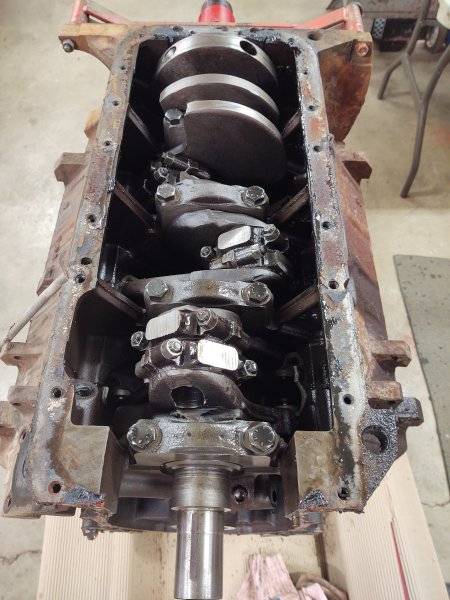

Typical steel crank bottom end with no windege tray, LY rods, and standard size oil pickup
Nice the crank doesn't have those big "ears" on the throws like the earlier car 413's do.

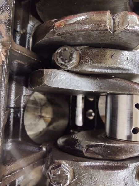

Ya... right... typical **** attention to detail by Chrysler. This crank looks awesome...so far...rods at .010 under but crank not stamped
Not uncommon on a regrind. I wish they all did though.
