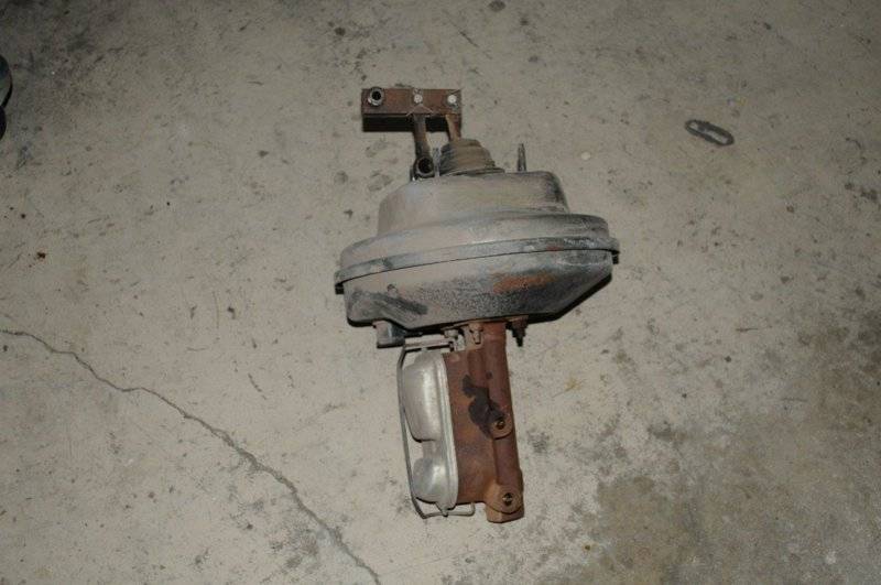

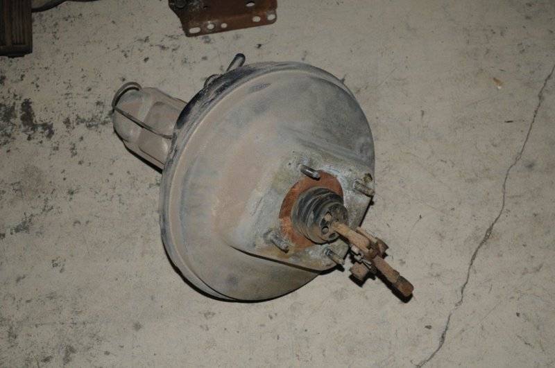

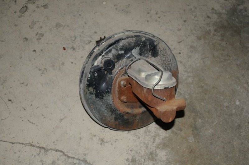

Goober beat my inner fender to make room for this thing. I think I'm going to have to round file this thing unless it's a Mopar piece. See pics

Yeah, looks like the setup on my 77 Power Wagon.
IMO...
IF there is a circumferential clamp band, holding the diaphragm halves together, it MAY BE a Midland-Ross unit. These were usually a yellow zinc dichromate colored. Used on various models 69-73 (?) years....not 100% sure.
BOB RENTON
No clamp band, it's headed to the round file... Thanks for the help folks.
