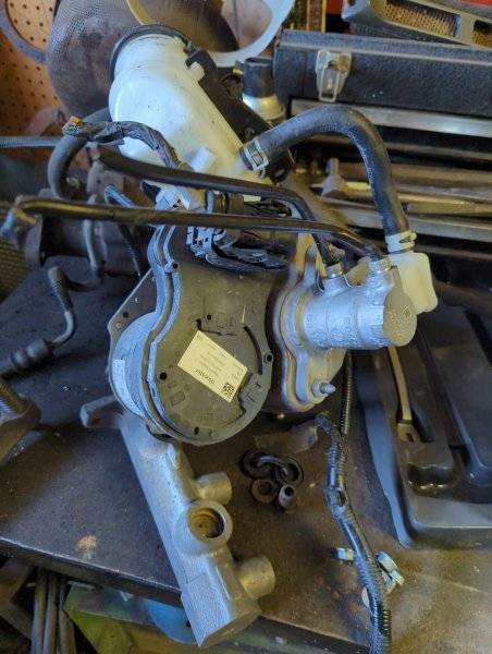

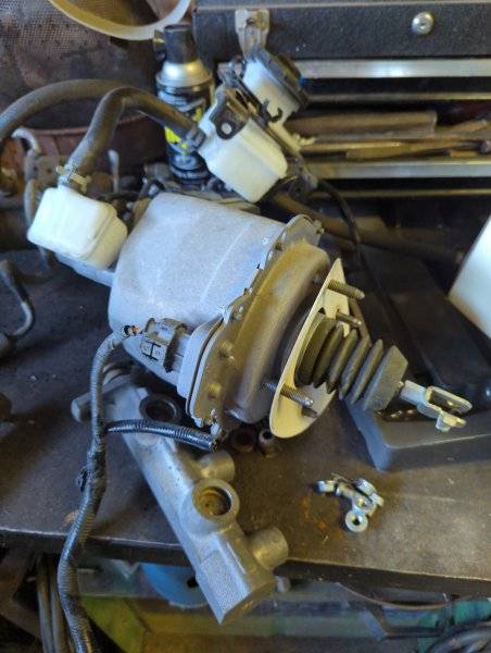

Has anyone thought of adding an electric booster to thier mopar brake systems? I saw a guy on youtube did one using an Iboost from a honda accord which he claims is the same one used on Teslas. It didn't look like that hard of a swap. Maybe it's a stupid idea on a mopar but has anyone else thought it at least sounded good?

Think that swap has potential because space around master. Looks better than the crap @Kern Dog went through with hydro-boost.
He did have to do a little fab on the brake pedal but that was a Ford.
And then there’s the bolt pattern and the firewall opening
I’ve seen them on eBay 300-800 bucks.
