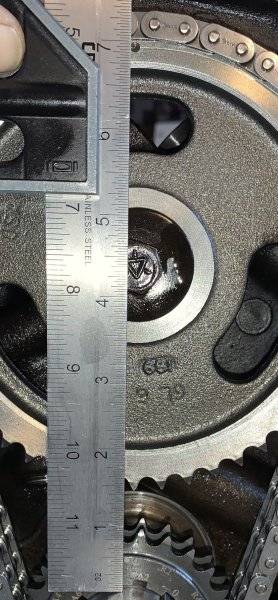

Here's a pic of my timing marks: Do they line up? I drive myself crazy sometimes!

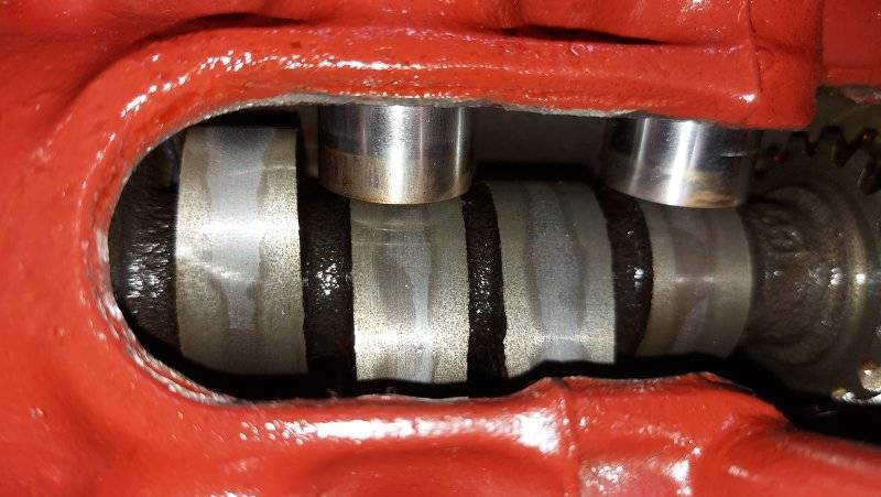

If you look closely there are 3 of them that are not turning in their bores.
Remember these are solid lifters.
The one in the upper right - the 5th one down on the right column and the 6th one down on the left column.

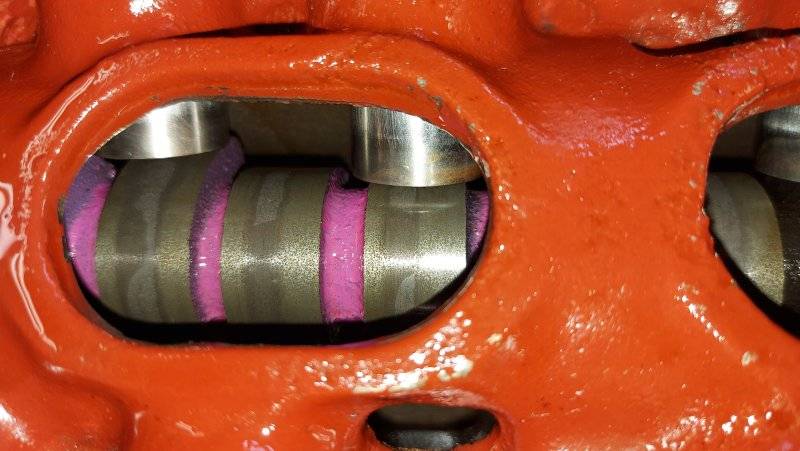

While I was at it I took photos of the cam.
The photos are from the front of the engine to the back.
And that was only engine break in time and 4 dyno pulls.

Isn't the timing mark supposed to be on the bottom of the top gear and the top of the bottom gear? No straight edge needed.
If you line them up that way the engine will be on compression stroke for cylinder 6 not cylinder 1.... Which is fine, as long as when you down the distributor in your aware of it...
Thank you everyone for the responses! I live and learn...
Yes, I messed up stalling the timing chain. It's on wrong. 180* off I think is an accurate description.
No, if the engine RAN, the timing chain and gears are NOT off 180 degrees.
As Greg said, It runs it's not 180 off, You can line up the gears dot to dot like GM & Ford does or you can line them up the odd way that Mopar does it... Either way works but if you line it up dot to dot the distributor will be 180 out... It runs so obviously you found the proper relationship before you stabbed the distributor....
I worked on my Chevys when that was what I drove. I changed a few timing chains and always deferred to the "dot to dot" method.
With Ma Mopar, I actually read and took the advice of smarter builders. The cam sprocket and crank sprocket BOTH at 12:00 has been my standard procedure if I'm not degreeing the whole schmere...
I think I understand, as far as both are lined up when #1 is TDC. ? :fool:
Yup. Crank turns 2x to cam. So 6, then 12. 6 then 12.
