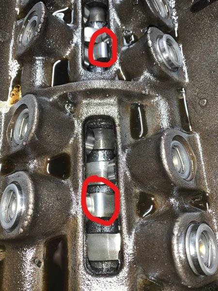

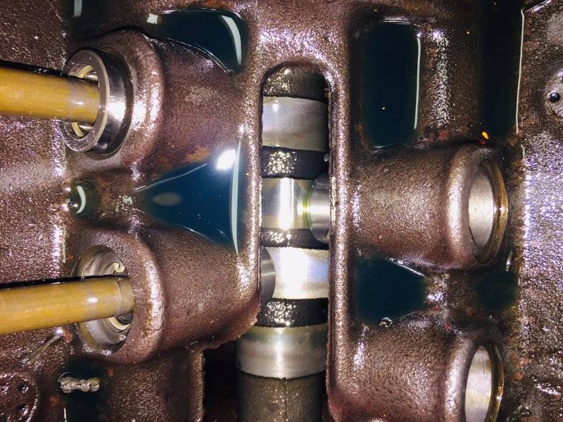

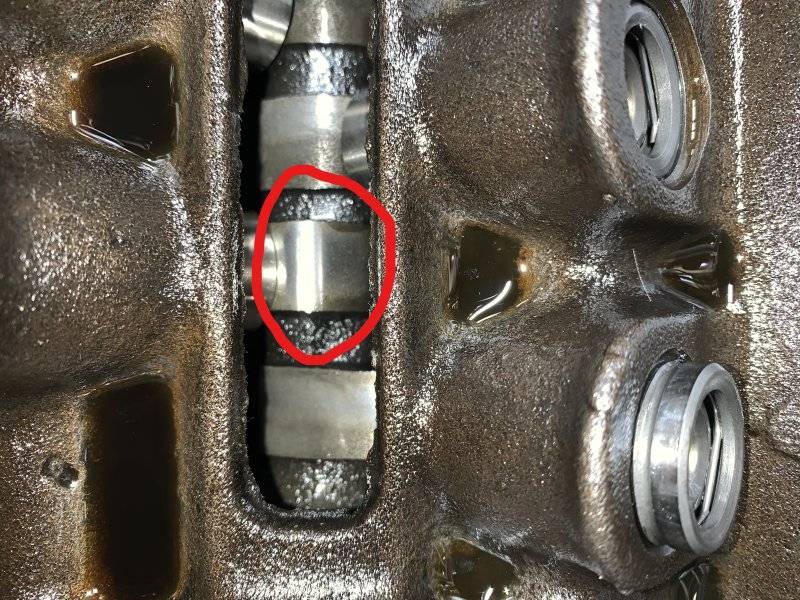

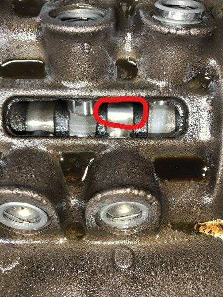

Hey Everyone!
This is the camshaft in my 383 from my Scamp. (Comp Cams 21-222-4 262/270, Lift .462/.470 purchased in 2019)
I completed break-in 20 min 2,000 RPM, correct oil, Zinc, etc.
I'm in the process of getting this car moving again (long story). I saw an UTG video in which he stated that if the cam lobe nose center line is worn all the way across, it's toast - After break in and running for only 30 min total.
I've read about cam issues @Kern Dog and others.
What say you?
View attachment 1506538View attachment 1506539View attachment 1506540

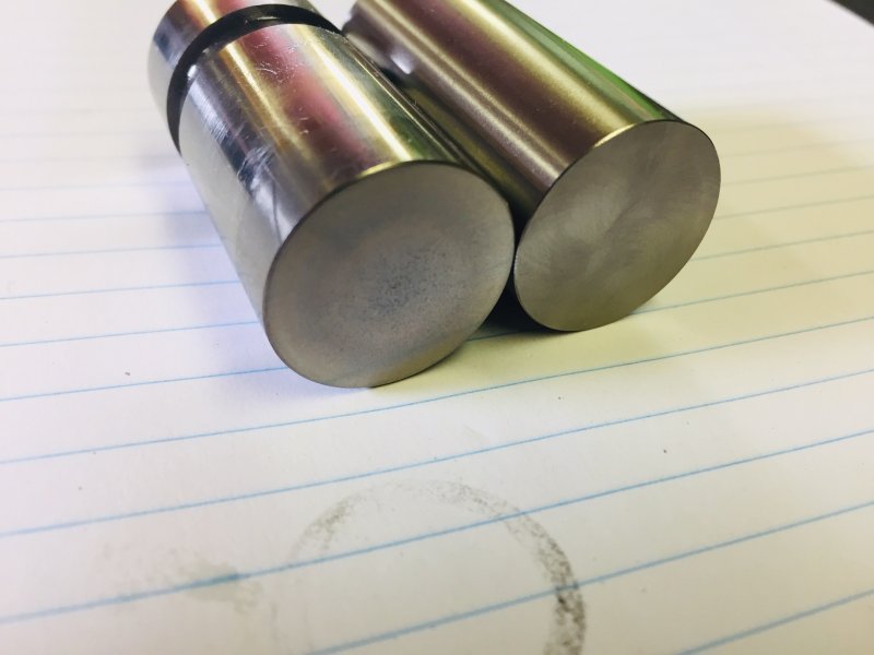

See mine, no idea on what the milage this cam and lifters had done.
You can see that across the tip of the lobe the contact pattern is wide, and everywhere else is narrow and located on 1 side of the lobe only. The lifter on the left is one of the ones in there, the other is a new one.
Seems a little pitting is happening on the center section.
These pictures are from 2-3 years ago and engine still running fine.
To me it seems correct that when the tappet goes over the nose the full width is used to reduce the lbs/sq. inch when it is under maximum tension.
Zactly
The hydraulic cams going flat is a huge issue. the pictures of your cam look ok. Being your intake is off along with the valve train take a look at your lifters and make sure they have a slight crown too them. Also the cam lover have slight taper to make the lifters spin in the bore. A local jet boat shop has run the mentioned cam brand. they had a cam failure while breaking in an engine on there test stand. They called the cam company. The online tech had ever excuse that it was an improper engine assembly and break-in procedure. Did you run a break in springs? How much lifter to bore clearance is there? Did you run no detergent no synthetic 30 weight oil with our break lube in the oil etc. how the shop was able to get the cam manufacture to warranty the cam was he pulled the cam measured the good lobes and took pictures with a micrometer on the cam showing there was NO taper. a straight edge on the showing there was NO crown on the lifter. I recammed my Road Runner last summer. I found ended up using a Mopar performance cam. Mopar has pretty much discontinued there cams. Mopar still have 4 left of the cam I wanted. They are old stock and still properly ground.
