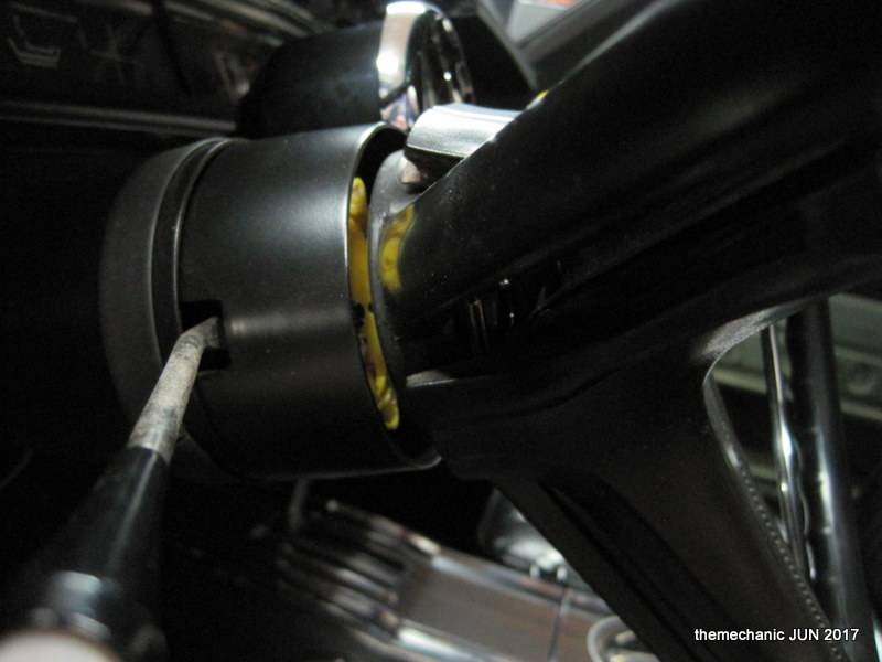

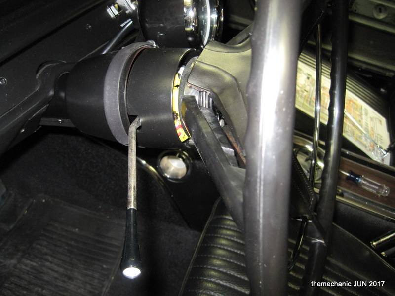

I installed my standard steering wheel today on my 69 Coronet; torqued to 24 foot-pounds per the manual. I noticed what appears to be a big gap between the back of the wheel and the collar. Heck, I can clearly see the ugly yellow turn signal switch.
Is that normal? How much gap, if any, should there be?

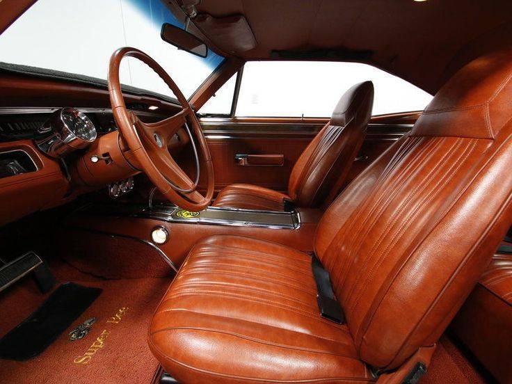

This car has one that looks to be close.
That gap is a lot smaller. I could live with that.

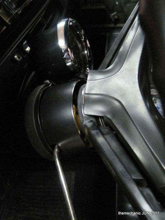

The gap between the back of the wheel and the collar is 1/16". But the distance from the OD of the collar to the OD of the back of the wheel is 21/64". The back of the wheel OD is 3 1/4". So, the collar must be 3 5/8". That 1/4" per side difference in diameters is making the gap look huge allowing the inner parts like the turn signal switch to show.
So, either I have the wrong wheel or wrong column. Assuming the wheel is the correct on, how can I tell if I have the correct floor shift column?

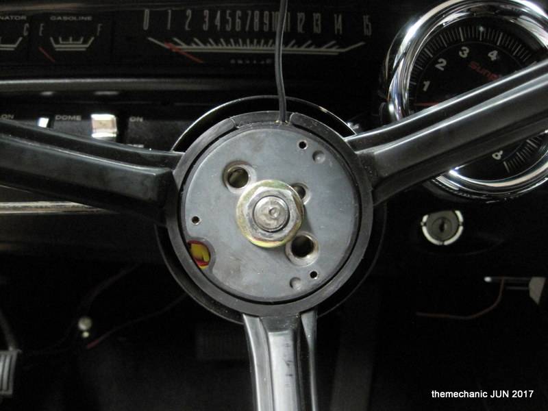

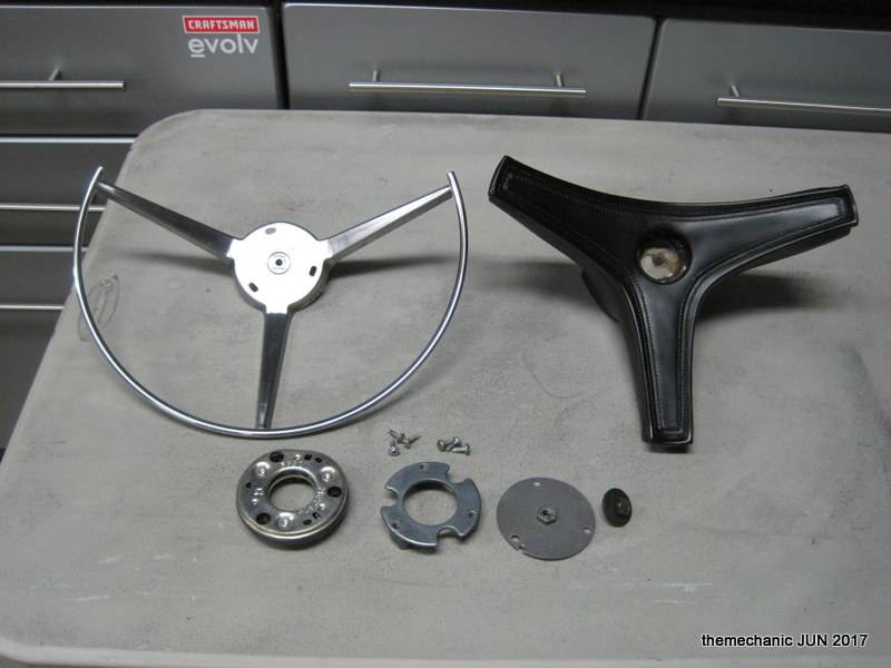

I took the horn pad and switch off and took a photo showing the difference in the diameter of the wheel and the column.

It looks like the horn button (contact plate) is either wrong or installed incorrectly. I believe the horn ring should set much closer to the wheel. The pad covers the gap.

I'm at my wits end with this wheel to column gap. I took the wheel, horn, horn ring, horn button, etc. off and checked part numbers. I have all the correct parts for a 69 Coronet standard wheel without tilt column. The gap is not between the wheel and column so much as the difference in diameter between the two. The base of the wheel is about 3 1/4" and the top of the column is about 3 3/4".
The other part of the problem is what someone mentioned about the horn pad standoff from the wheel showing the parts underneath. That doesn't look normal but what do I know. Mine is the only one I've seen in person and most of the photos online are at the wrong angles to tell anything.
