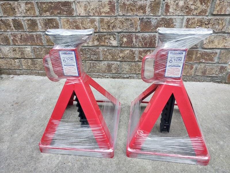

They arrived today via UPS in an undamaged box. JS were separated and protected by cardboard and wrapped in layers of tough plastic. No rattling around in the box!
Very nice jack stands!
Sturdy cardboard...

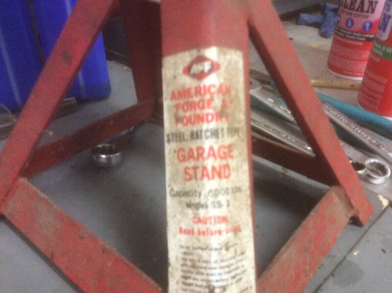

Posted pictures of these in HF recall. American Forge Foundry think I bought these at Sears 15/20 years ago 3 and 6 ton. I'm sure I paid less than $70 a pair. Tried to look up to see if they're still in business no real results.

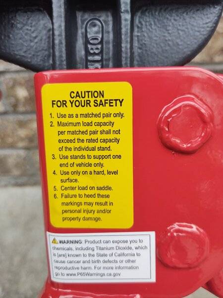

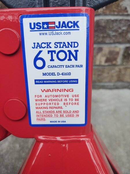

Im not sure if it’s all jack stands but many of the ones I’ve seen lately are rated for the pair, so 3 ton stands will only hold 1.5 tons each
Tag on mine says 12,000 per stand......
Good deal, I bought some 6 ton ones and they say the same. Some companies are getting shady with their marketing. These AC Delco ones from O'Reilly are listed as 3t per pair. It is not very clear from the advert, except that it says 'unit of measure: per pair', but on the box or instructions (I forget which) it will say '3t when used as a pair' or something like that.
