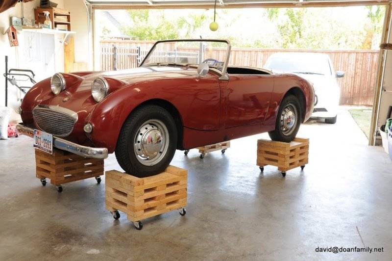

Aha, gotcha. I built something similar a few years backwhen i wanted individual wheel weights. I had access to a roll-around 1000lb beam style scale, so i built three perches the same height as the scale pad, then moved the scale to each wheel.
I dont know how accurate it was, certainty not as good as a thousand dollar digital scale, but the cost was,,,, ,zero. Borrowed scale, scrap wood from other projects.
