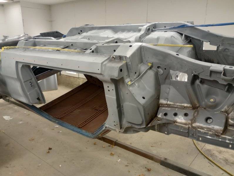

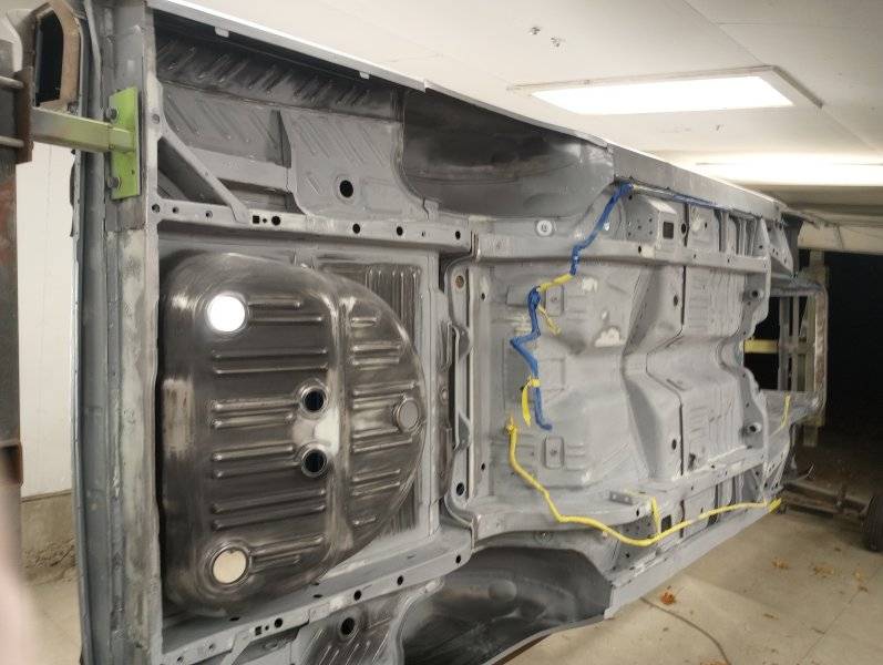

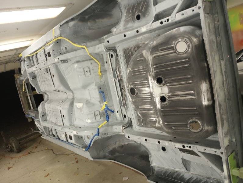

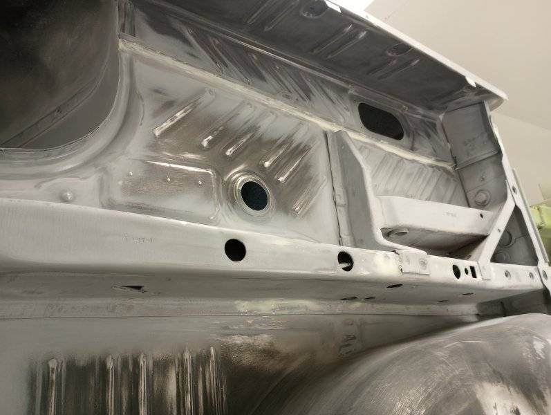

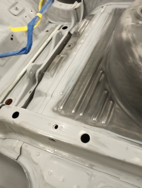

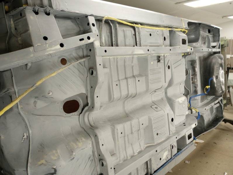

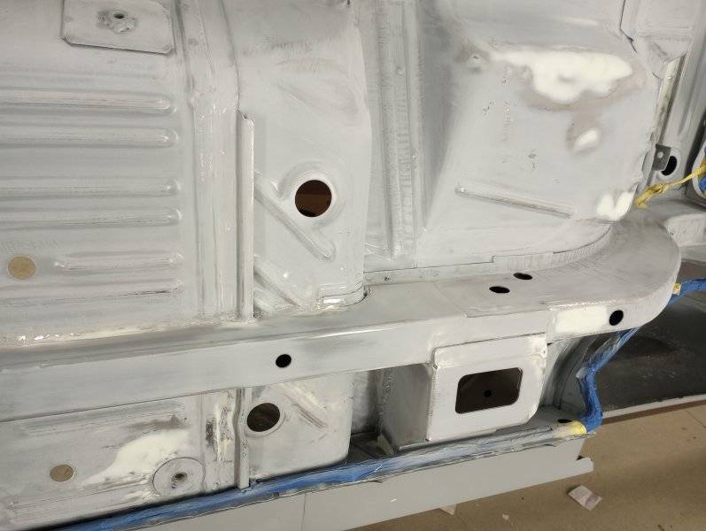

guess I need to update while I'm here........ just as the underside of this car begins to kick my ***, I can move on from the worst part of the job...... you could serve Thanksgiving dinner on this thing.........and I don't think pictures do justice to the amount of labor.
no one ever worked so hard to avoid having to get a real job :BangHead:
View attachment 1558241View attachment 1558242View attachment 1558243View attachment 1558244View attachment 1558245View attachment 1558247View attachment 1558248View attachment 1558249
Did I see some rust there??? :rofl::rofl::rofl:
The body on this thing is going to be amazing. I guess I better make sure the engine matches the body quality... :rolleyes:

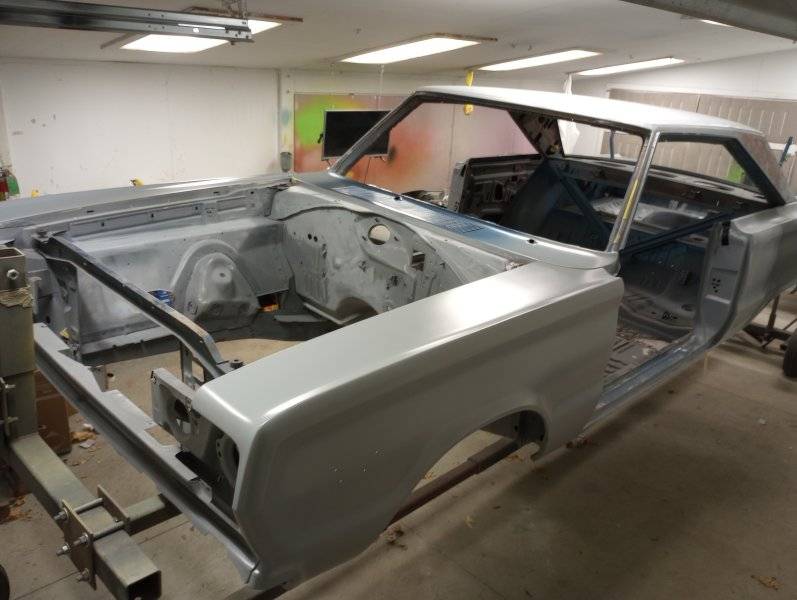

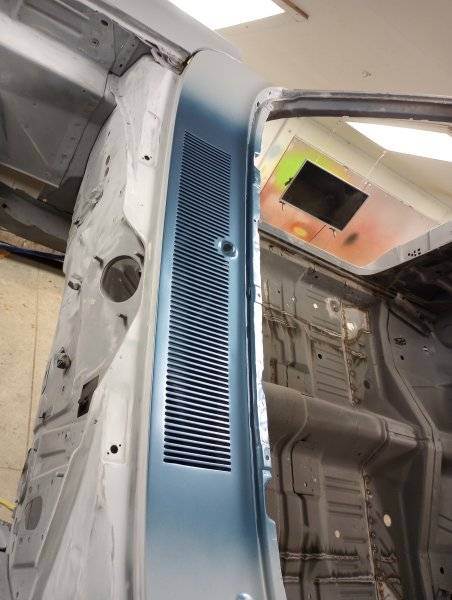

sealed up the cowl, fenders and doors for the last time...... now I can get the fenders back off......I put some blue on the cowl vents; just to take a look; at both the vents and the color......looking good
First bit of color on the exterior!!! :bananaweed:

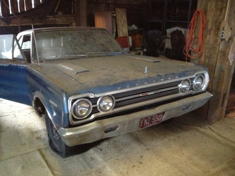

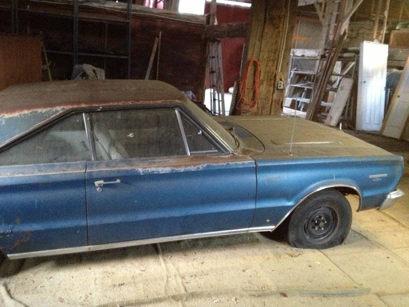

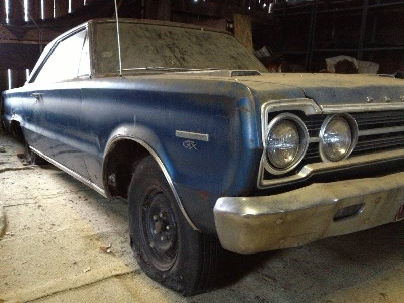

It has come a long way from the way it looked sitting in the barn.

I can't wait to see it painted and starting to come together - it's going to be a great car. :thumbsup:

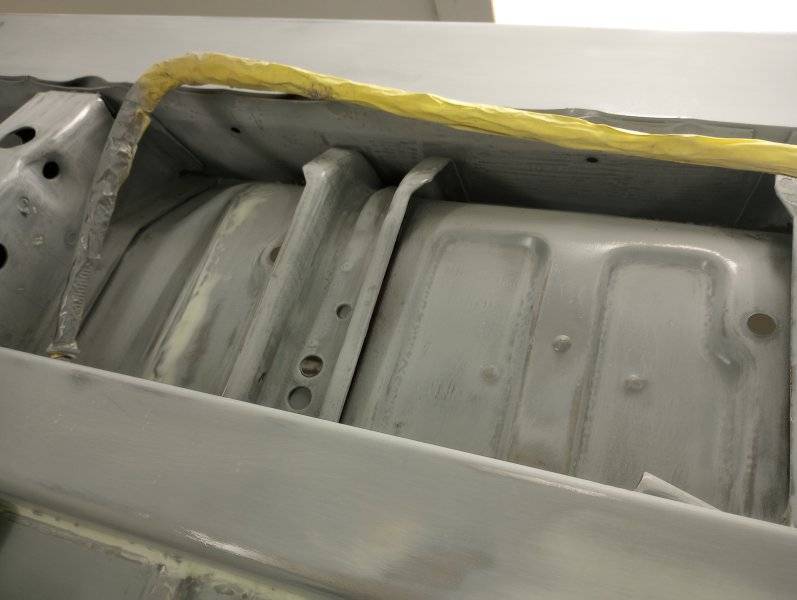

after numerous distractions...... I'm back at it

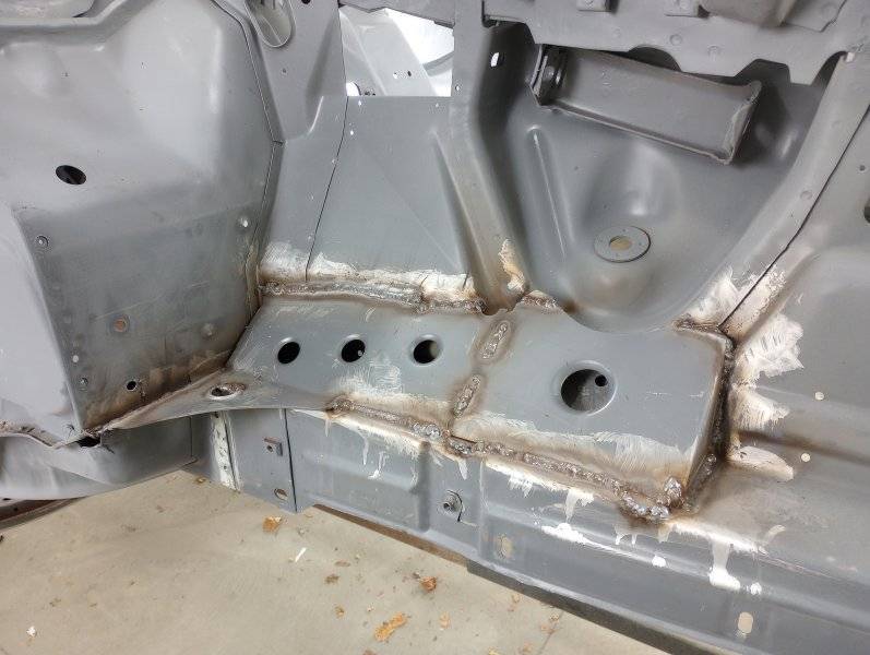

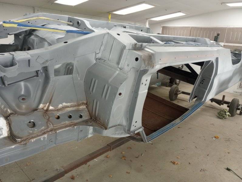

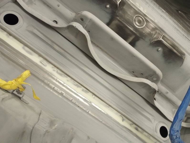

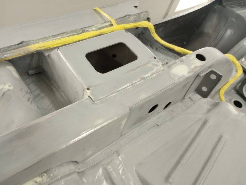

no glamour shots just yet........these front stiffeners are the last major task that was left to be done....... doesn't look like much, but they just tore up a 12 hour day. :rolleyes: got a few other loose ends tied up also; I'm finally closing in on it
now if the world will just leave me alone for a week or so, maybe we can get to the next milestone :mad:
I can't wait to see it painted. That medium dark blue is going to look killer! :thumbsup:
