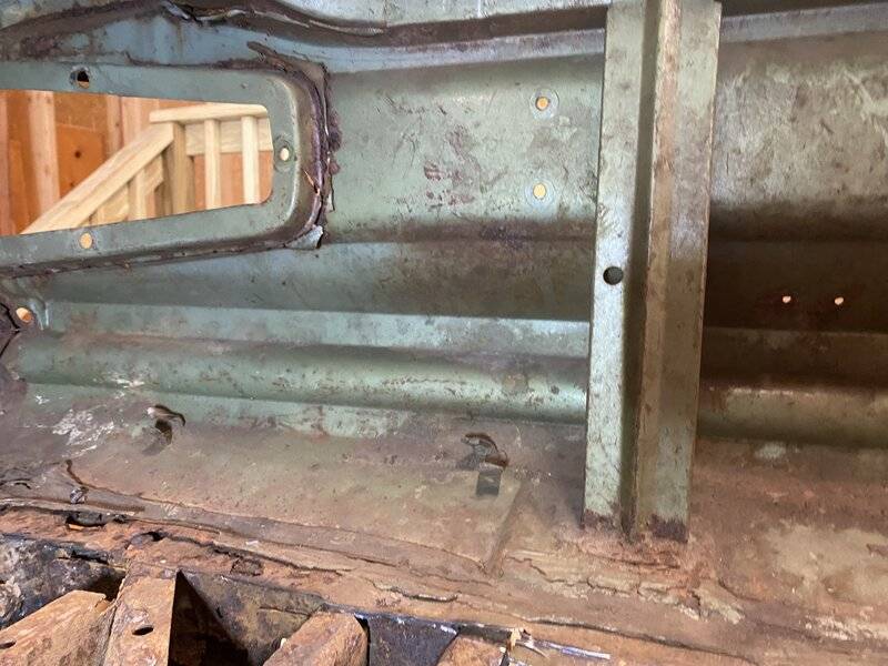

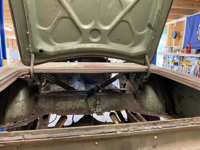

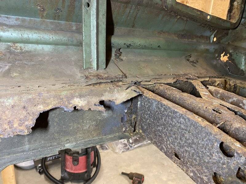

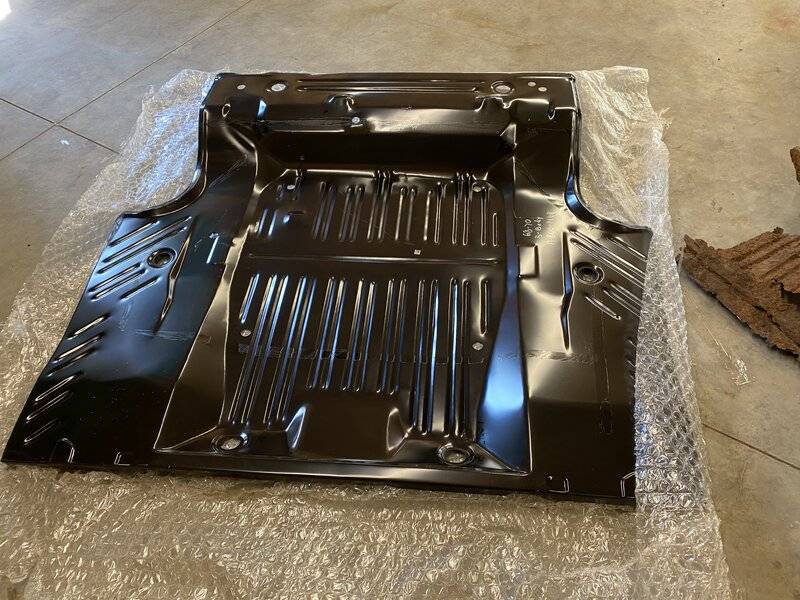

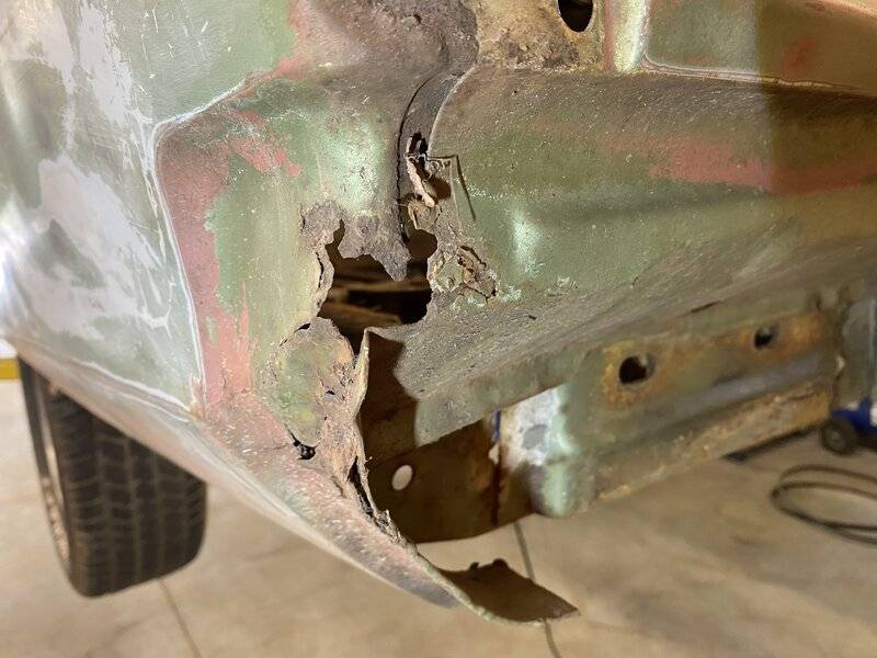

the quarters will dictate things from this point on....... get the quarters tacked firmly into place, attach the drop off to the bottom of the quarter with a couple screws, you may need to adjust this a bit....... now jack the entire trunk and rails into place and screw or tack the pan to the drops and inner wheel house

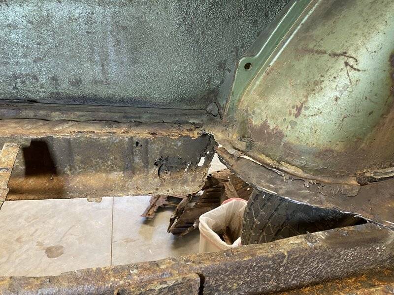

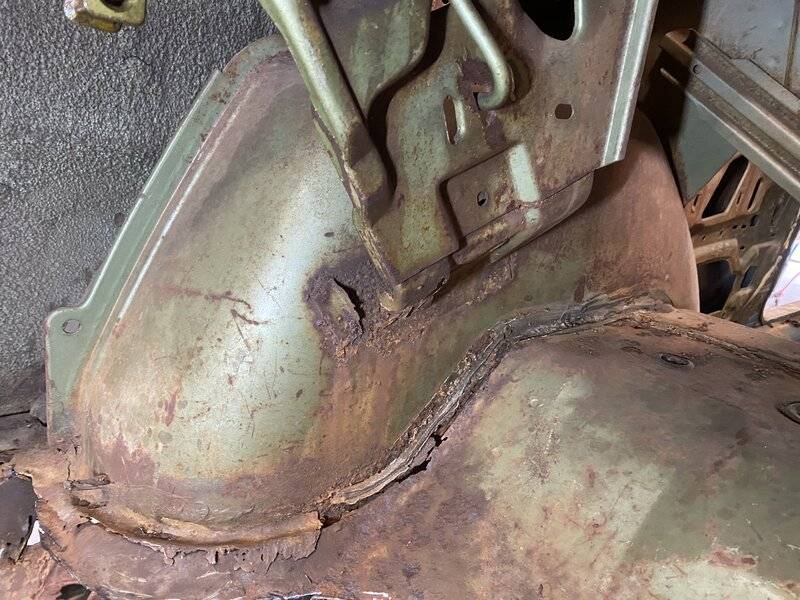

Tip: where the drops meet the trunk pan....drill the plug weld holes in the trunk pan, not on the drops: it leaves more room for the welder and grinder..... where the trunk pan meets the inner wheelhouse, drill the holes in the wheel house for the same reason. If the inner wheelhouse is rusty swiss cheese, just replace the bottom inch or so with new metal
....... use enough screws or tacks to hold it firmly in place until welded........ I leave the tail panel off until all the work inside the trunk is complete...... last, attach the tail panel, test fit quarter extensions, your deck lid is where you set it earlier and will help......... this stuff ain't rocket science, but patience and cleanliness is key.......good luck
