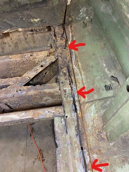

seriously.... look at the early pictures in this thread

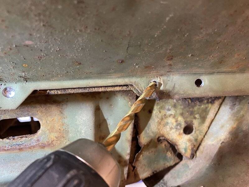

i like to grind my spot welds if i can, rather than use a drill......... i use the edge of a cutoff wheel on a die grinder

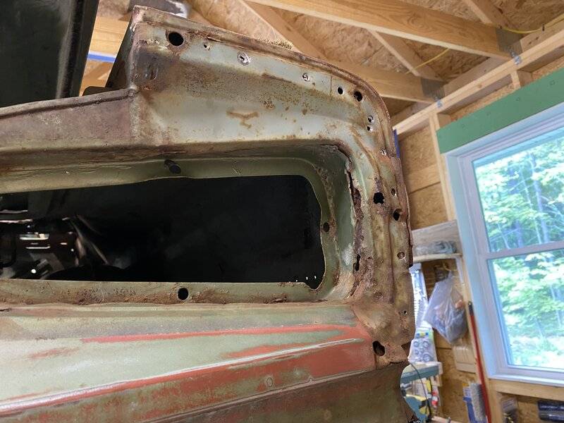

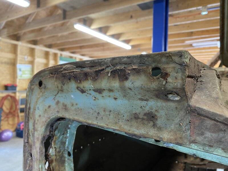

yes......... replace the rear crossmember

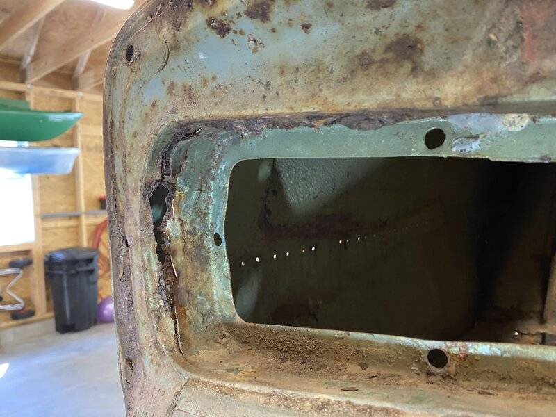

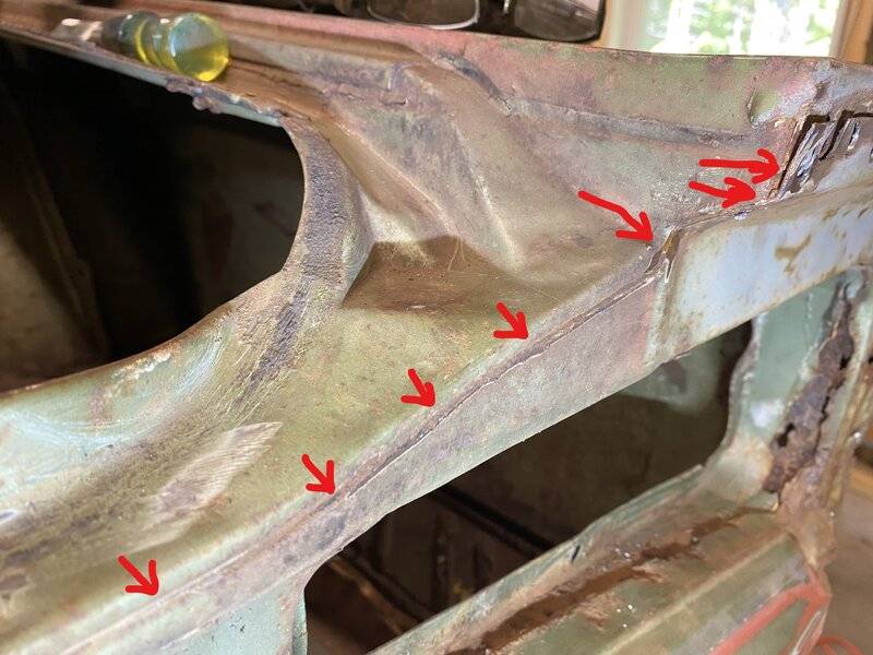

i would get the tail light panel off first and set it aside, beware, there are a LOT of spot welds holding it to the gutter on each side up top....... you need to drill those, or better yet use a spot weld cutter; but it is very easy to make that area swiss cheese. it may be easier to just replace the swiss cheese, but you ain't there yet .......... yours will have rust in that seam and you will be able to address it. did I mention "keep cuttin'"?
you may need a section of frame rail from a donor car..... guys here have that stuff...... you got this
