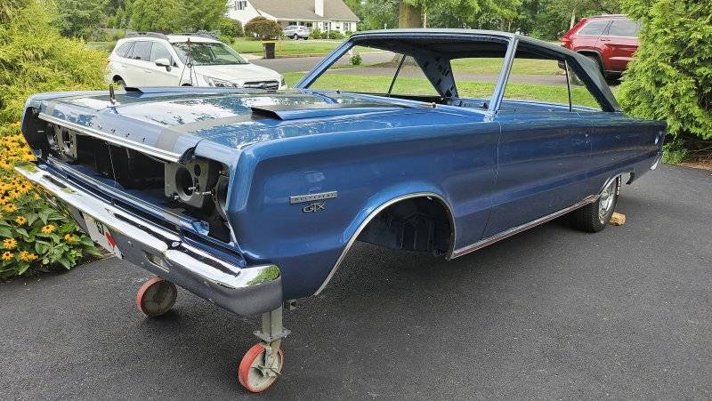

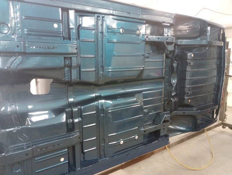

I don't want to hijack Mark's thread, but here are a couple. There has been a decent amount of work done where you can't see it like running brake lines, attaching pedals, gluing trunk weather strip, mounting various clips, etc.Need some pics Hawk!

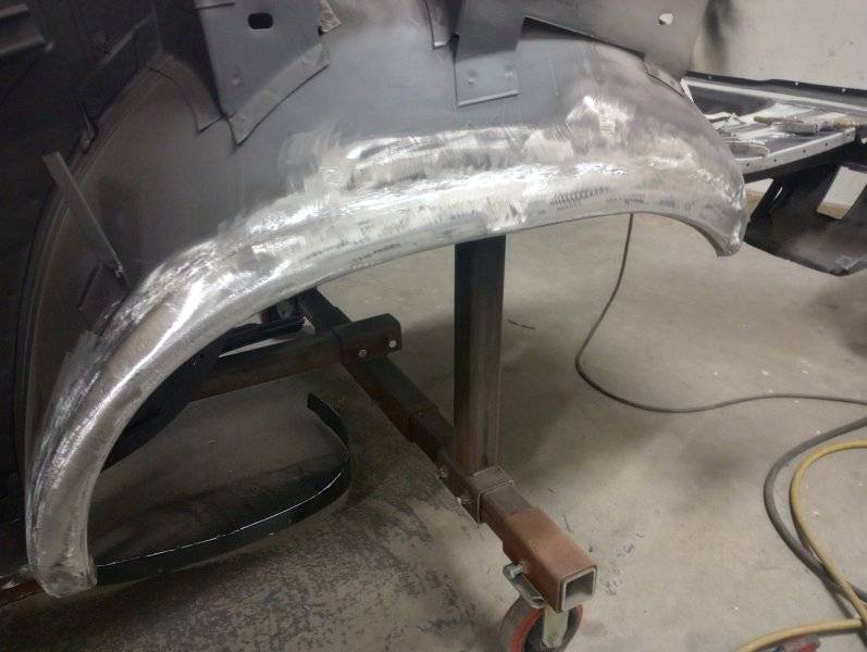

After installing rear bumper:

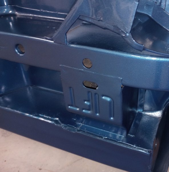

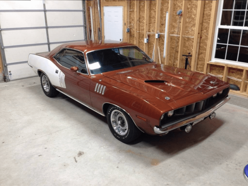

After installing front bumper:
