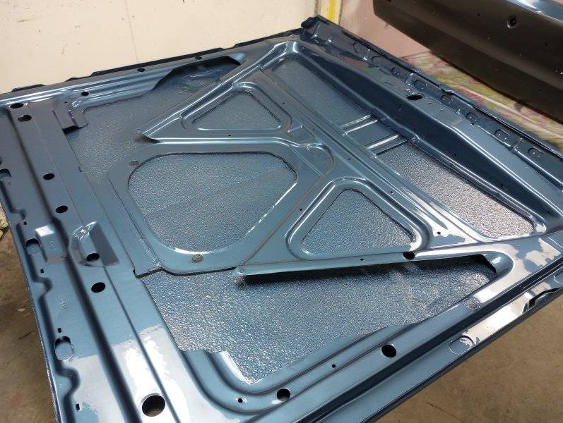

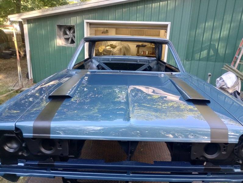

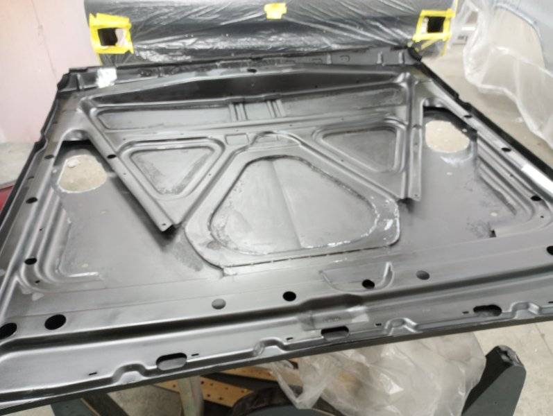

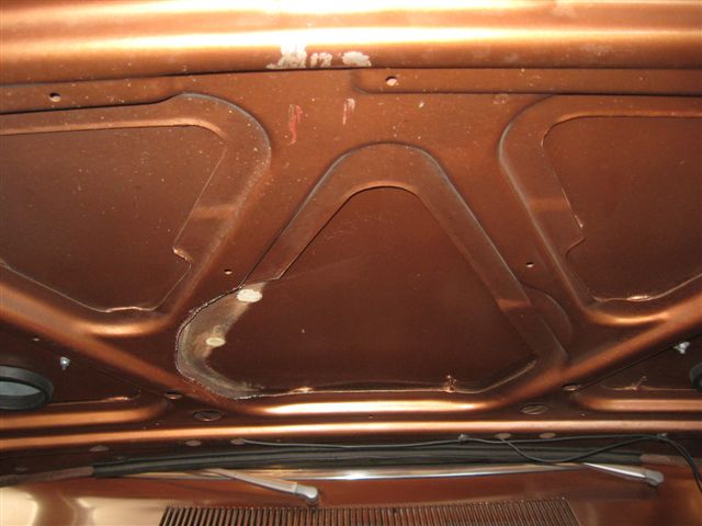

I also had to move the scoops forward about 4 inches from the normal factory location, so the 3 inch air holes would avoid the hood bracing. Nobody ever noticed.
we have a mock-up ram-air box that fits nicely into the hood frame, I had to remove a little bracing
