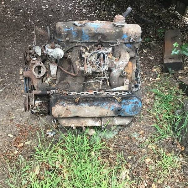

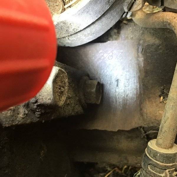

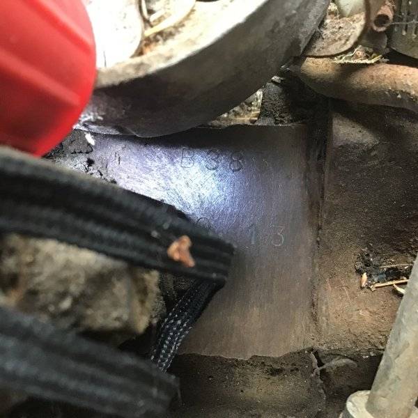

Just bought a 383 for $150
I’ll definitely keep the fuel pump pushrod after reading all the horror stories here. And yes, I would really only want the block for a stroker build.

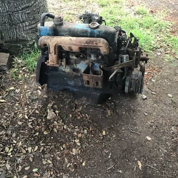

center sump pan is car. motor mount brackets are truck.
valve cover are early - mid 70s . So its a hodge podge or parts. But its easily worth the 150 as a core engine

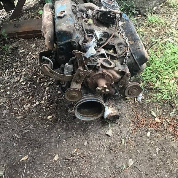

Anybody got a Ram with the Sno-Fighter(?) option to compare the idler pulley layout with?

This engine I believe was stored in a barn, at a now closed dump. It’s not seized, and looking into the oil fill hole, the rocker gear is quite clean. I’m hoping someone pulled it for a project and it’s OK. Does anyone know about the passenger side engine mount? Truck maybe? I’d love to stroke it. 440 source only shows a 3.75 or 4.25 crank for it. also, would TF 240 heads work, or the valves too large?
