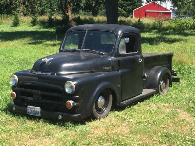

Along the way I found time to build a 52 Dodge PU with a 56 Desoto 330 ci Hemi in it in addition to several other minor repairs/builds such as a 98 Dodge 3500 diesel, 76 Dodge D700 2/5 ton truck, etc. All of this has also allowed me to amass a lot of tools and equipment which allows me to be essentially self sufficient.

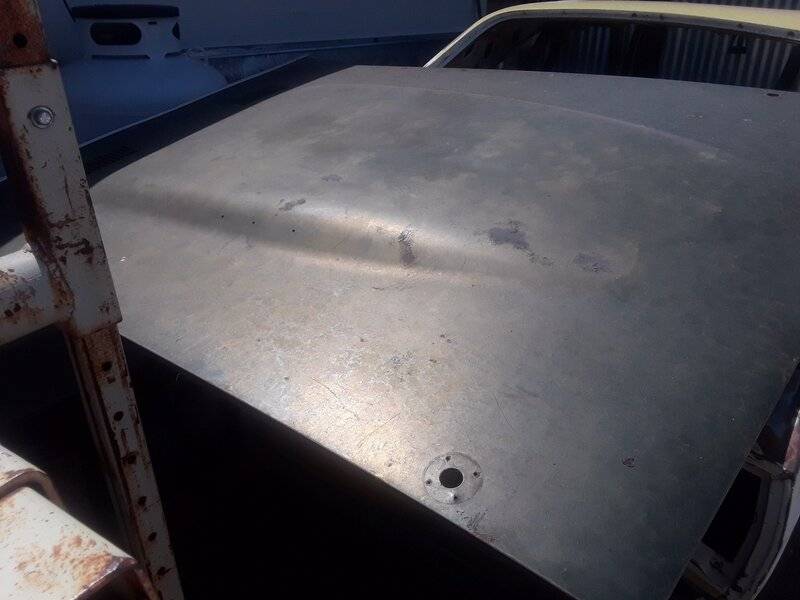

The car is coming with a 72 Rally hood (so I am told) but I want to run a AG hood. I am being told that the 72 hood cannot be made into a AG hood? Maybe I need to sell the hood and get a new AMD hood.
