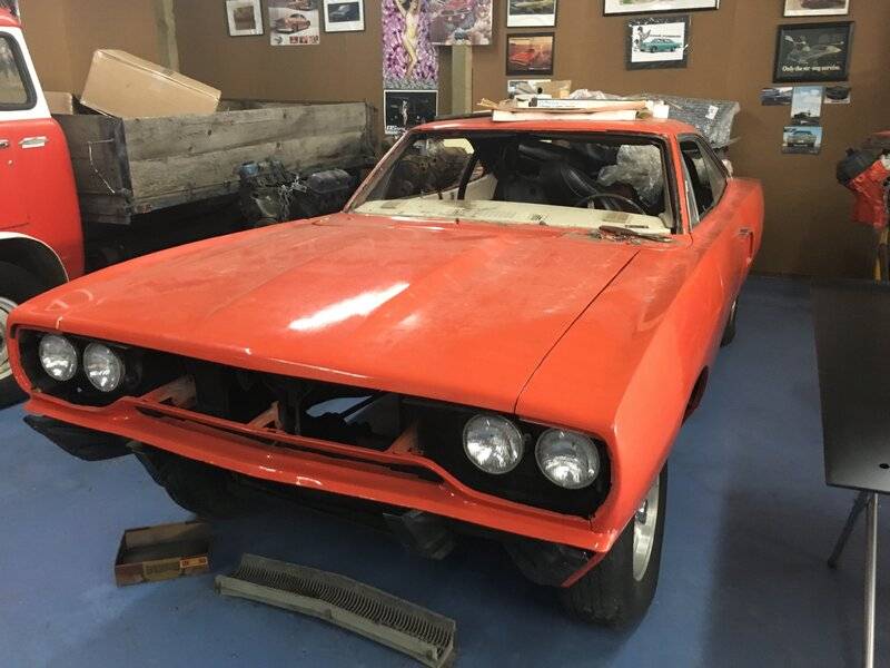

So, I bought a 71 Charger last week and got a very good deal on it. I was never a huge fan of them (or subsequent years) but over time I began to warm up to them and since this one was a smoking deal, I am even more in favor of them.
It is completely disassembled but all pretty much there. It was a 318 B5 AC PB PS car originally but I intend to do something else with it; it comes with a date correct 71 383 cast crank engine but I believe I am going to go G3 Hemi with a 4 speed (A833). I don't have pictures yet but will post some later.
My intention right now is to make is a Superbee clone/tribute with a 5.7 but I am still thinking about it. I will keep it blue but probably not B5. It does have a bulge hood (which I am told is a 72 hood) but will probably put an air grabber on it. It comes with a 3.23 SG which I think will work behind the 5.7 and A833.

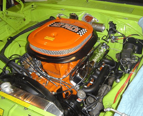

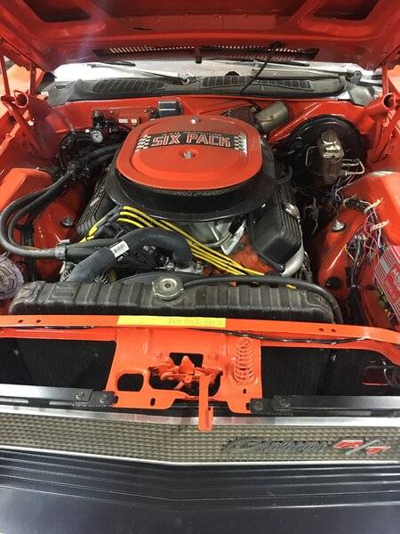

If it were me I'd keep the 383, if you want more hp stroke it. It will be a far easier route. You'll have way less fab work to do. I'm just not a fan of the way they look under the hood. If you want some cool factor put a 6 bbl set up on it.

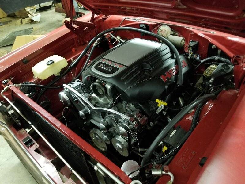

This,
or this?

I like the G3 engines. The 5.7 has some respectable balls, 400hp stock so there's that, along with the weight saving's it's hard to find much negative with this combo.

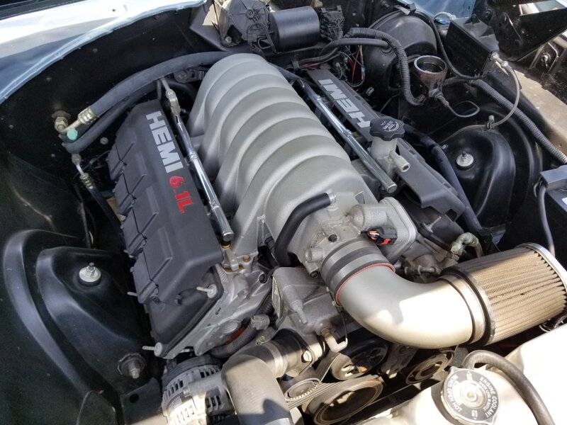

If I had the money, I would go with a 6.4 Hemi.
The 5.7 is awesome, nothing wrong with it, at all. That being said the 6.4 is a horse of a different color!!!
The 6.4 stock is a MONSTER, 485HP 475torque, using the factory MDS cam.

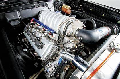

Indy sells items to hide the coils, so you can make the gen 3 look like a duel plug race gen 2 Hemi.
