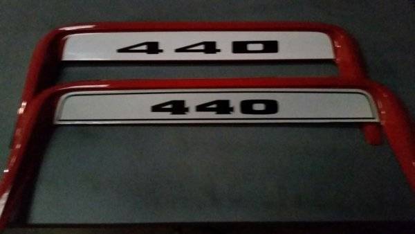

The repaint is underway and look what we found. Pretty sure both were bought at the same time. Now i don’t know which is correct
Can't look at them both at the same time......
I'm just kidding around. Glad your making progress. They took care of you on the paint job??
Yep, they are taking care of me on the paint . Up to now I’ve been patient and told them it has to be 100% right. However my patience is running thin
