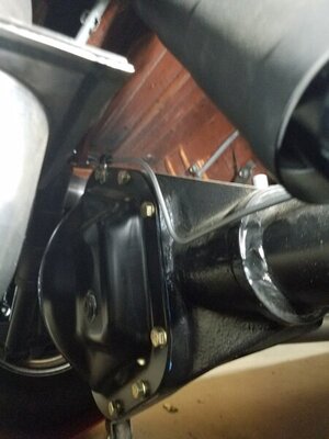

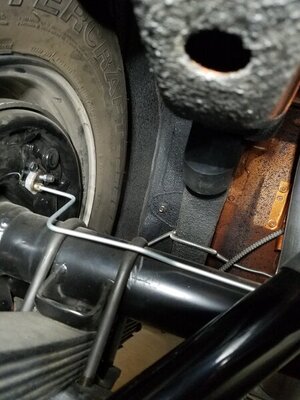

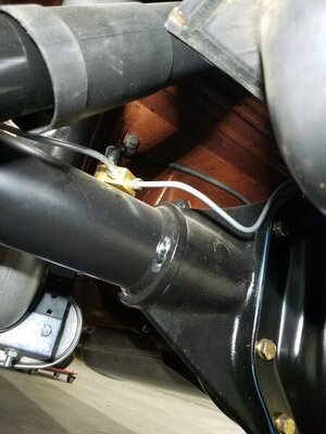

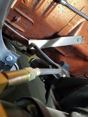

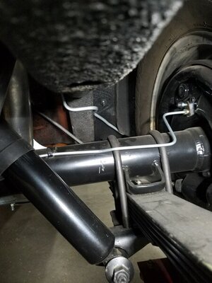

I got a 3.73. And yes, making my own brake lines (as I write this). I picked up a few new tools (I love tools). A really nice bender, a tubing straightener and a hydraulic flaring toolkit (it does all types of tubing/flares). I'll post some pics and info on the tools later tonight.
I had put together a full set of new rear 10x2 drum brakes, so for now I'm using them.
I bought one through Cass last spring as well but am curious why you have to bend your own brake lines? He sold me all the correct lines and they fit no problem. 3.23's are the lowest numerical ratio offered. I am pretty sure Cass is the one who got Strange to offer that ratio.
Really? Hmmm, Oh well, just finished one side and I'm pleased with the results. :)
Can you post pictures of the brake lines installed on the S60? To show how they are ran, thanks.
