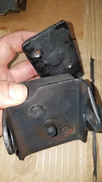

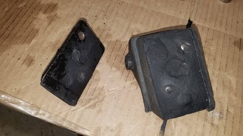

Sorry for the late follow-up guys, I forgot about this thread...but I have a busted DS engine mount. Which I didn't want to believe, because I put "mity-mounts" in last year. (They're the ones with the bolts that go all the way through the isolator). I noticed more movement than I wanted to see when revving in park, so I crawled underneath and jacked up the driver side of the engine. The top plate of the mount completely separated from the rubber and bottom plate. I could jack up the engine until the header tube hit the passenger side fenderwell:BangHead:.

Nice quiet evening so I decided to just pull out the dead mount. I had a stock-style one in good shape... I'm putting it in so any possible Sunday morning coffee and/or pastry run won't be hindered. Maybe the old bailing wire trick for reinforcement. Hell it only needs to last a couple of weeks...I'll be gentle on it:rolleyes:
These 2 allen bolts are the limiters for stretch right?
And they are sheared off....wow.
