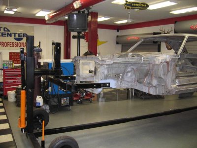

When I built my shop I installed a 2 1/2 ton heat pump / ac unit with LPG gas backup heat. The thing is , I hardley ever have to use the a/c because two of the exterior wall are dug into the side of a hill. Also have good shade trees above. I like the gas backup , because I usually turn heat down to 50 or so if I/m not out there. But when I come in on a cold day the Gas backup brings it up to temperature fast , then the heat pump takes over for better efficiency.

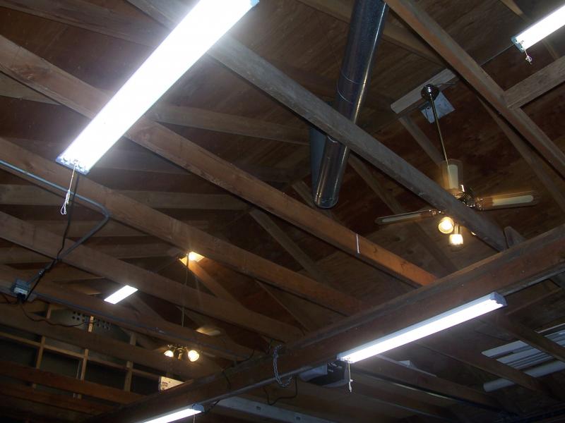

I use fans to keep air moving & a roof vent
hope this helps,
Happy 4Th....
never forget,
Sonny
