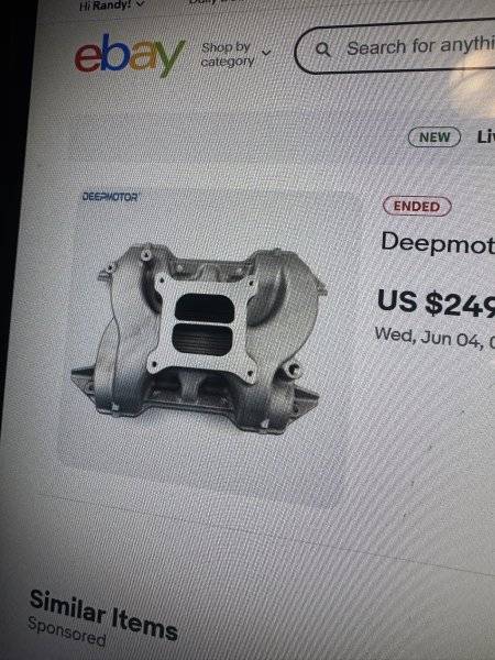

I already saw one on eBay that looked like an action plus

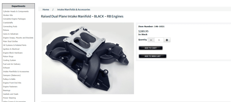

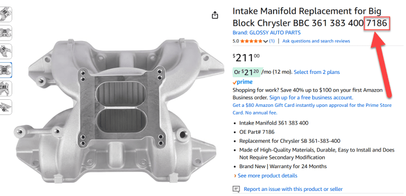

Correction: The ones on Ebay and Amazon and 440 Source are selling Edelbrock RPM knock offs.
Ebay/Amazon RPM knock offs/440 Source also sells these in RB and Low-Deck/B sizes
Edelbrock RPM
Co
The black painted one does look like an Edelbrock Performer RPM....

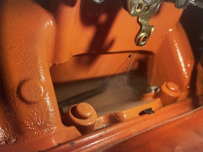

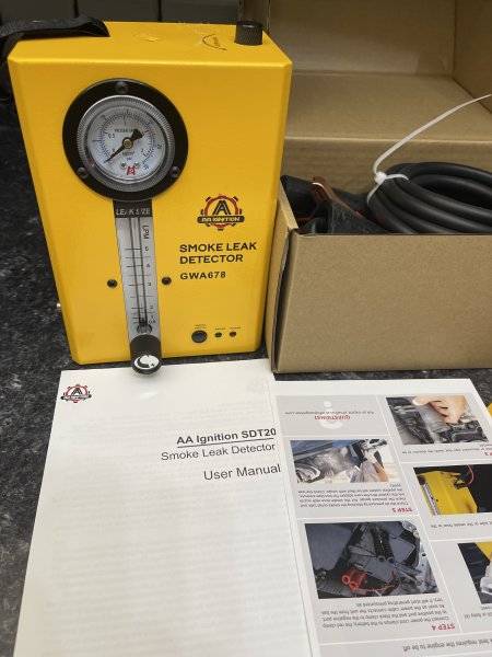

I am using one on my 340. Fit and finish was excellent. Had a minor pin hole leak but I smeared a small amount of epoxy and sealed it. Used an automotive smoke generator to detect it.
Zoom in you can see a vertical smoke stream.
I would certainly buy another but would test it first. It was obviously a porosity issue in the casting. This can happen to any mfger.

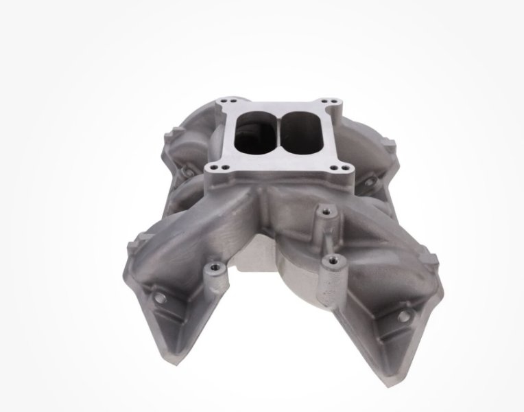

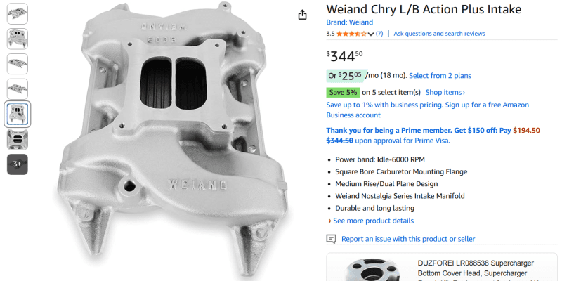

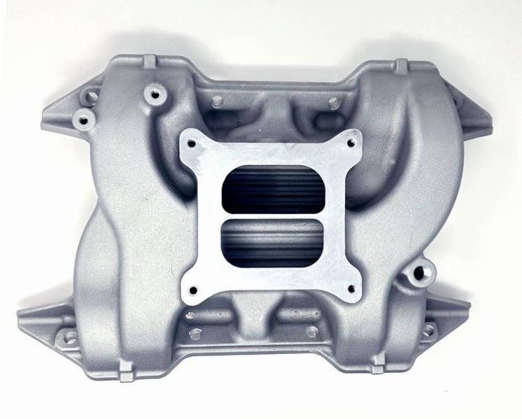

This the action plus knock off I was talking about
Yes, I saw those after I posted.

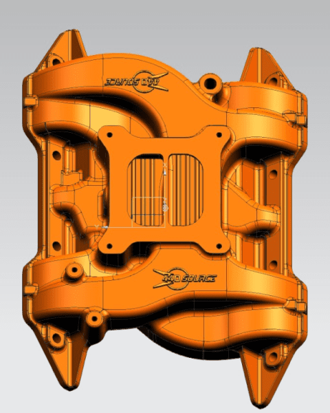

440 Source is also selling the exact same thing (same picture I think too): Dual Plane Intake Manifold - SATIN - B Engines 440Source made it sound like they made them up. And sounded like they were exclusive. Guess not.
440 Source is also selling the RPM knock off's too.
So 440 Source is selling both an Edelbrock RPM -RB and a Weiand 8009/8 dual plane intake knock off's.
