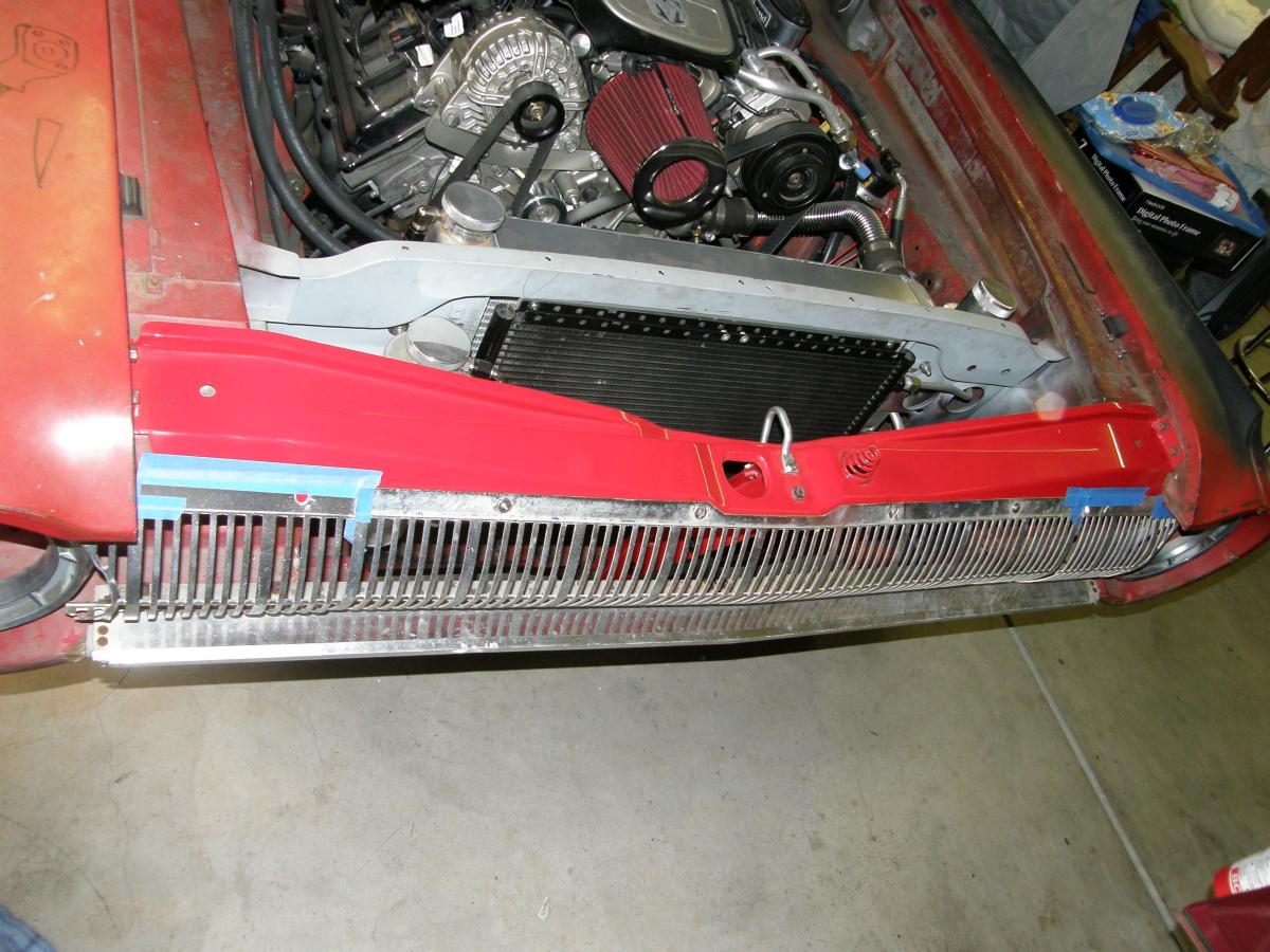

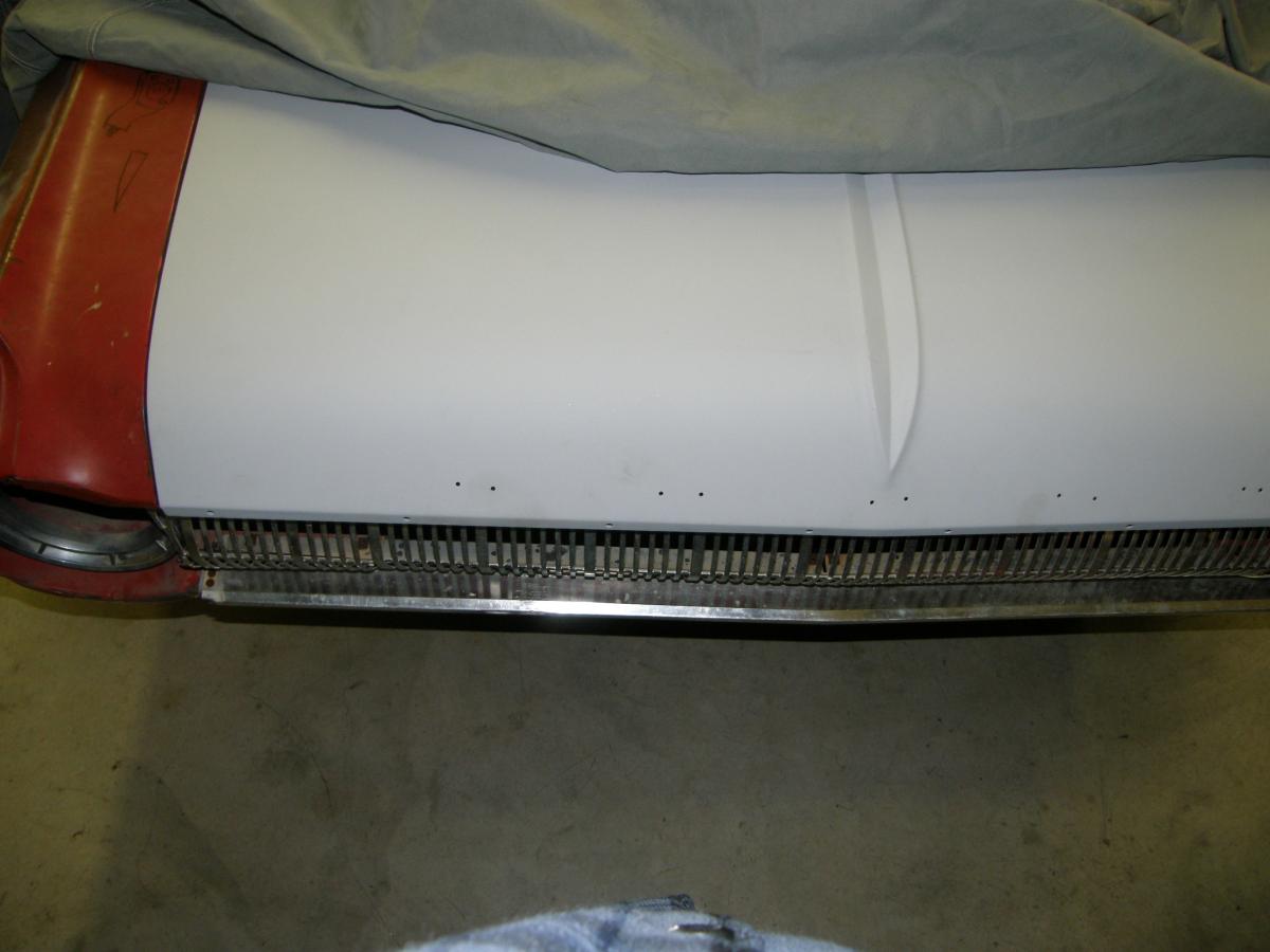

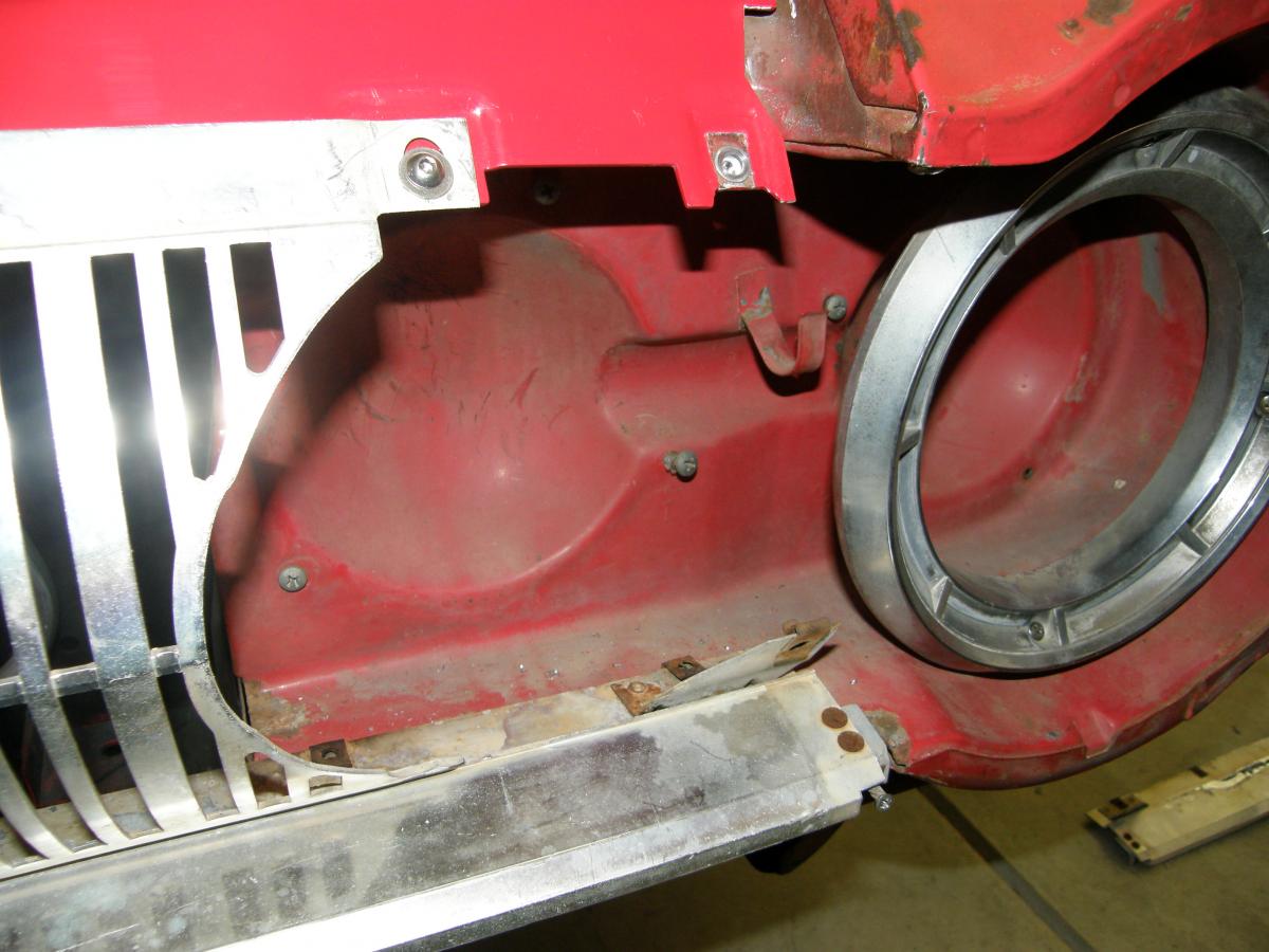

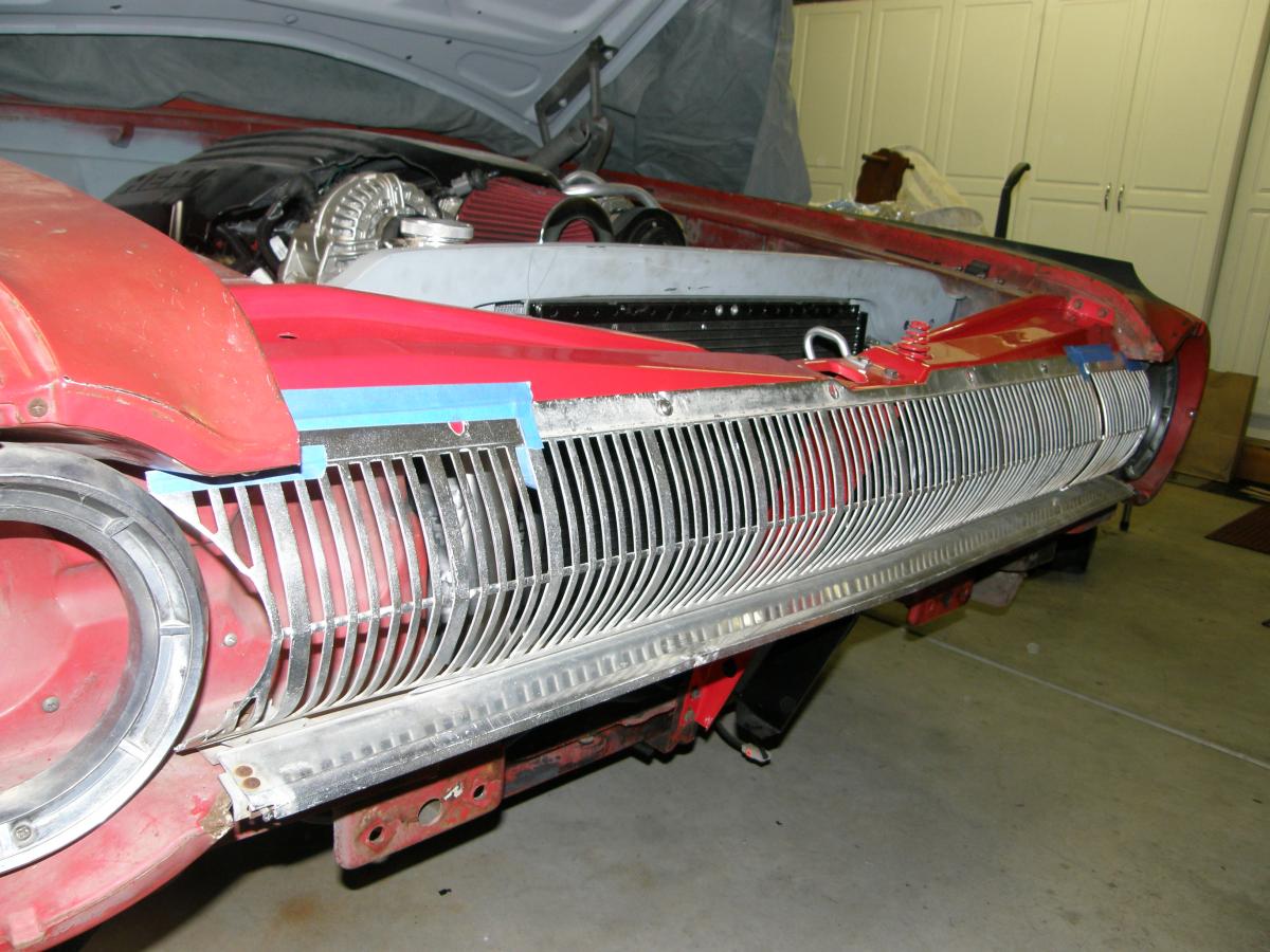

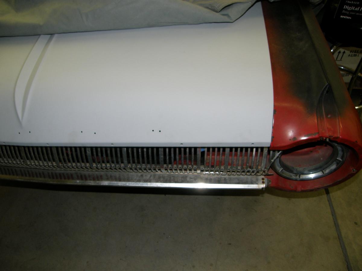

Well I got a few hours this weekend to worrk on the grille to convert it over to a super stock. Now if only I can find the bag of bolts for the grille, gotta be somewhere in the cabinet???

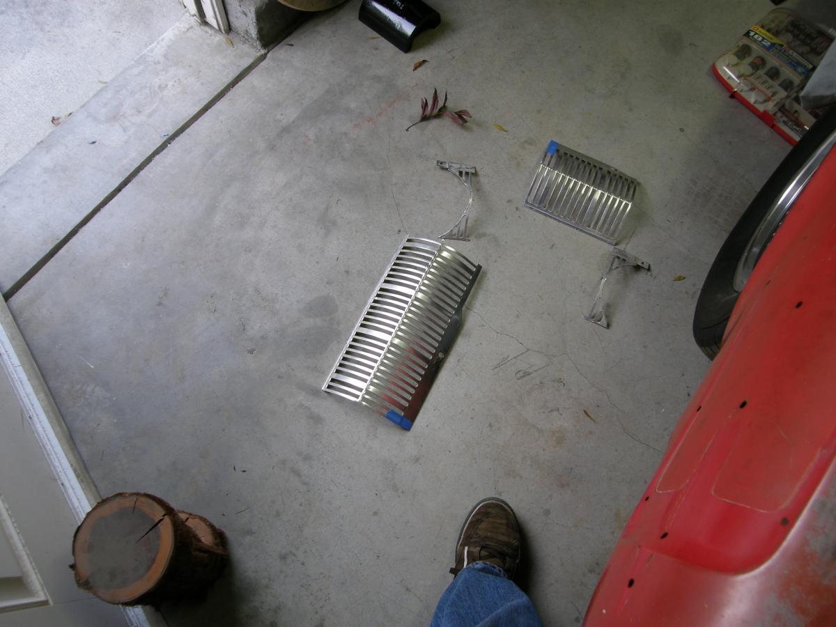

Bolts were nowhere to be found, so I had to improvise. One grille is mounted on the car, the other grille has been cut in half and I should get some pics of this soon, also the got to mock up the cut lines, so this will be delicate to say the least. Did I say this was gonna be easy?, I retract that statement.

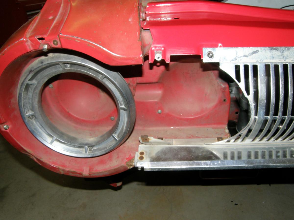

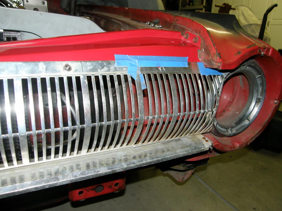

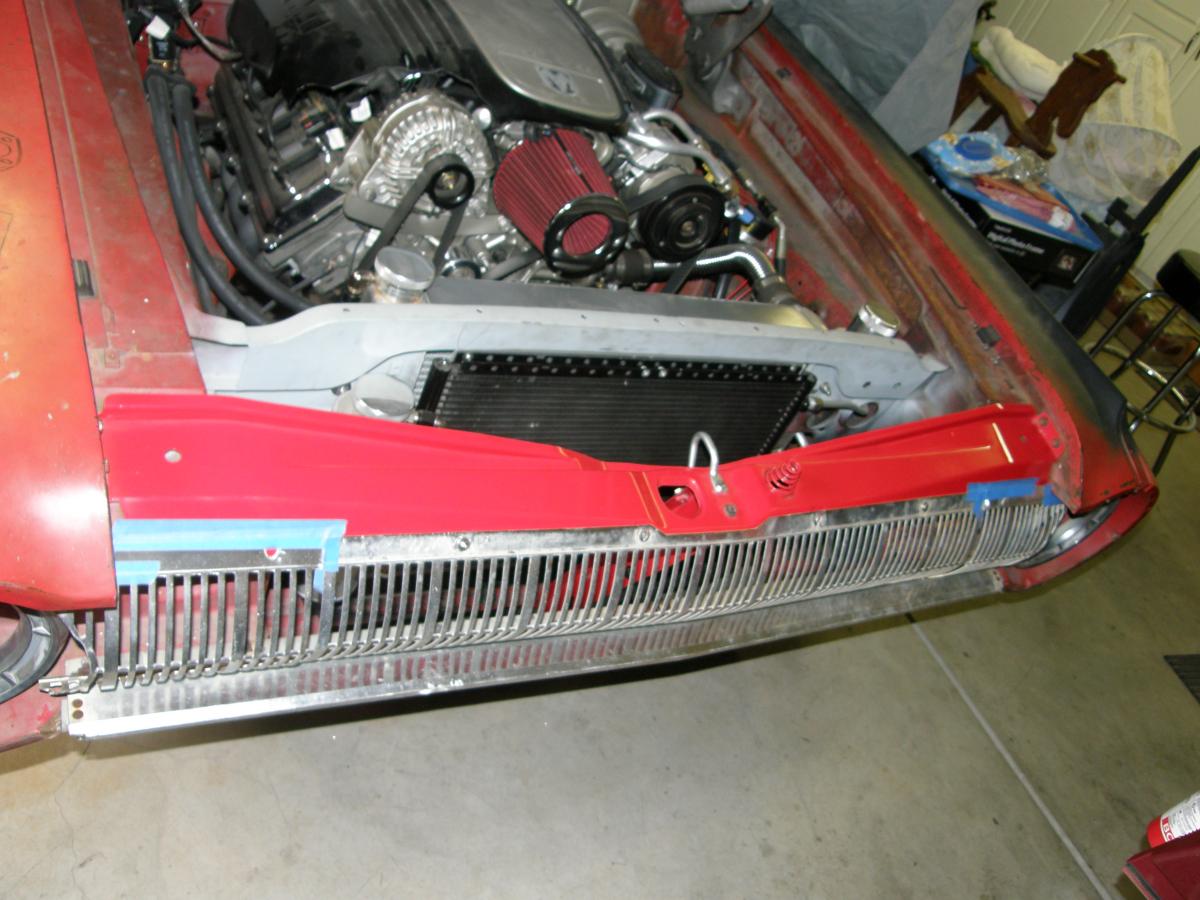

Here are some before and after shots of the grille converted to superstock.

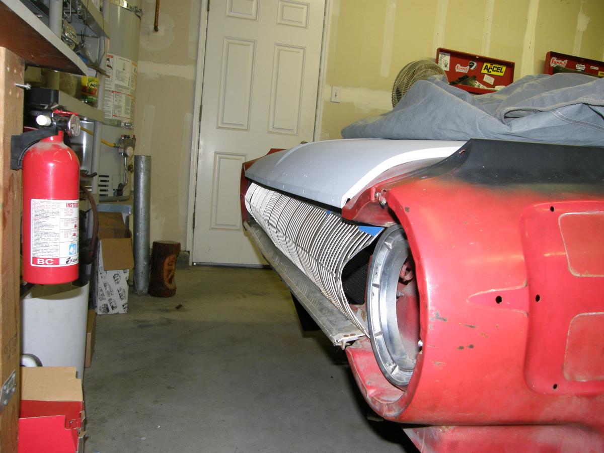

Sorry that I can't get a total frontal shot, my work space is way too small as you can see from the last pic. Well now there are 2 less perfectly good grilles around, but I think the end result will be worth it. Now I just gotta weld it up at work on Monday, sand down the welds, blend them in, then either polish the whole thing or send it out to be chemically done----still on the fence for that.
Still working on the details, cuttin', and filing. I thought there would be more questions, might not be everyones cup of tea, but I thought alot of people might see this and figure they could do it themselves.
Still working on the grille. Hope to weld it up next week.
Yeah, I double checked all measurements before I cut both grilles, but I cut shallow to allow me to sneak up on the right spot with a file. I was going to have 4 bars in the addition, but after looking at numerous superstock grilles, I was finding that it's only 3 bars additional, so I had to cut 1 bar out. I checked out Moshers website and that sealed it for the 3 bars instead of 4, they seem to be the guys that would know this stuff. Thanks for the compliments.
I have some aluminum rod that you use with a propane torch or soft flame from an oxy/acet set. The rod melts at around 700 degrees and the aluminum melts at 12-1300 degrees. The trick is to get the base metal clean (since this part was bright dipped from the factory all of this has to come of at the weld joint) once you got it clean, heat the metal and the rod will melt when the tempeture is right. I did some practice on the leftover grille and it worked great, sands real nice and polishes nicely. The tig at work kept melting the grille leftovers, so I switched to the rods. Got some done today, hopefully I'll finish it this week.
