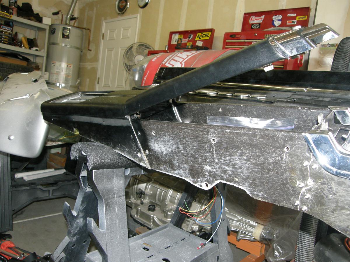

Speaking of trim, I got some put on, the booster/master, and working on the console. Gotta get some vinyl and carpet for the console, but no major mods to fit the new trans tunnel.

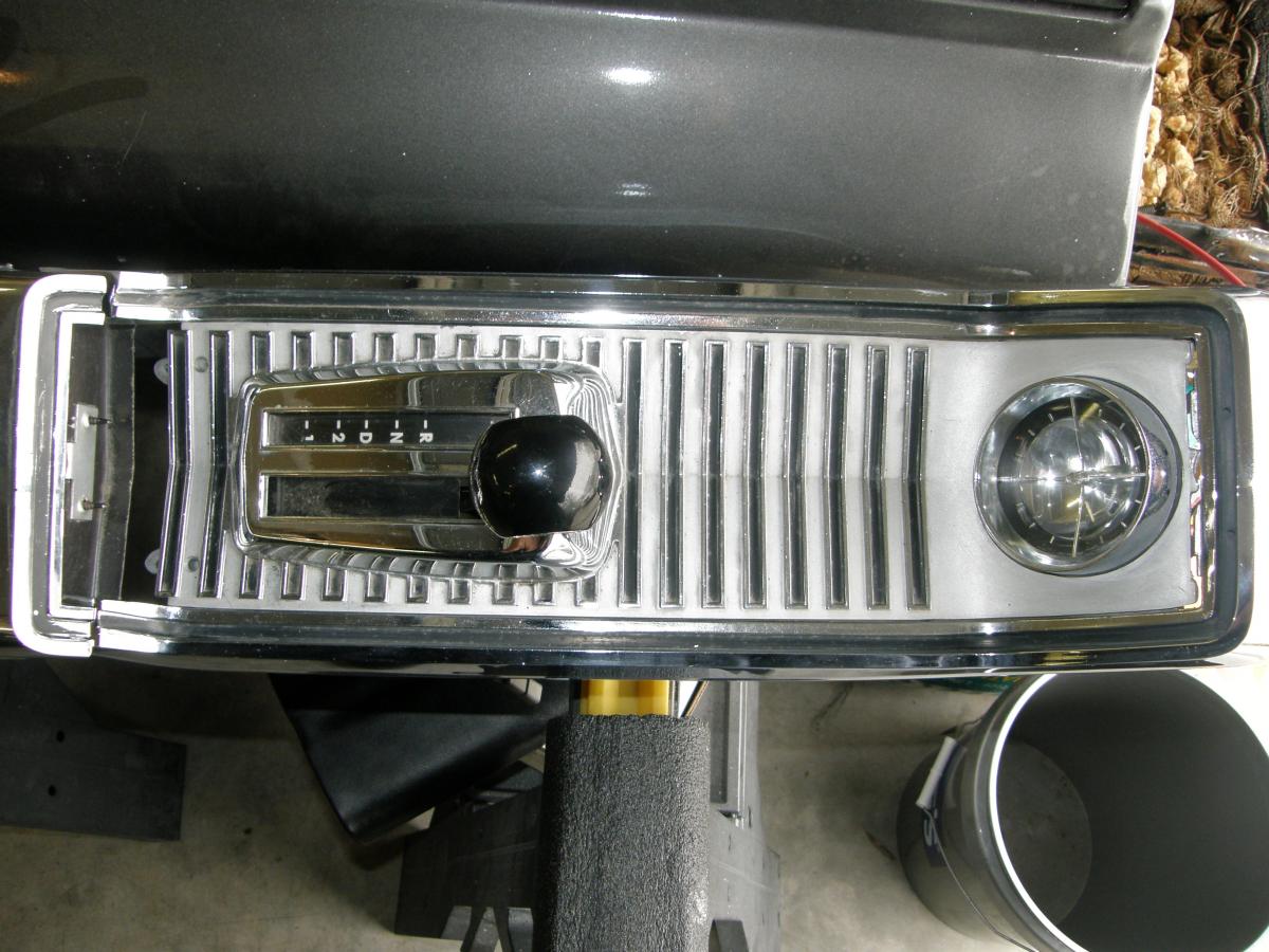

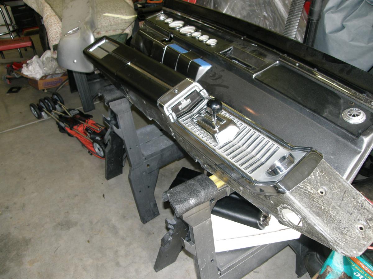

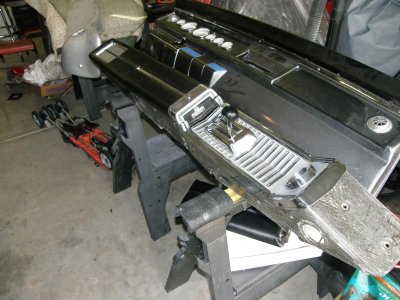

Got the body plugs in, center console redone...waiting on side carpet from legendary. I'll post some pics tommorrow.
Here is some eye candy. I apologize for the picture quality, my eye is still not 100%.

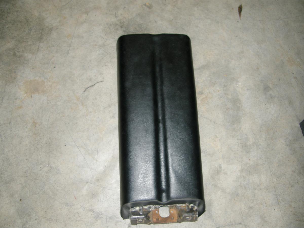

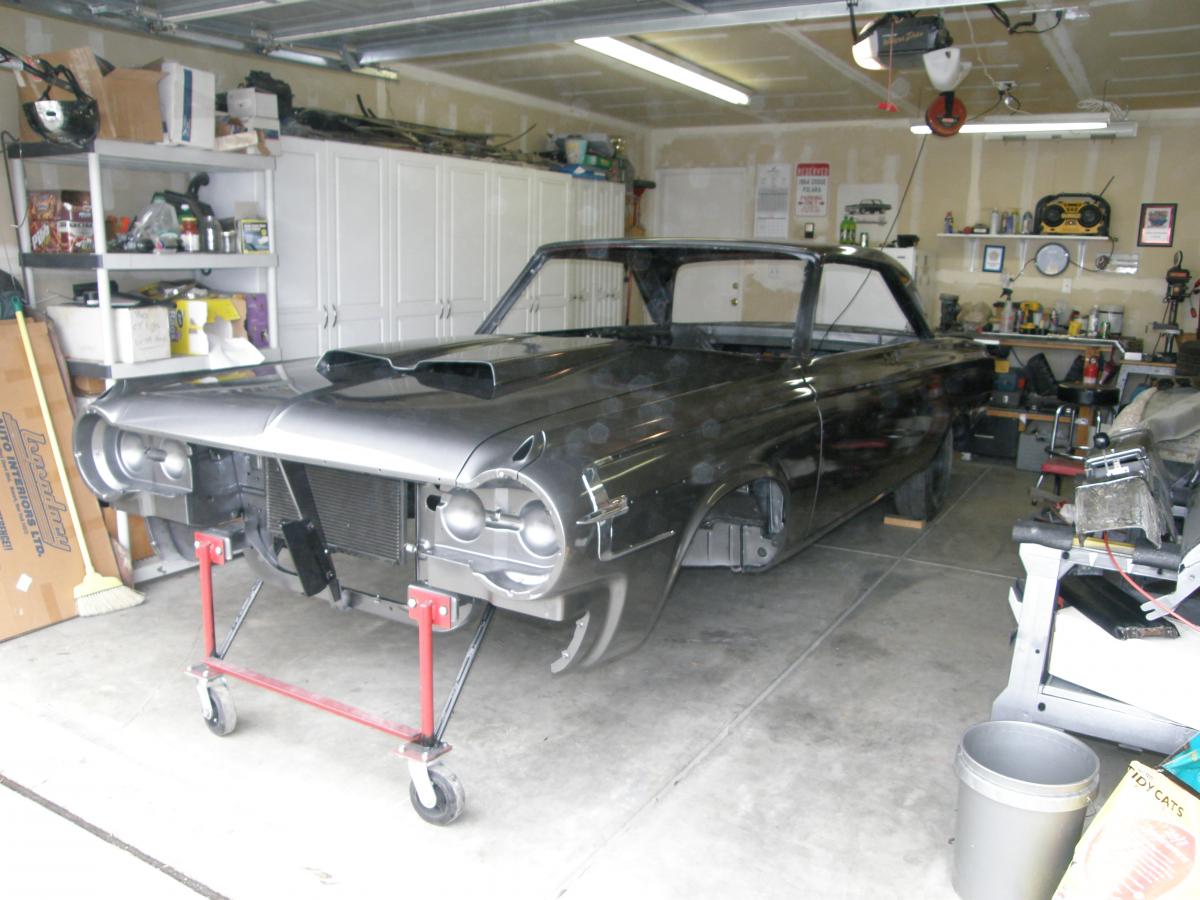

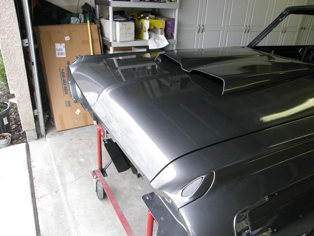

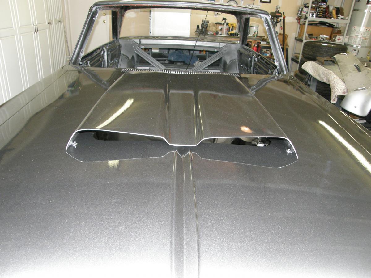

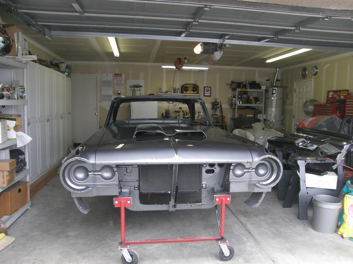

Thanks Rapid, you should see it in the sunlight, friggin' awesome!!

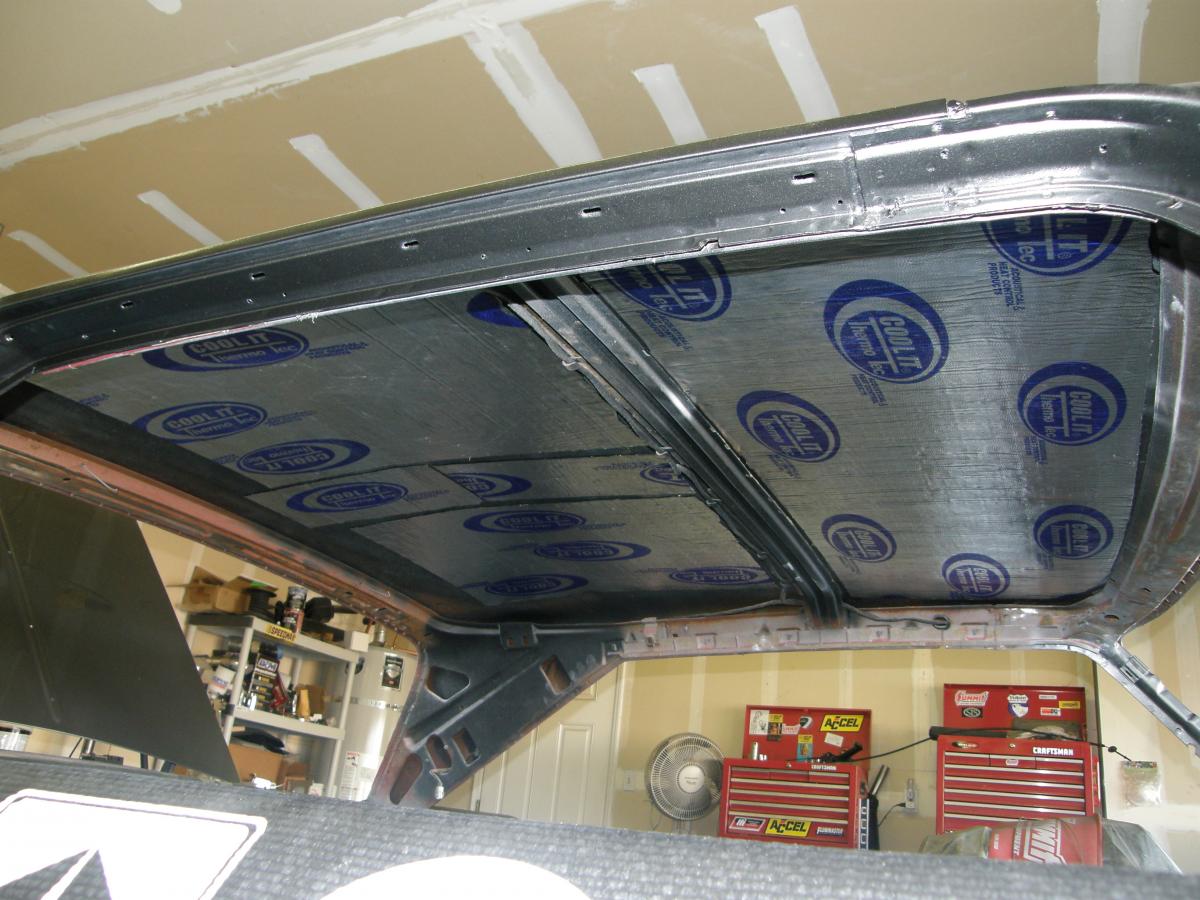

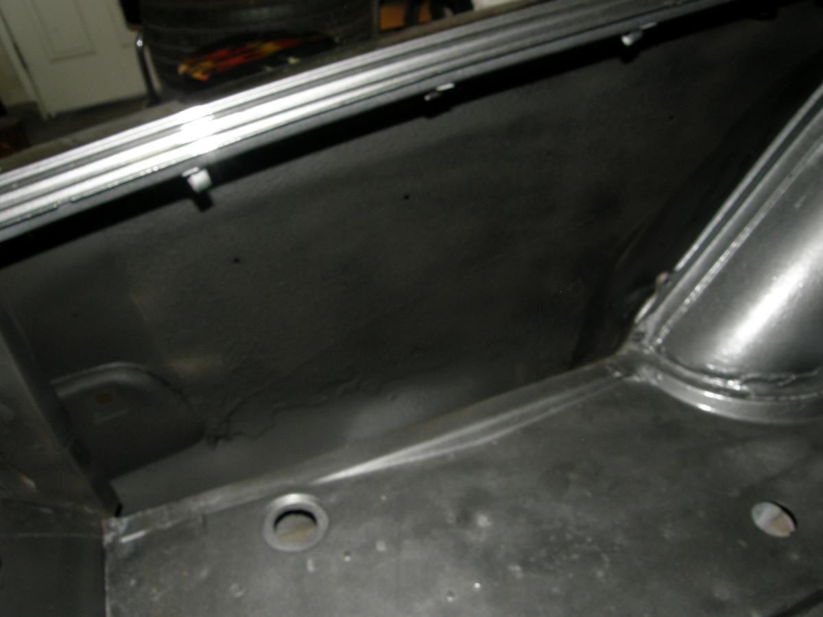

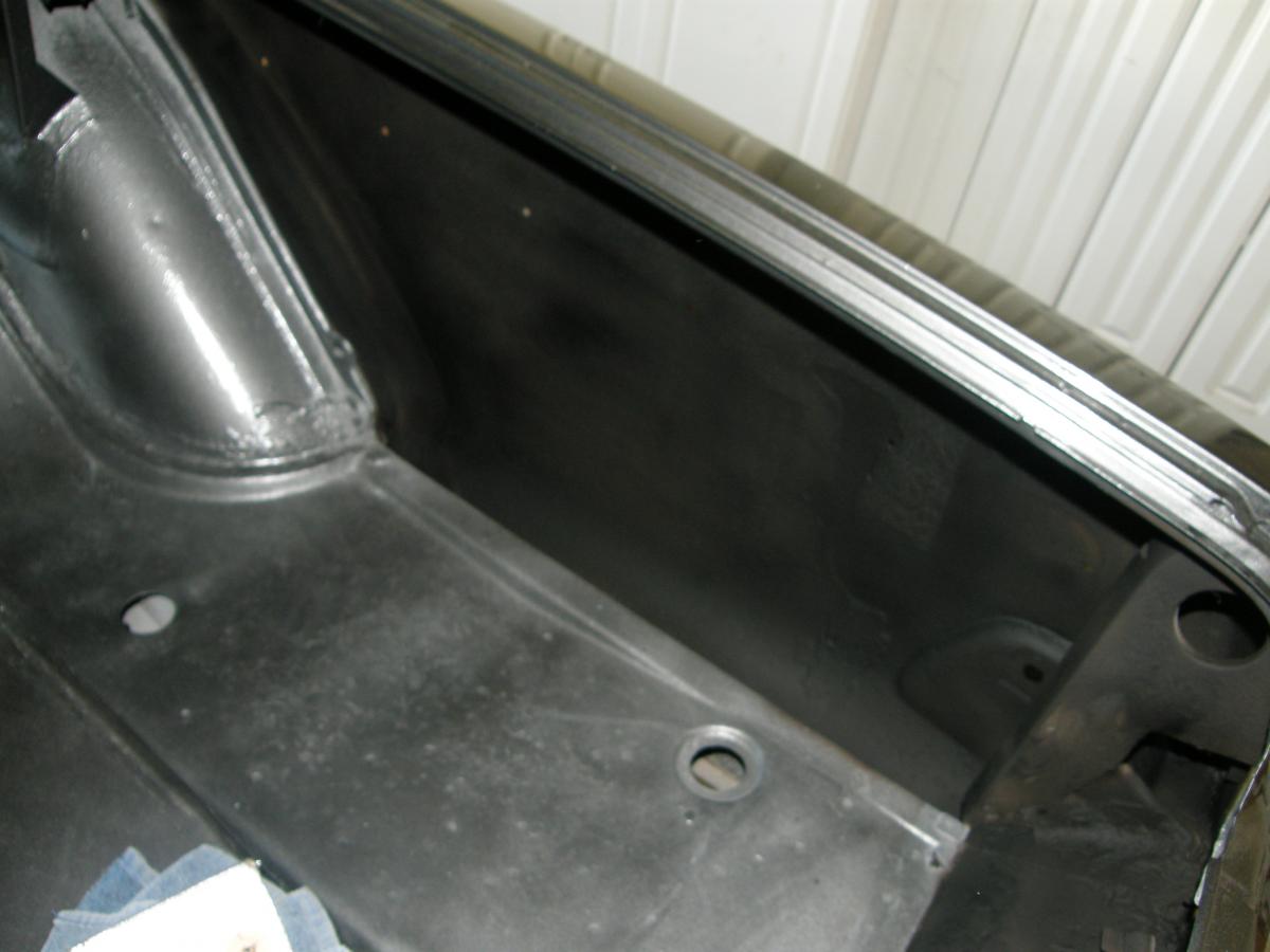

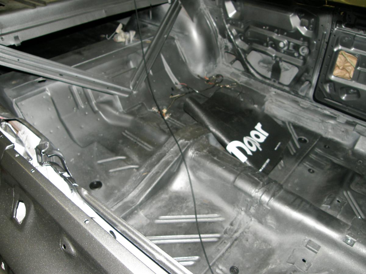

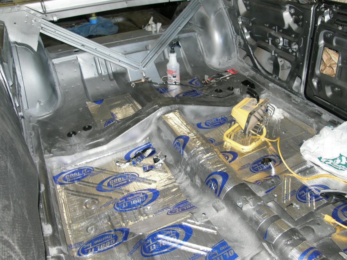

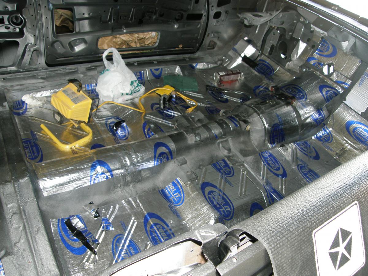

Got some heat/sound deadning on under the roof, should finish it tomorrow.
Got the undercoating on the inside of the rear quaters and finished the sound/heat deadning. I bought 3 rolls of the stuff, but it still wasn't enough to cover every square inch so this will be better than nothing. On a side note, this stuf does not want to stick when cold so I used my 500 watt floor light the heat up the sticky side, worked great.

Donny, I can't say this enough, but the color really pops in the sun.
furyOus, I had an extra arm rest, so I wanted to give it a try, not too shabby for my first time at upolhstery work.

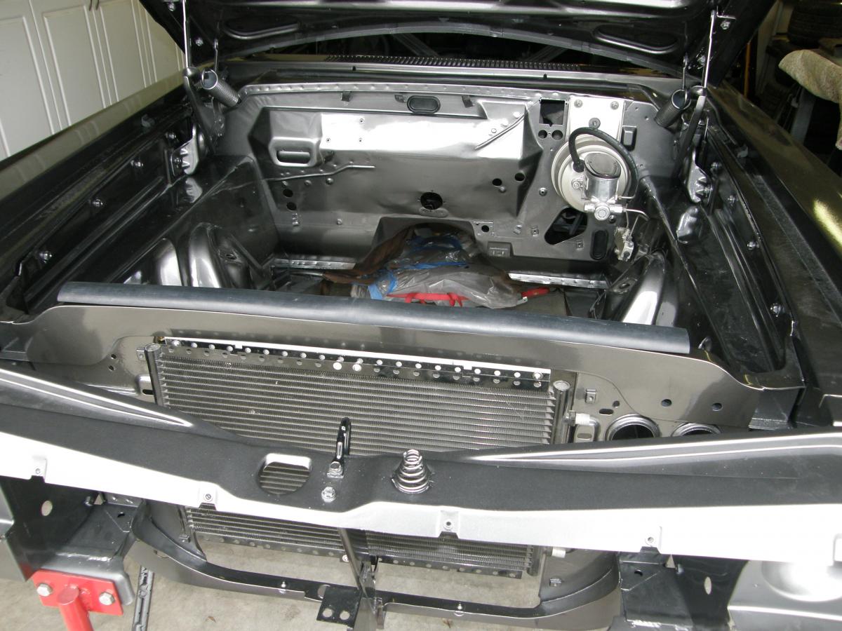

Forgot, wiper motor and vintage air unit all mounted up today. I gotta say with the new gaskets and seals the wiper pivots were a pain in the ***, but I was succesful.
In what way Zack ? I purchased mine a while ago but yet to install them.
Hey Joe, the fat black sponge type gaskets were a pain, the go over the wiper shaft then you need to stick the whole thing thru the bottom on the cowl and manipulate the sponge gasket to fit in the hole while push it up. Dish soap work fine, but I would have known that if I read the instructions first...you know typical guy thing to go in head first.lol!!
