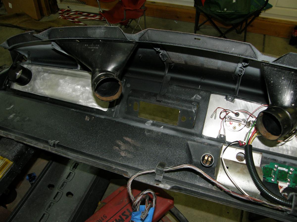

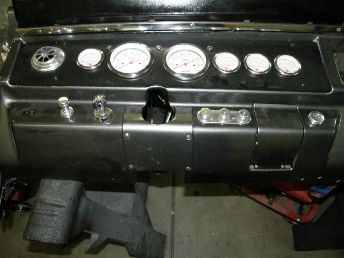

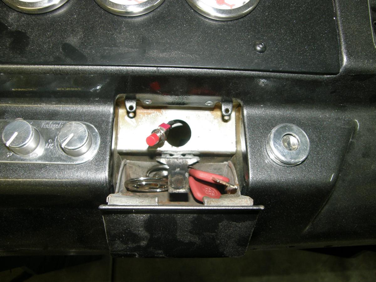

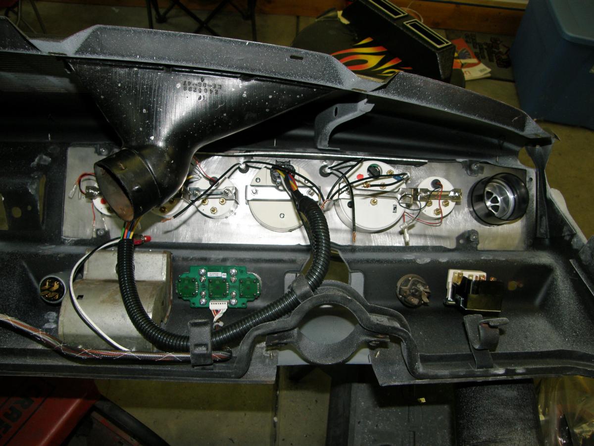

Screw this carpet, it wont conform to the pan no matter what I try...heat gun, threating to set it on fire, cutting in strategic spots, begging/pleading, cursing, nothing!!! So new carpet is in order and will go from there. On a lighter note, console carpet showed up, down side is Legendary saw fit to short the nose of the console by by 2-21/2 inches, so I'll call tomorrow and see what they want to do. New 1 piece stainless brake line showed up, I'll bend it and install after I get off the phone with Legendary. Dash is almost completely done and wired, some purist may not like it that I moved the ignition to the right of the ashtray, but I needed the space for the ac/heat knobs between thw column cover and ashtray, I post some pics in the morning.
The dash, just waiting to install it so I can finish wiring everything. Notice the NOS button? Just kidding, it's for the electric speedo and it does all kinds of neat stuff.

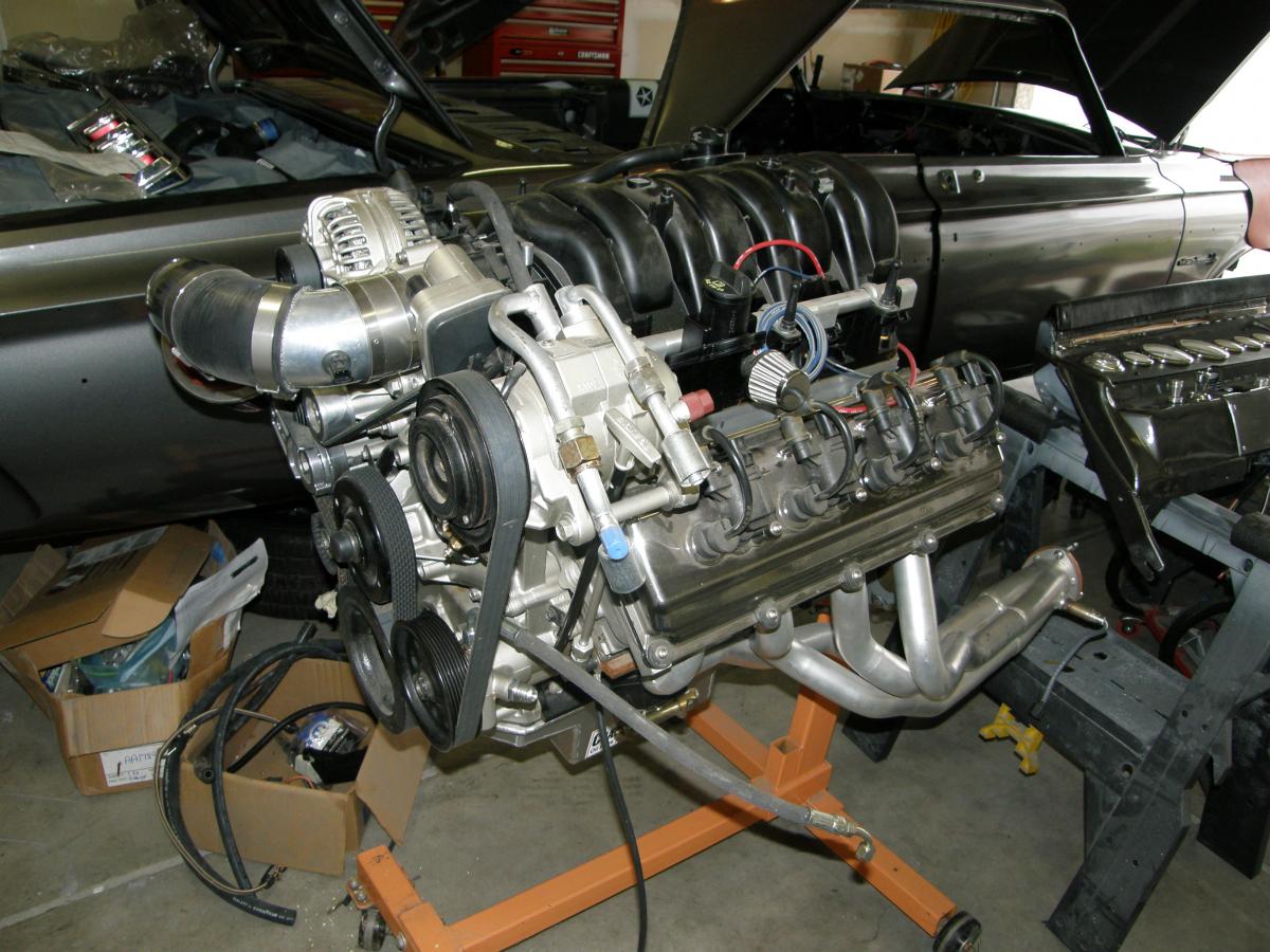

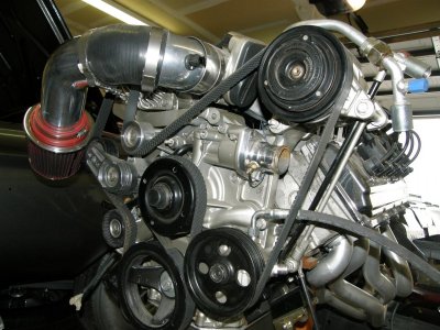

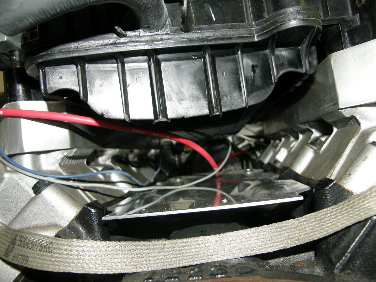

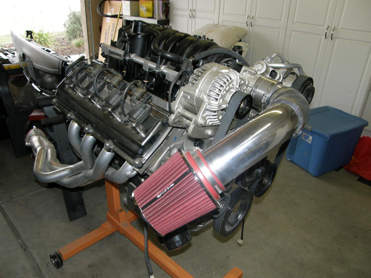

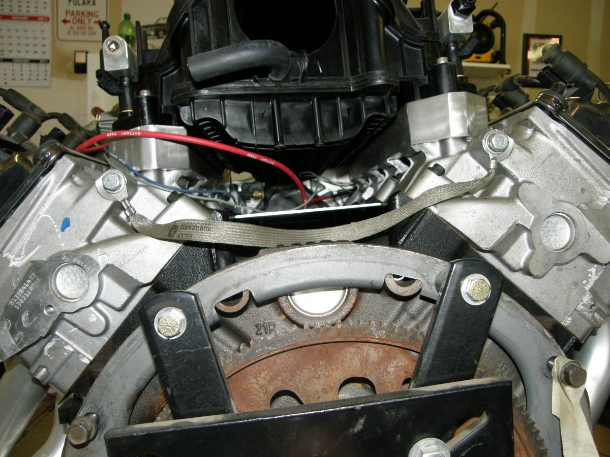

Heres some pics of the little elephant, paitently waiting to get stuffed in and make some noise. Oh, can you say air gap????

LOL, nice... You've got a small oven for some roadside cooking :)
Just toss a burrito in there and 2 minutes later your eating!!

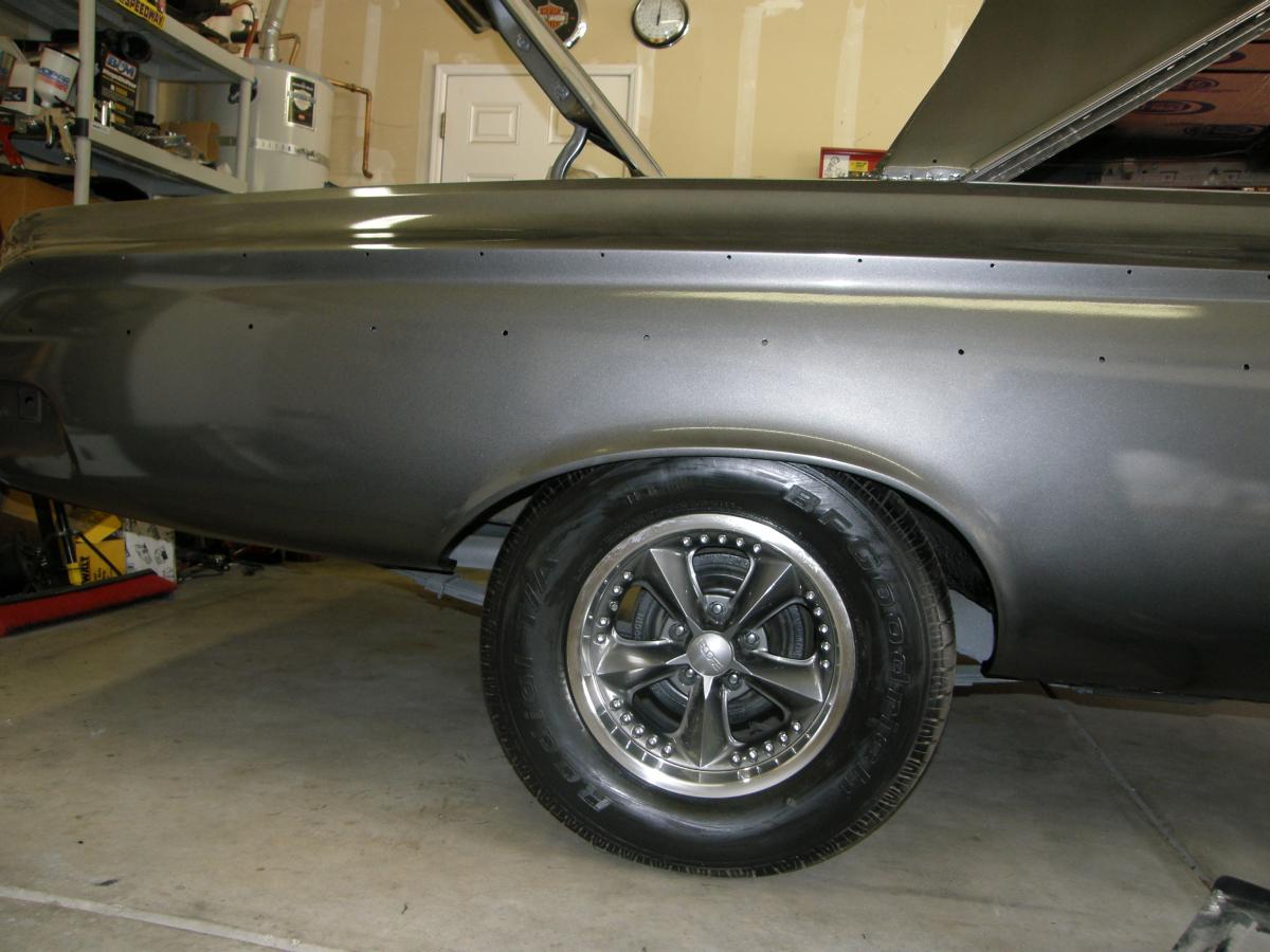

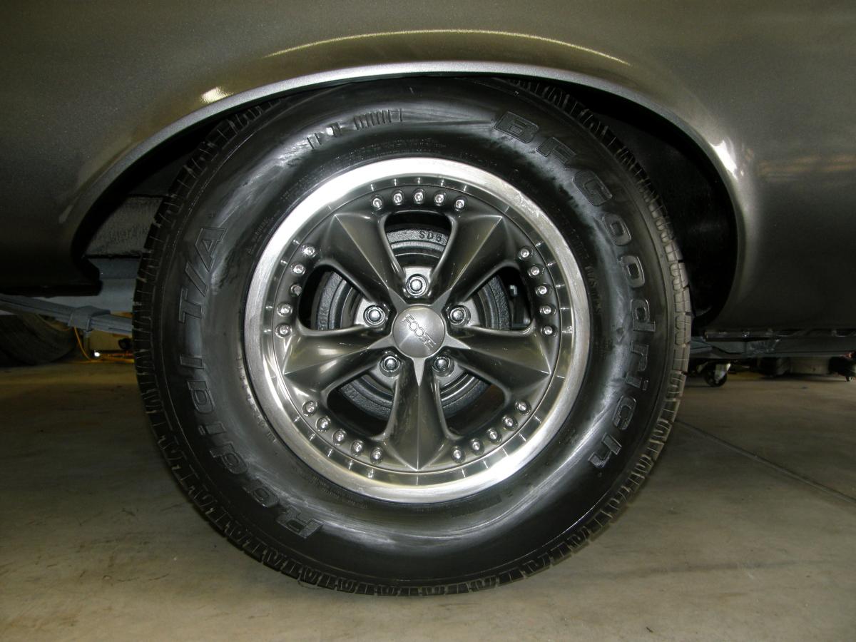

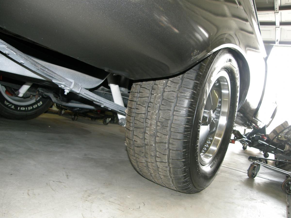

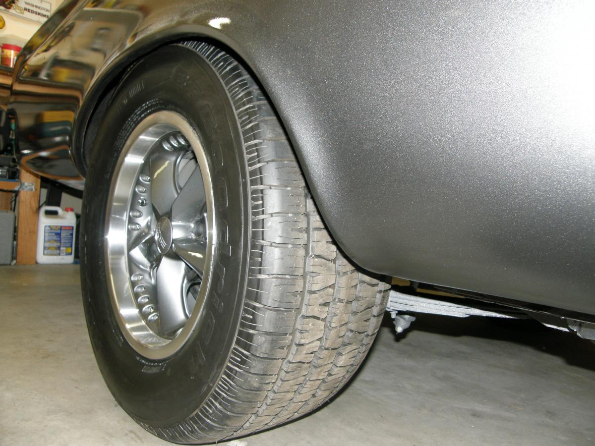

Could not resist putting on the rear tires....Those rimms match really well!!

your getting there motors looking nic and clean... how much clearance you got on those tires? will they rub?
It looks as though it would rub, but I can get my fingers in all the way to my palm. The size is 275/60/15 on a 15x8 rim with 4in backspace. If need be in the future I could throw them on the cnc and take 1/8 to a 1/4 to get more backspace. Got to drive it first to see.
