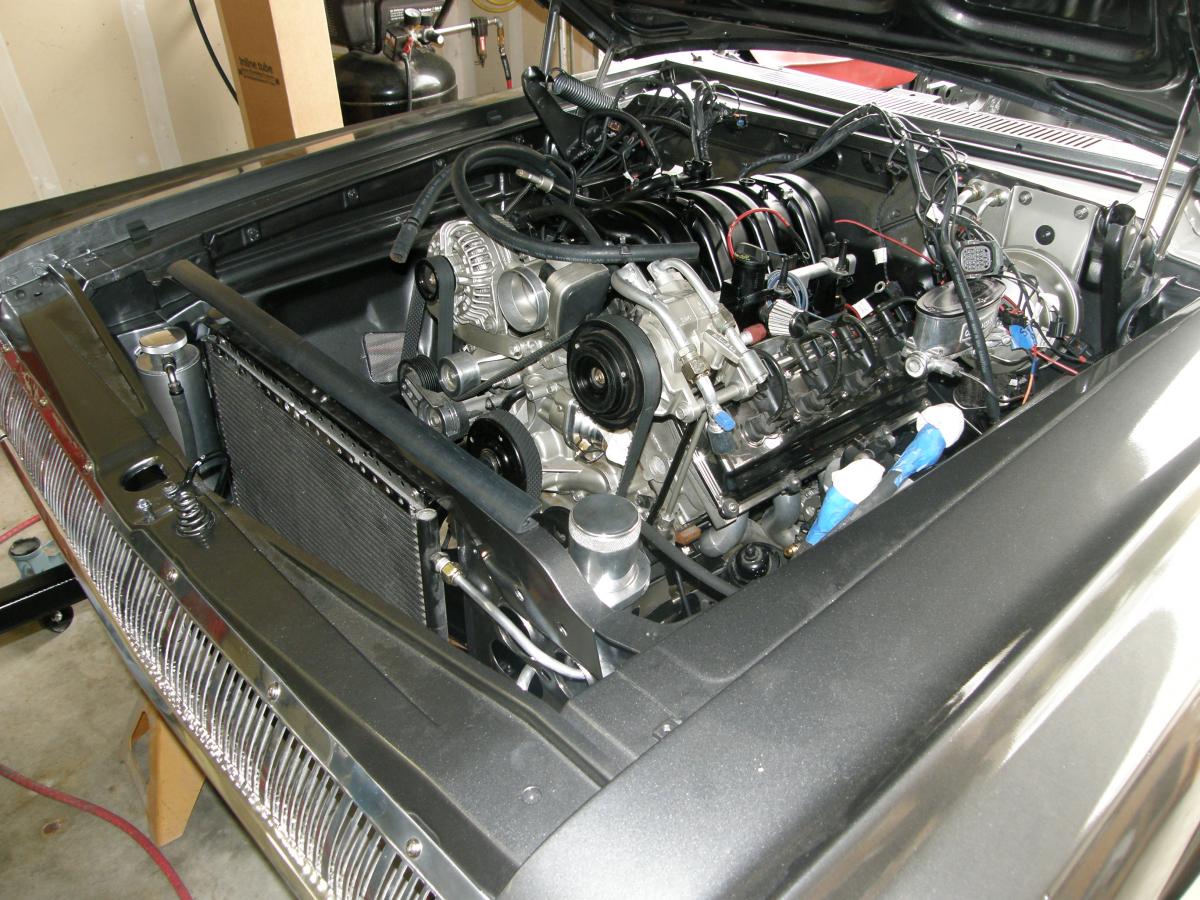

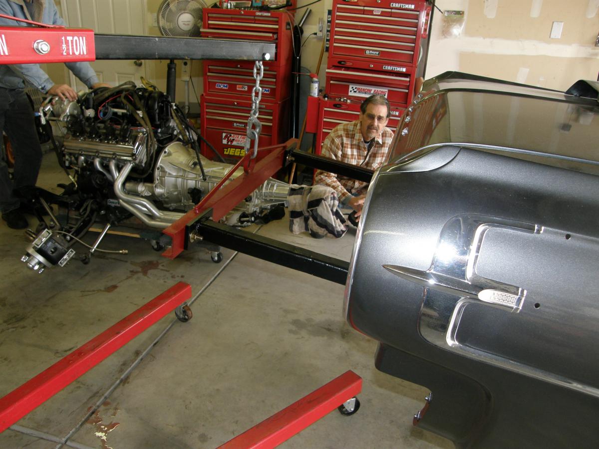

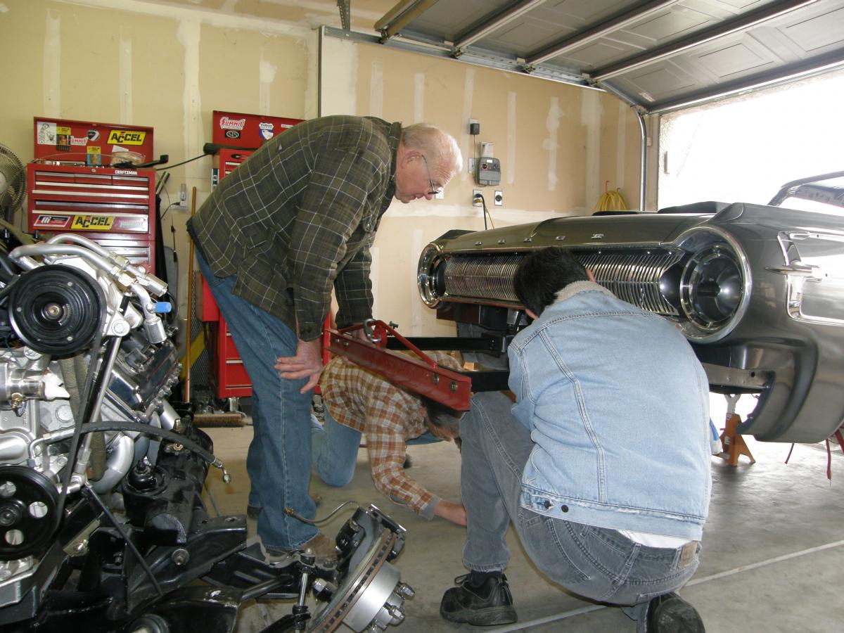

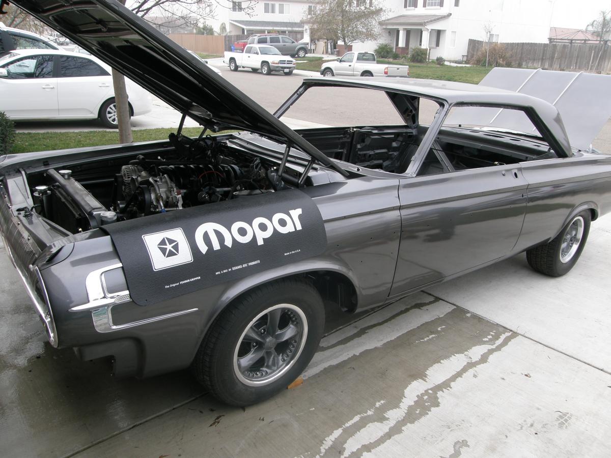

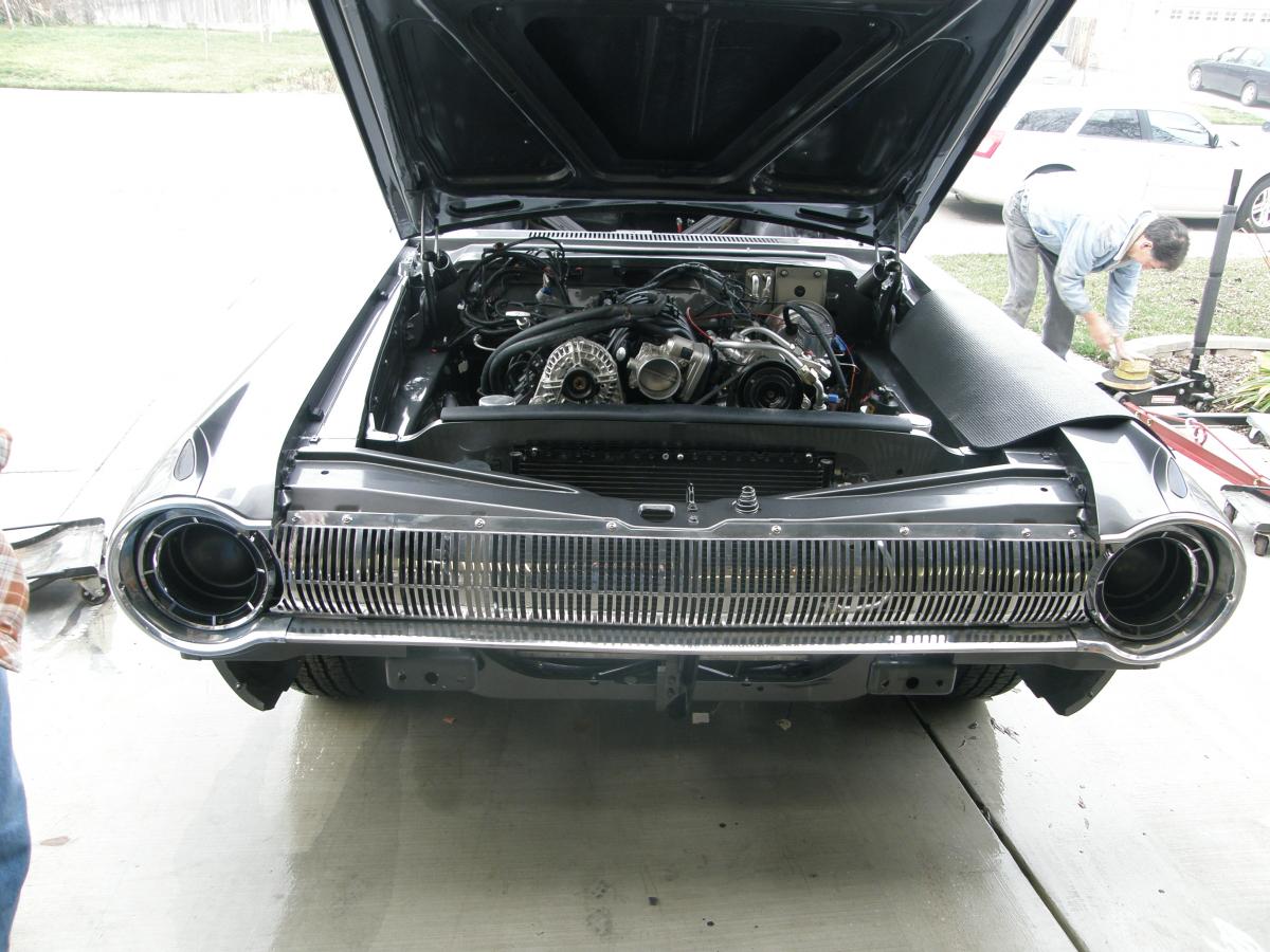

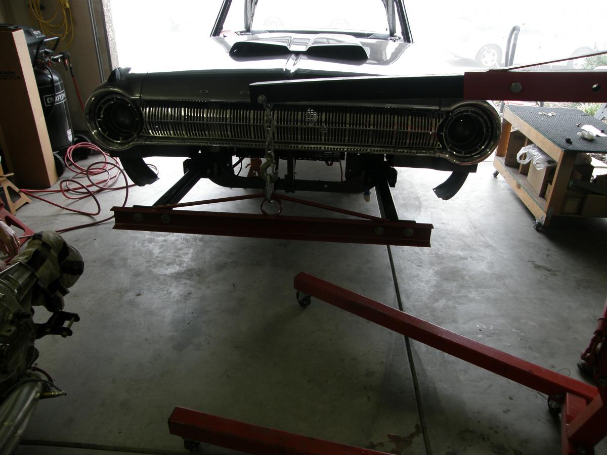

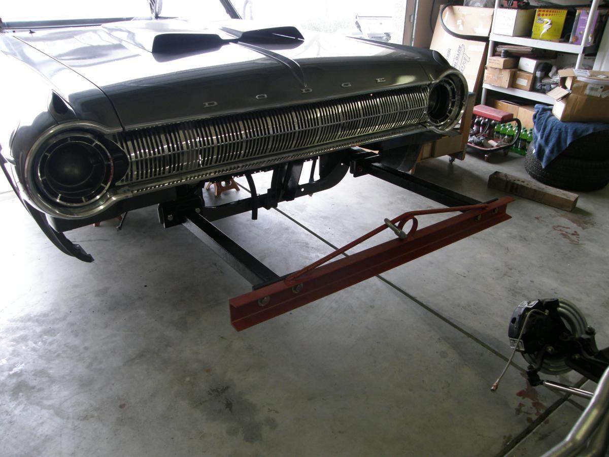

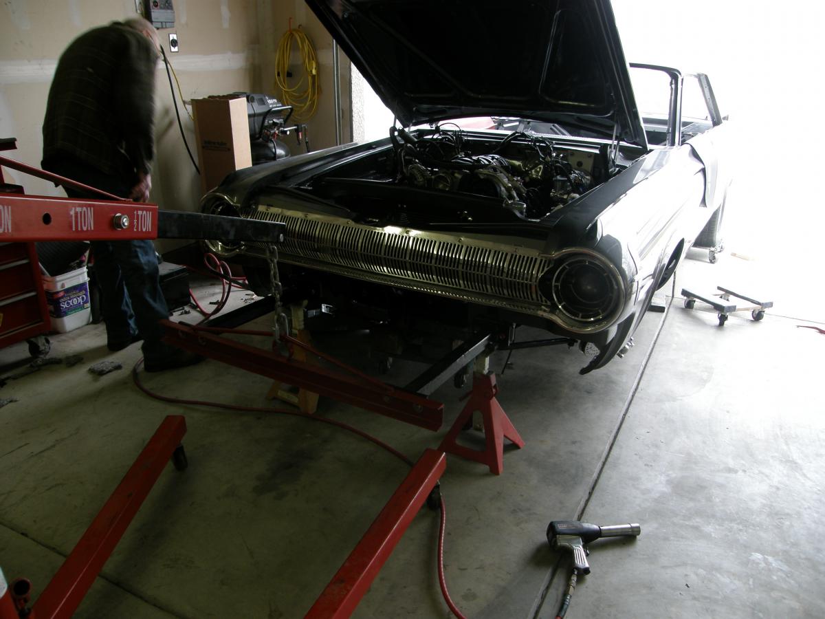

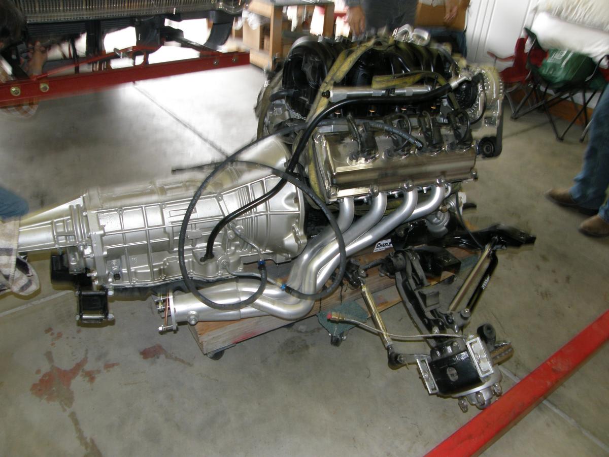

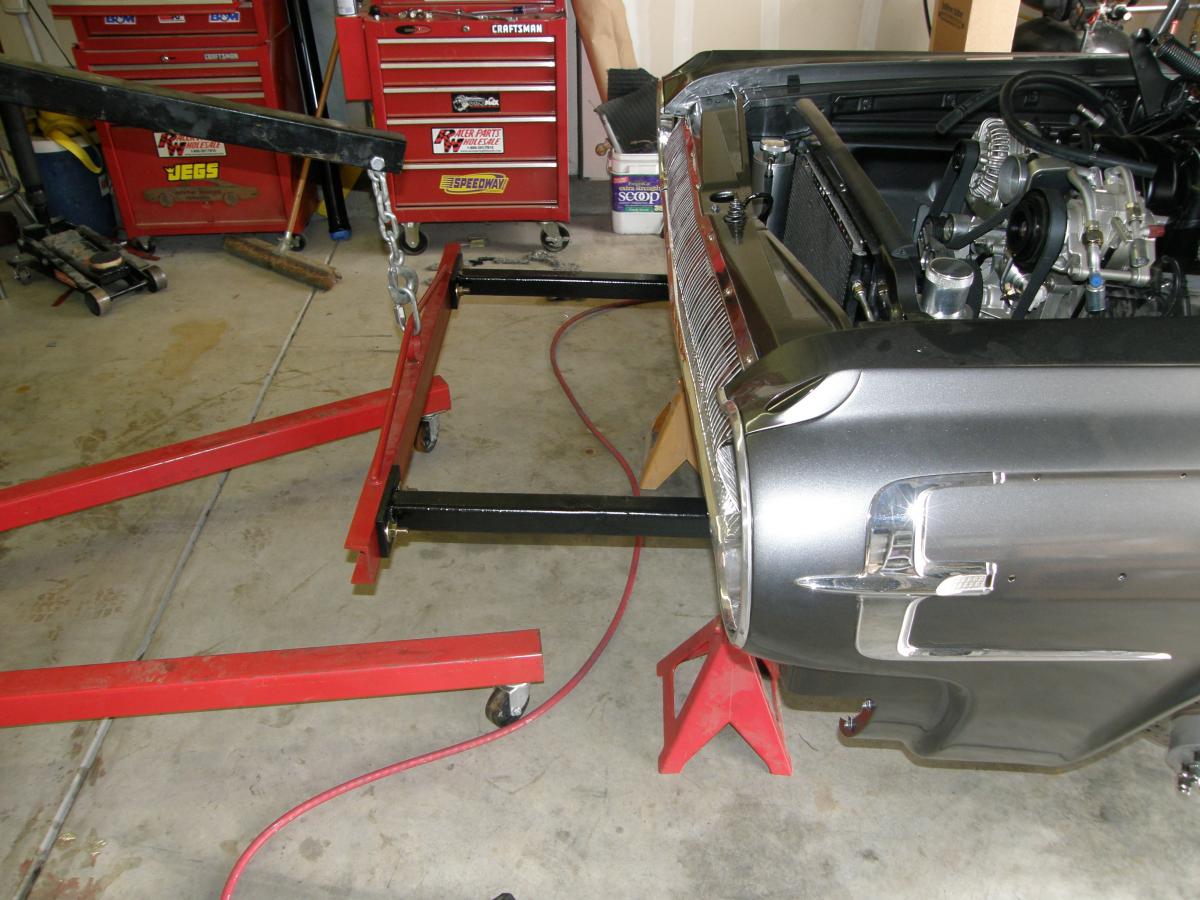

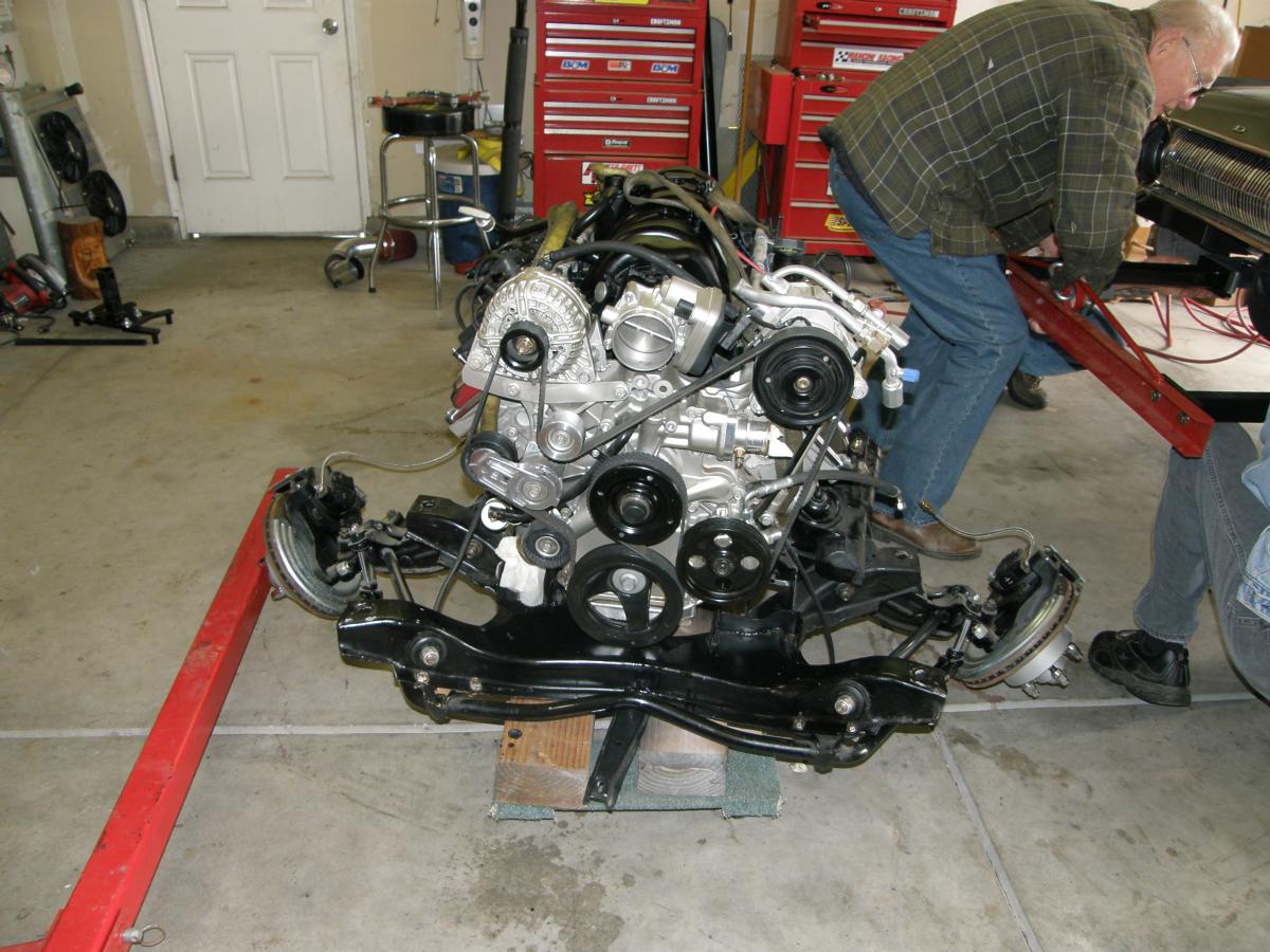

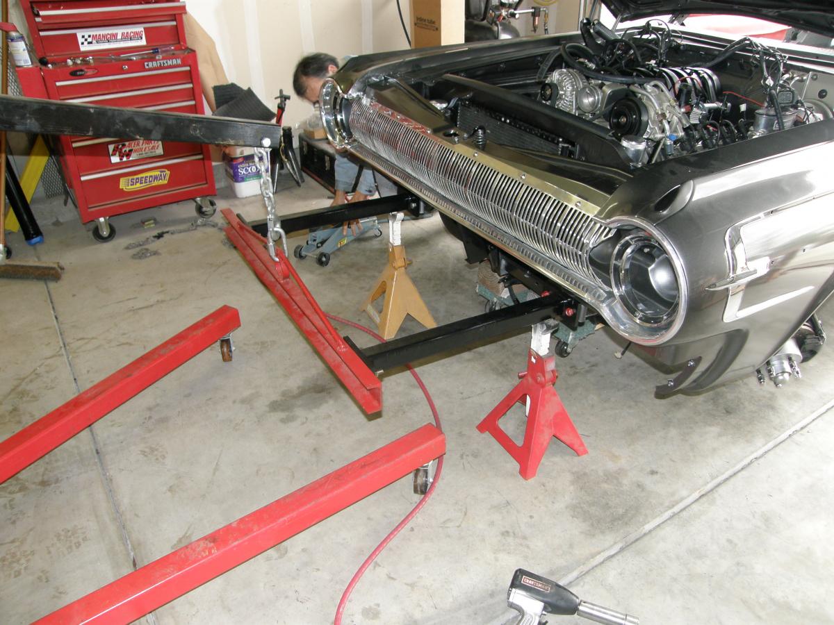

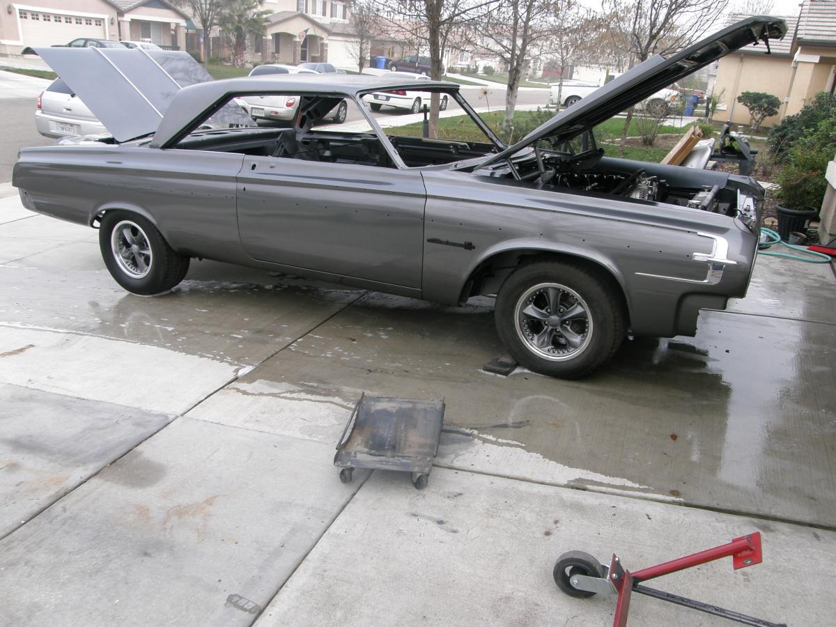

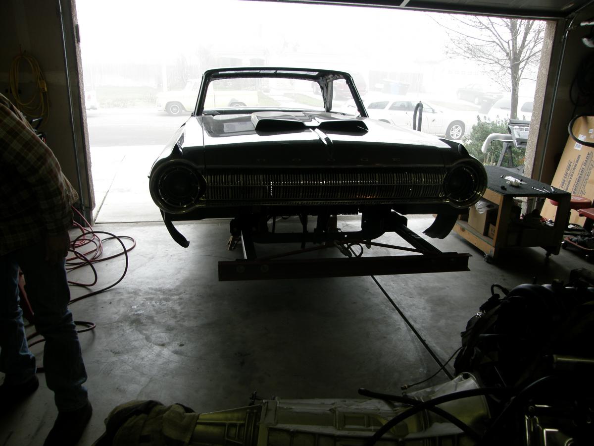

My dad and 2 buddys, Mike and Robert helped me get the engine/trans/front suspension in. We started at 10:30ish and they all left around 3:30. The lift I designed work perfect. With 3 guys watching for clearence and the other lowering the engine hoist it went in real easy. Although I forgot to tighten the cam lock bolts and they decided to "pop" when we pushed it backwards onto the driveway so I could clean the garage floor of some spilled steering fluid and trans fluid. No biggie, we just looked at one another and damn near at the same time said cam lock bolts! Well the fun is getting alittle more fun now cause I got to plug in all the wires and make it look pleasing to the eye. It was so damn foggy here, it lifted for a few hours and came back real strong in the afternoon, thats what you'll see in a few of the pics. Hope everyone enjoys the pics!!

Hey guys thanks for the compliments. Granted I do 99% of the work, I still wouldn't be at this stage if it weren't for some GREAT friends!!!! The guys in the phots above have done alot to help me, Mike-does all the machine work, such as pulleys, one off do-hickeys, and he's gonna help put the wiring in for all the lights cause I dont know squat about wiring a car. Robert-likes to help get dirty and put stuff together, but he draws the line at bodywork(that was all me). And then theres Dad, he helps when he can (got his own #s matching 70 Challenger he's doing). I ask alot of questions to these guys, and they each have thier own "specialty", and they always seem to come through. One last person who has sat by and watched....the better half. After it was put together Saturday afternoon, she said something I will never forget and made my years of working on this worth it....."that is BADASS"!! I was floored, stunned and my heart felt all warm and fuzzy. Enough with the touchy/feely stuff... No work today as I watched football and played with the kids. I'll get some stuff done tomorrow.
